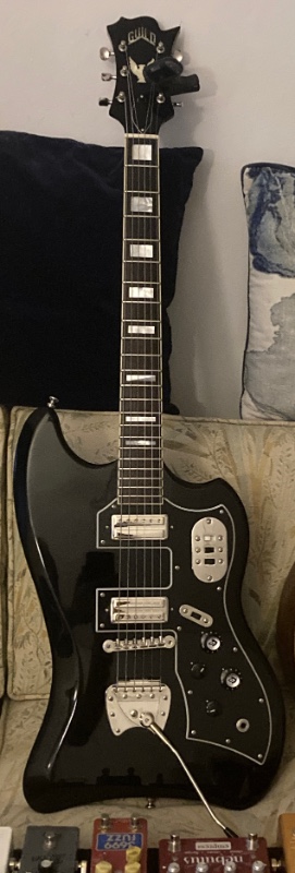

i finished leveling and polishing the frets on the T-Bird, and i'm pretty happy with the result. i can't say it's perfect, but everything's even and the straightedge shows no high spots. so i'll redo the G and B slots on the nut which needed filled and then after cleaning the masking tape crud off the fingerboard we'll see just what we've got here. i really ought to at least do the Kondor neck at some point, and will certainly have to do the frets on the baritone neck. i should do a primer coat on the Jetstar and then really should finish up the projects i'm hottest to have finished, those being the Gemini Telecaster, Supro with Bigsby pickups, and baritone Jazzmaster.
- dubkitty
- Posts: 14949
i got the Bird cleaned up and strung. it’s still not a shredder guitar, but the action is ~1 mm on the bass side which is a decided improvement and the neck is straighter than before. i’m declaring the Fret Job a success. now i just need to intonate it and i can move on to re-adjusting the pickups. am i happy? you bet.
