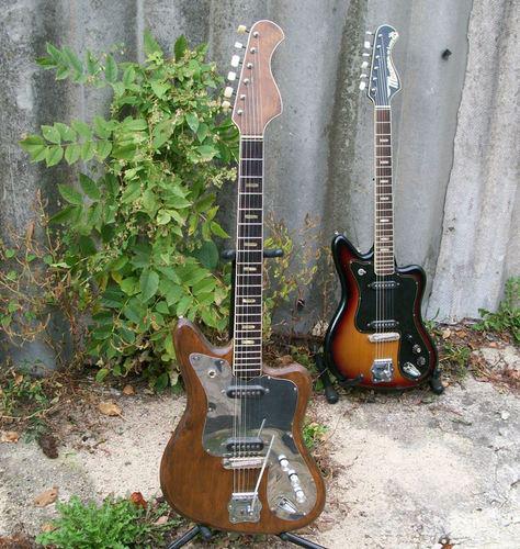

i thought some of y'all might enjoy following the progress of not one but TWO projects involving guitars from East and West Germany respectively. The first is the Musima Deluxe 25V which i bought from OndrakGuy in the b/s/t, and the other is a Hopf Twisty which i'm going to marry to an early Hondo neck.
so, to the Musima, which i've had for a few weeks now but only got into working with seriously in the last few days. you've seen the photo of it in original condition as it came from Lithuania, where it first appears on the internet.

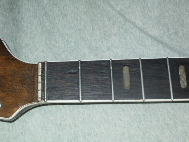

what isn't apparent in the photos is that the entire guitar appears to have been refinished after being stripped by some tovarisch with a wire brush and a rotary drill. this is particularly awful on the fretboard, where the chosen approach to getting rid of fretboard ruts was to scarify the surface as if it were the scourged body of Christ. seriously.
i eventually wound up having to go at the fingerboard with a file at first to get rid of scalloping between the frets, and then sanding with successive grits of sandpaper from 220 up to 1500. the results are pretty decent, i think:
after i finish the fingerboard, it's on to sanding the neck.

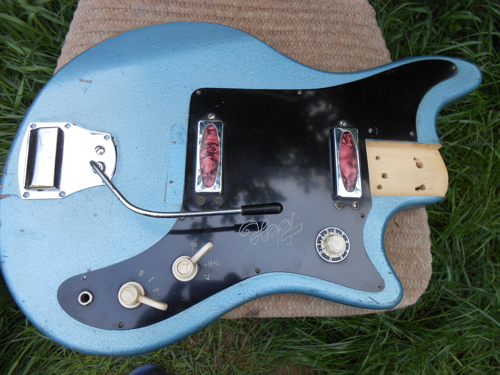

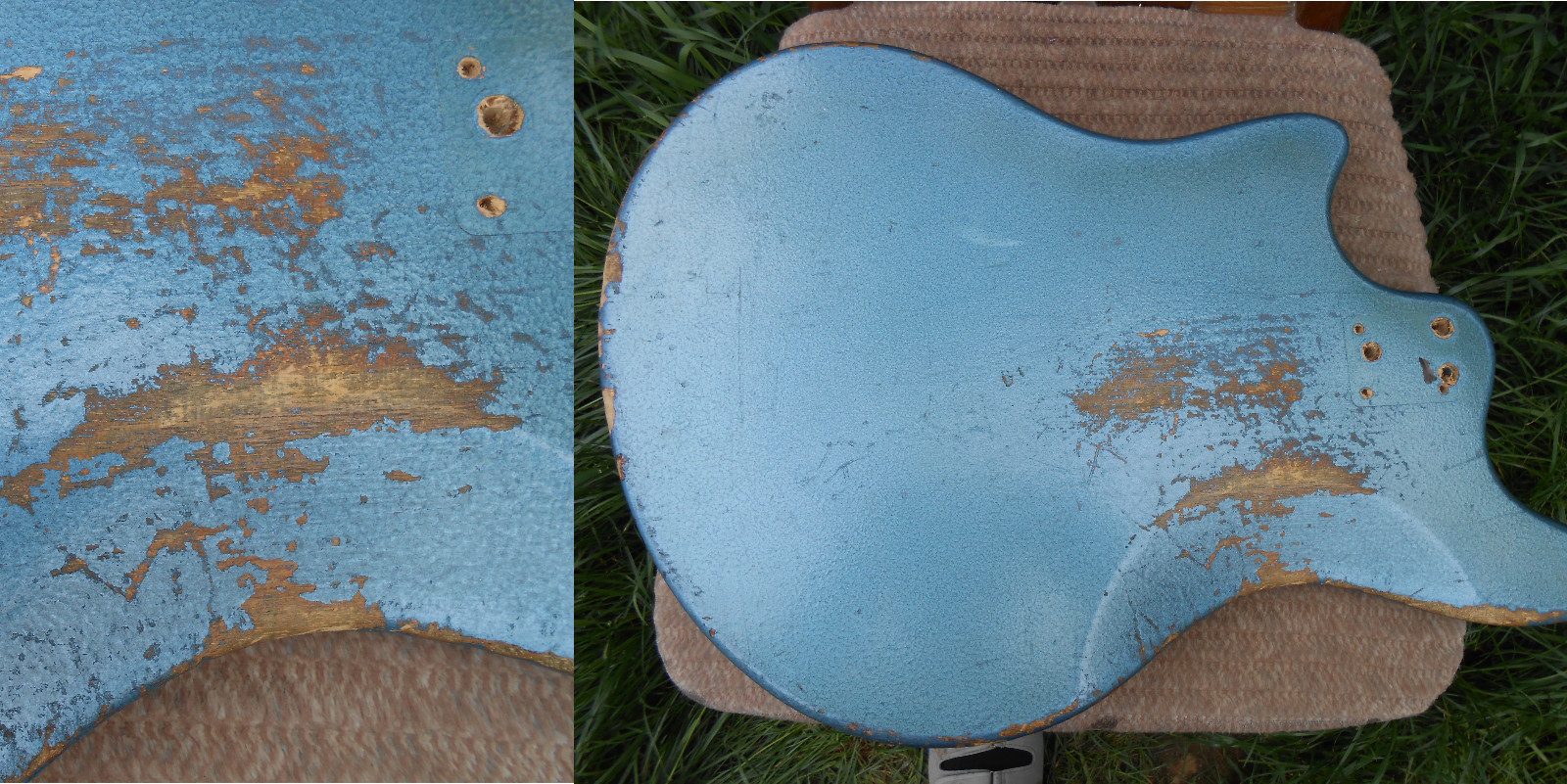

and then there's the Hopf. i stalked the Twisty body on eBay for over a week and got it for $125:
the finish on the back is kind of thrashed; i may overspray the back to keep the remaining original finish in place.

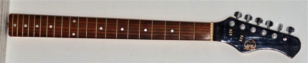

i found a Hondo neck from the 80s which is put together in 1mm maple laminates like the original Hopf necks, and a headstock that's close enough to the original if you squint.
these should simply bolt together and with the Teisco/Hagstrom type bridge that's coming, make one whole guitar for less than $250 shipping excluded. the neck was, like, $35.

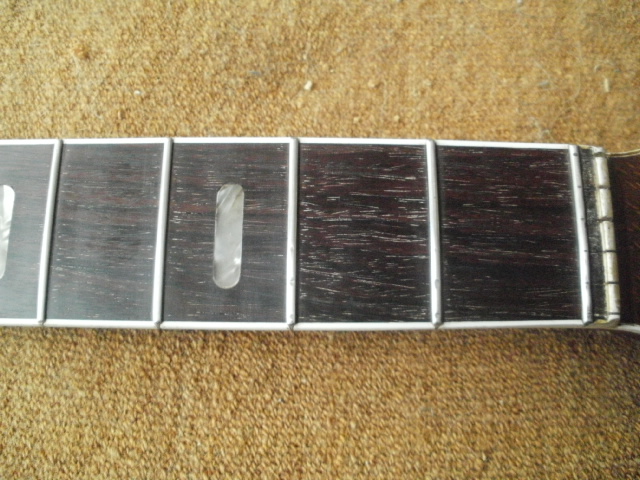

update: the fingerboard on the Musima is pretty much done. i'm probably going to work on it a little more to try to flatten out the scallopy/worn bits, but it's close to as good as it's likely to get. the first two frets--the actual frets, not the fingerboard--have some fairly serious cowboy dents, but i'm going to wait until i string it up and test it to see if i have to do something with them.

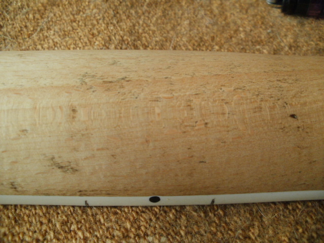

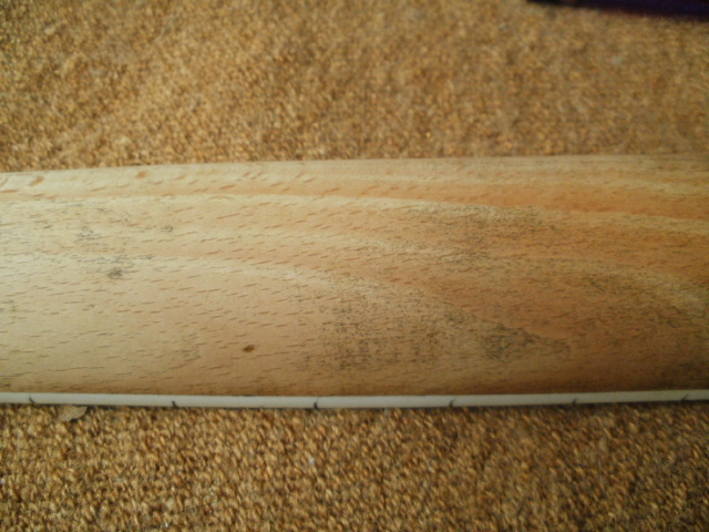

so i started sanding down the back of the neck, which as one expects with a European bolt-neck from this era, is maple with a little flame on one side. once i got through the refinish, which was a thin varnish of some type--i'm voting for furniture varnish, since it was really soft compared to violin varnish--came another insight into the production processes at Musima/Markneukirchen. after sanding with 220 there is still black paint from the original finish visible, having soaked straight into the grain. no expense spent on a coat of sealer here! apparently the Warsaw Pact approach was to shoot lacquer straight onto wood that had been sanded with 220 grit, or 400 at BEST, as prep. at least the Musima is free of the USSR production habit of shooting thick coats of lacquer as a substitute for binding or filing the fret ends.
so once i get the back of the neck sanded to my satisfaction, which may or may not include going far enough to get the original paint out of the grain since i don't want to get into recontouring the neck, i need to break out the sanding block and get the front and back faces perfectly flat. once that's done, i'll probably send the neck to my guy in South Carolina who's going to make the new headstock facing. i have to decide how to finish the neck...i'm not nuts about tung oil, don't know if i can polish/sand violin varnish, and don't live in a place where i can spray paint.

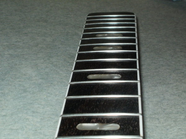

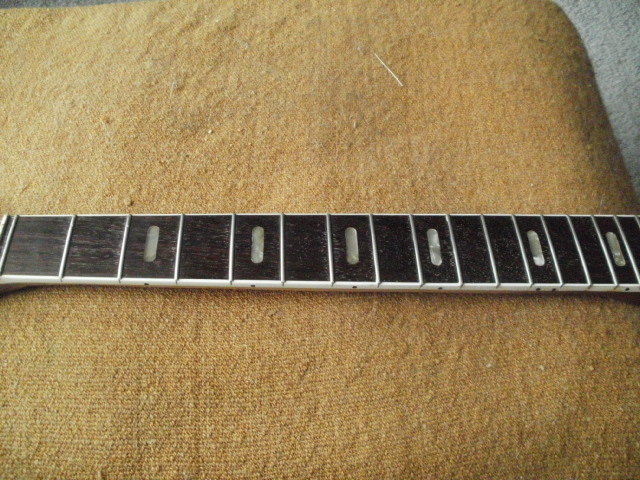

all righty, then. first, the fingerboard in its initial state of completion. some additional anal-retentive levelling may result, but not if i can avoid it. there's maple dust in the grain of the rosewood, which will wipe off.

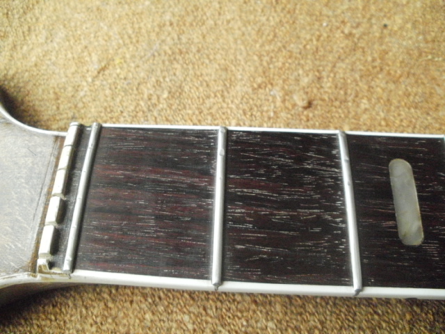

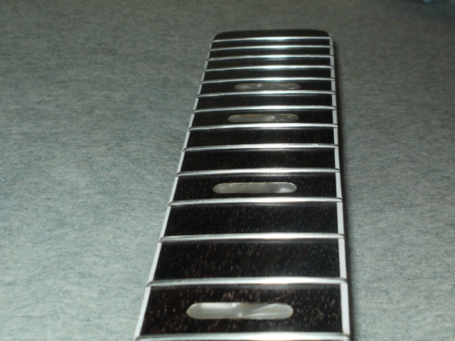

here you can see the cowboy dents in the first two frets. they're actually worse than they look here. i may do one of my ghetto fret-levelling jobs, which feature a sanding block and 800 grit sandpaper, but i don't want to fuck with it any more than necessary.

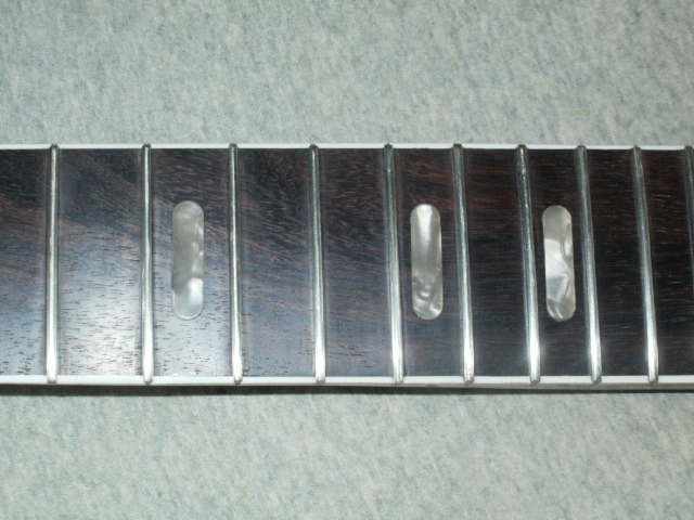

it's been difficult to get rid of the fingerboard ruts in the cowboy positions without a certain unevenness. i don't want to go farther down than i have because the frets could figuratively end up standing on hedgerows. n.b. the difference in slickness and hue between the first two frets and the rest of the board is because those spaces had just been completed.

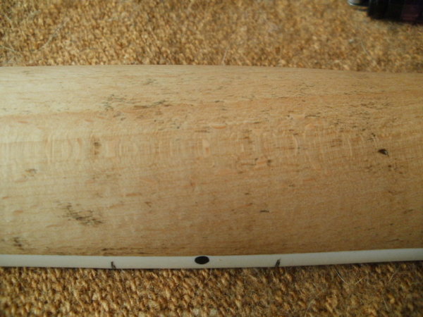

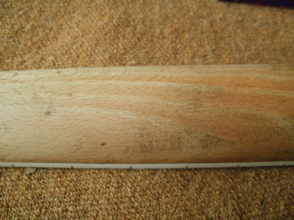

here you can see the original lacquer as it soaked into the grain of the maple of the neck. i'm not going to keep sanding JUST to get it out since i plan on a dark finish, but i do need to fix up the contour on the back of the neck and this might eliminate most of the soaked-in color you see here. this was after preliminary sanding just to get through the old finish and see the condition of the wood under the wire-whisk gouges (yes, he used it EVERYWHERE). after contouring there are still speckles here and there.

kind of looks like bread mold, doesn't it?

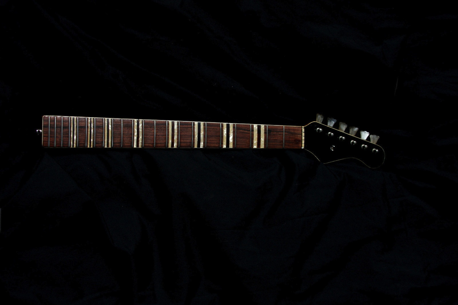

i made a Monday eBay lightning strike and got a 64 Hofner Galaxie neck for $150. major score given that the tuners go for $30-$60 EACH. this, of course, will go on the Hopf body. it's on now, bitchez
- kbit
- Posts: 11509
- Location: Philadelphia
Re: Dub's Wacky German Project Guitars Thread
Those inlays are neeeeat.
- dubkitty
- Posts: 14854
yeah, i love the striped inlays a lot

Hopf body is here. seven days to deliver from Budapest to Chicago. i'm impressed. pix and spielage after i take a shower.
