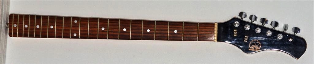

i found a Hondo neck from the 80s which is put together in 1mm maple laminates like the original Hopf necks, and a headstock that's close enough to the original if you squint.
these should simply bolt together and with the Teisco/Hagstrom type bridge that's coming, make one whole guitar for less than $250 shipping excluded. the neck was, like, $35.

meanwhile, the neck and bridge for the Hopf arrived. i don't know for sure if the Hondo neck is going to work...i had to estimate based on the Hondo's claim to Strat scale and the Hopf spec of 25.25". the bridge--a a simple Hagstrom/Teisco bar with a two-screw mount--is easily moved, so God willing it'll line up. the neck needs some attention--there are some sharp fret ends and crookedly-mounted dots in the fretboard that have to be fixed--but i'm letting it sit on the back burner until the Hopf body arrives, which could be any time from Wednesday to a week thereafter.

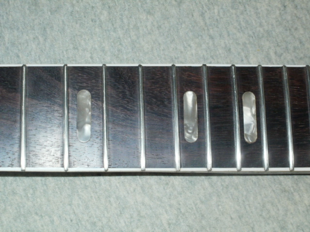

all righty, then. first, the fingerboard in its initial state of completion. some additional anal-retentive levelling may result, but not if i can avoid it. there's maple dust in the grain of the rosewood, which will wipe off.

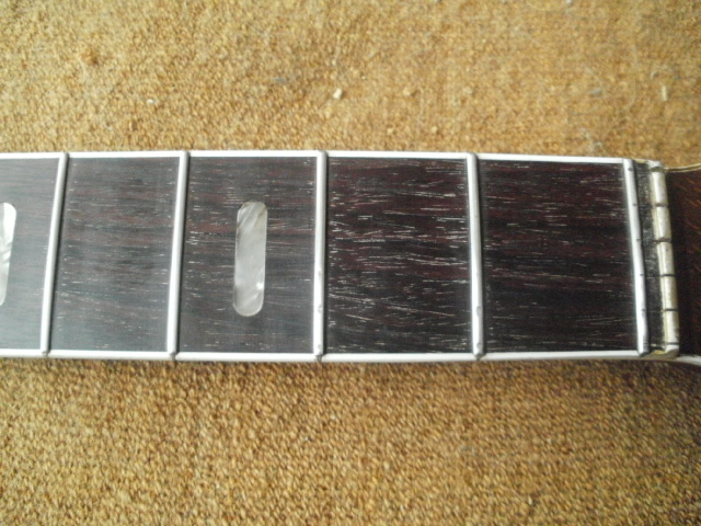

here you can see the cowboy dents in the first two frets. they're actually worse than they look here. i may do one of my ghetto fret-levelling jobs, which feature a sanding block and 800 grit sandpaper, but i don't want to fuck with it any more than necessary.

it's been difficult to get rid of the fingerboard ruts in the cowboy positions without a certain unevenness. i don't want to go farther down than i have because the frets could figuratively end up standing on hedgerows. n.b. the difference in slickness and hue between the first two frets and the rest of the board is because those spaces had just been completed.

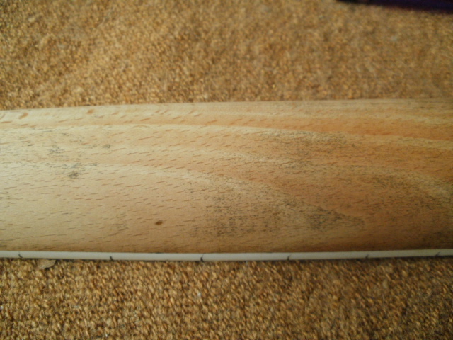

here you can see the original lacquer as it soaked into the grain of the maple of the neck. i'm not going to keep sanding JUST to get it out since i plan on a dark finish, but i do need to fix up the contour on the back of the neck and this might eliminate most of the soaked-in color you see here. this was after preliminary sanding just to get through the old finish and see the condition of the wood under the wire-whisk gouges (yes, he used it EVERYWHERE). after contouring there are still speckles here and there.

kind of looks like bread mold, doesn't it?

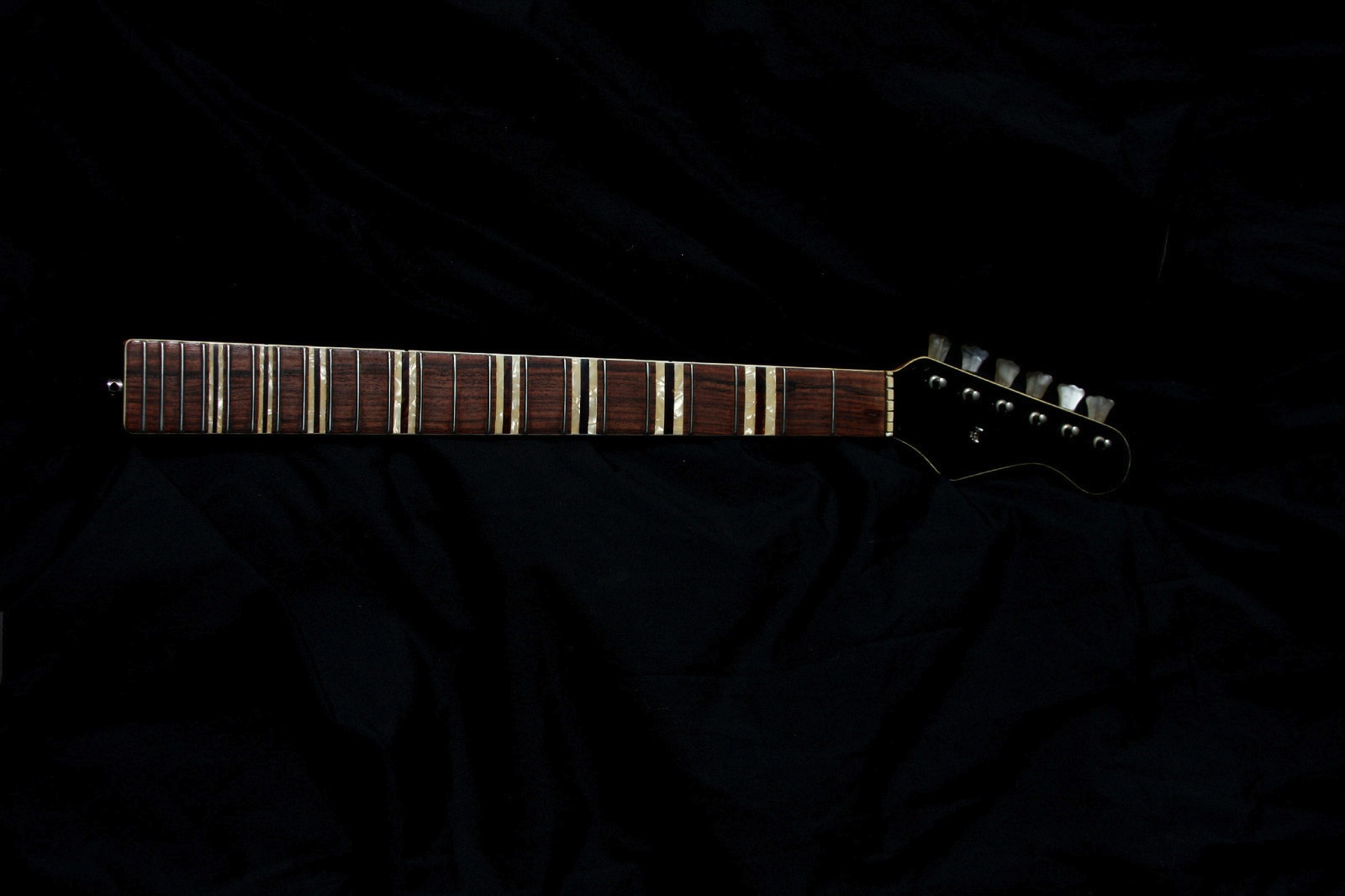

i made a Monday eBay lightning strike and got a 64 Hofner Galaxie neck for $150. major score given that the tuners go for $30-$60 EACH. this, of course, will go on the Hopf body. it's on now, bitchez :!!!:

Re: Dub's Wacky German Project Guitars Thread
Those inlays are neeeeat.
Posts: 14854
yeah, i love the striped inlays a lot :)
