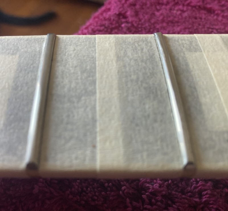

i have what i need to do the frets on the T-Bird and decided to move ahead with it. i've taped off the fingerboard--trimming masking tape that's too wide to work on the top 5 or 6 frets is a huge butt-pain!--and "blued" the frets, actually using a black marker. turns out i cut the first fret too low trying to fix it which you also can see in the photo, so i'm going to take everything else down to that level and then crown the frets. i really don't mind, though, because the stock frets are what i'd call "tall jumbo" and i don't really care for frets that tall. IMO they exascerbate the problem of strings going slightly off-pitch if you squeeze the string too hard.
here you can see the difference between the partially fixed first fret on the left and the 2d fret as an example of the previous job on the right. i'll polish the crowned frets so they're more even that the 1st fret, but you can see the difference from the partial redo...it's like, rounder and shit. those microabrasive sheets from StewMac are going to be some of my new best friends. i don't plan to polish them so much you could floss your teeth in your reflection, but they'll probably be smoother than most of the new guitars i've bought.

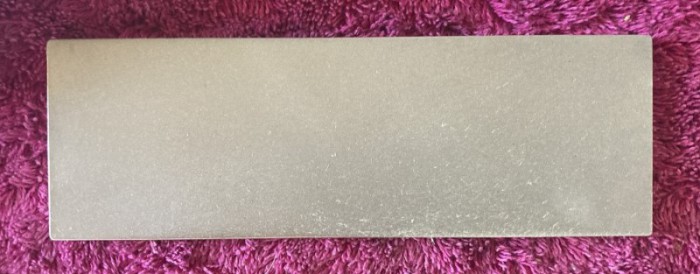

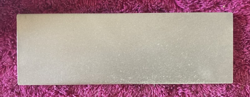

the file/block/whatever you call it from StewMac is pretty impressive. it's heavy solid steel with embedded diamond cutters, and from the third-party suppliers' packaging it can double as a sharpener for my chisels a couple of which could really use some help. this is the mid-size grit of the three available, equivalent to 600-grit sandpaper which is what i used on the sanding block. i'll introduce the other tools as i go along.
