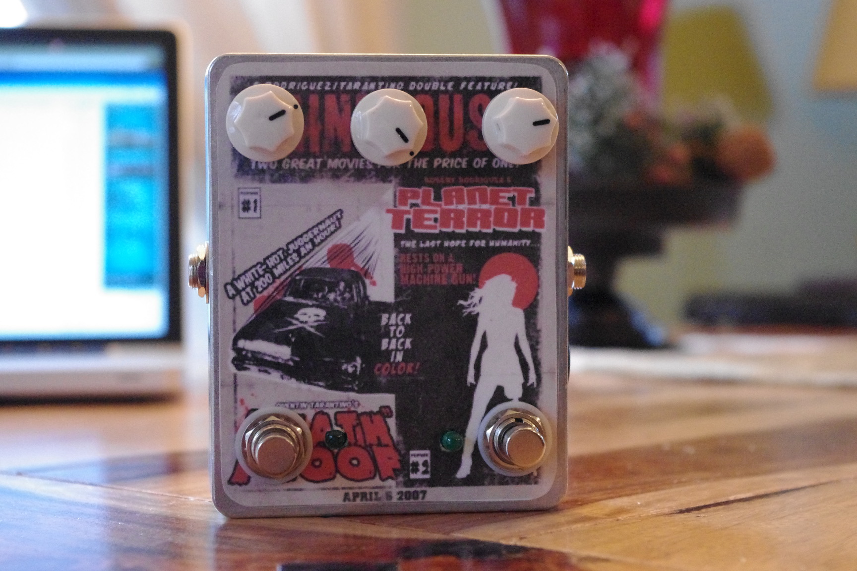

My kit has arrive and couldn't resist to built it right away so here it is...

I love death proof. its so fucking pointless and yet it is full of action and a great vintage style.

Sweet enclosure!
