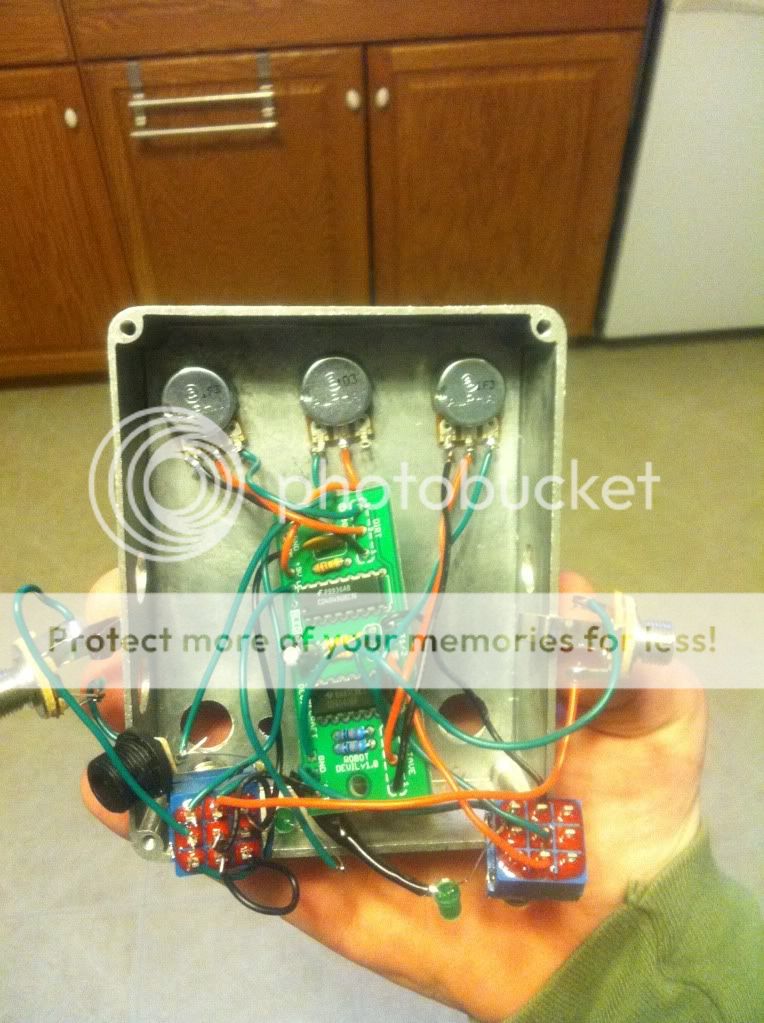

Re: Robot Devil DIY thread!!
I got my kit this week and put it together right away. It was my first build, but I had bought the TGD kit and watched my engineering friend put it together.
As with the others, I was short a 2.2k resistor, but I figured this would just keep that LED for working.
When I fired it up the first time, it worked! I was super excited and very proud of myself, and this thing is cool.
I tried it once more, and it worked fine, but the next day, I opened the box to show the aforementioned engineering friend, and then when I closed it up and powered it on to show him, to my surprise, I could only get a small amount of overdrive out of it, but no octave effect. Also, the starve knob no longer starved the circuit, but was operating almost like a tone knob, when I turned it down, I lost all my high end, but it wasn't doing anything else.
Not sure what I did wrong here, or why it would work, but then stop working. Could this be because of the missing resistor for the LED?
Any ideas would be appreciated, as I admittedly don't know what I'm doing here.
I should have included that originally! Sorry.
This is the best I could do as far as a picture goes.
I'm sure this looks horrible to you guys, but like I said, this is my first ever build. So, yeah, I realize its probably not the best job ever, but for the life of me, I can't figure this out!
Thanks
Thanks
are your led working?? It should not if they don't have resistor, in fact they'd blow. also, perhaps the Ics are damaged. not using sockets for them can cause some damage from the heat.
There is a resistor for the octave stomp, and that LED does work, the other doesn't, and I assume it is blown, so I ordered a resistor for it and a replacement LED. As for the ICs, my engineering friend told me I didn't need the sockets unless I was planning to switch out the ics, so I skipped them, because I trusted he knew what he was talking about, I guess that may have been a mistake. I've only had it plugged in for maybe 10 minutes tops, and it literally was something where it worked the first time I had it plugged in for about 5 minutes, then didn't after that. I suppose I could probably order new ICs and give that a shot with the sockets this time?
you could do that but i swear to god, it will mess your board if you try to remove the ics. you will probably damage the little solder pad.....look into the TGD building thread, you'll see a pic of a broken solder pad on a pcb.
Yeah, after I said that I realized there was probably no way I'd be able to get the ICs back out. I guess I'll do some more fiddling about. I may try to rewire everything and see what happens
