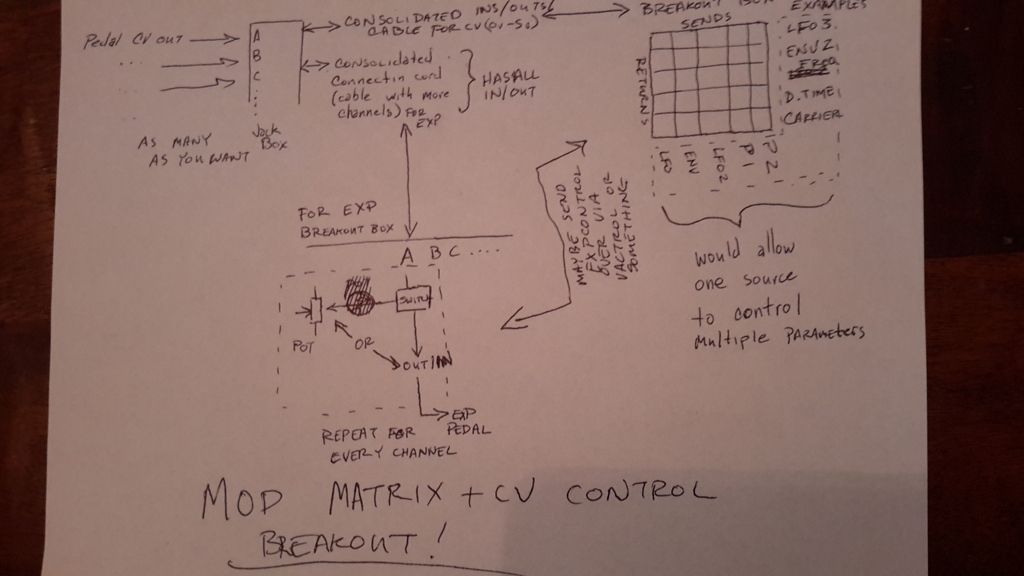

Here's the scoop (you seem to understand this already): what I want to be able to do is access every parameter, knob, jack, and combination of these things at all times. I'm too antsy to do otherwise, and the stuff I have come to love is too deep and flexible to be consigned to use as "effects." This stuff changes the way I make music, and having access to all of what it can do is a big deal for me.
So, if there's a way to create a breakout box with a printer cable (not entirely sure what you mean by printer cable--I think I get it) that I can simply plug in and fiddle with in a way that's separate from the jacks of the pedals themselves, that'd be great. My board has two tiers, and the lower tier's jacks are always obscured by the upper tier. So every time I want to change something, or plug in an expression pedal, I have to move everyone around. No bueno.
So perhaps I could just run that same enclosure under the top tier, patch all I/O and some EXP/CV jacks to it, then run that to a breakout box? I'll consider that, as it seems pretty smart. Though I'd need a massive printer cable, or a series of them.
I'll admit, I don't quite follow you on the expression pedal controlling a remote pot. I understand that pots have different resistance ratings, but I'm not sure how I might wire things to utilize a Moogerfooger's LFO or envelope out function might be impacted in this scheme (both for sending these signals--which seems simple--and for receiving them--which seems more complex). This has more to do with my ignorance of the whole shebang than with your explanation, I'm afraid.
And, upon looking up the EMS Synthi: 1) It seems bonkers, and 2) I would hope for something more robust than the little pins inserted into that matrix. Though the idea behind this whole thing is essentially the same.
If you have a diagram handy for what you're describing, yeah, I'd be super interested in seeing it. No biggie, though.

I'll draw you up a picture here while I cook a pizza. See if I can explain the whole concept better. (the only reason I had said to pick the exp/cv connections you really want is because some of those moogs have a ton...and it would just be a logisitcal nightmare is all. but the idea is expandability, so theorically you could include as many connections as you want).
The different pot values stems from the pot in the actual pedal. The moog ep's are 100kohm and the roland is 50kohm. Sometimes you wont get any real noticable effect because of scaling using the wrong pedal (for example...added exp to a DOD delay pot which was 5kohm. Basicually just set delay time at max with no real sweep when using the roland or boss pedal.)
The beauty of the EMS matrix is that you could have the LFO off the moog ring mod control several things at once without special cables (just an example...not the only way to use it).
The other thing to consider is the difference between CV and EXP and the lack of an overall standard in pedals. May need some vactrols in there to keep things floatin'

http://www.ericasynths.lv/en/shop/euror ... mixer.html looks pretty neat. I know it is synth gear, but it is basicually a router. With the ability to save patches and to sequence it would be super trick. Another options if you wanted to go DIY route would be to build something like that in the form factor you want with Arduino using MUX or relays. (thanks for the headsup on erica synths D.o.s.)
http://i284.photobucket.com/albums/ll11 ... lu7nkx.jpg might help...Will draw something better at some point...hope it helps :idk:
Just make the CV breakout box like the pedal patchbay, just that it has the option to default to a knob and can be switched to a jack (for in out).
I don't know if the CT5, pitchfactor, or boomerang can take the 0-5v of CV (I think I remember that the CT5 can)...but for the most part, getting the moogs together shouldn't be a problem.
