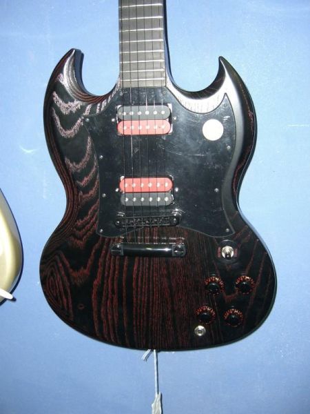

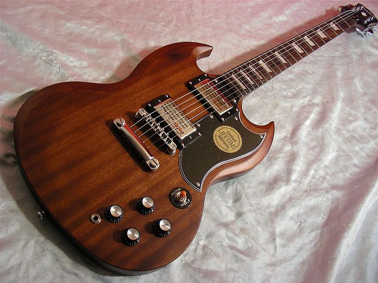

id like to go from this
to this
theres a bunch of other forums
with the same question asked
but it seems more of a debate
and the red undertones not important
just the ebony grain
and i will take NO for an answer
to this
