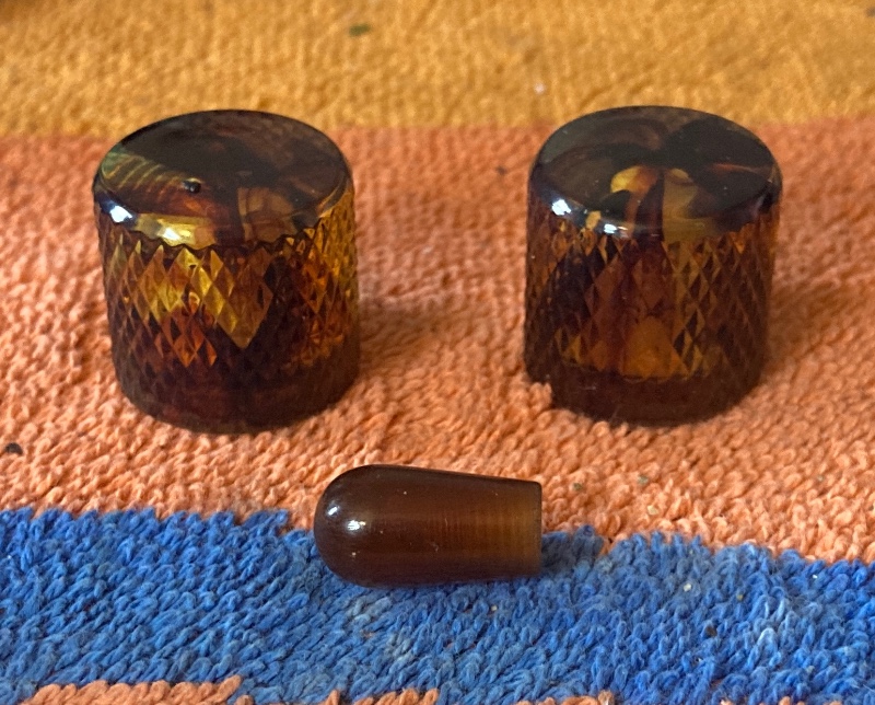

i got the switch tip for the Telecaster in the mail, but lost it. it’s OK, because i found a Tone Ninja tortoise tip that’s the nicest of the three i’ve seen. since i was being charged for shipping i got a set of compensated saddles for the Duo Sonic as well.

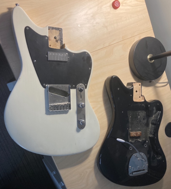

i got the two offset bodies from Charlie and they’re peculiar. one is a white blonde Telemaster with a six-saddle Tele bridge and a mini-humbucker already in the neck position. i think it’s made of that ungodly heavy ash like Peavey used for their early basses and guitars, and is the heaviest body i’ve ever seen, quite possibly seven pounds or more by itself. to make it useable i’d have to rout out the areas under the pickguard, and it’d probably still be a boat anchor.

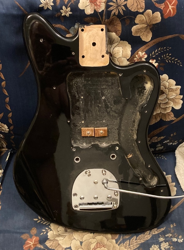

as far as i can tell the other is a black Jaguar/Mustang-sized body with a cheap JM trem. i could be wrong, though, because the bridge pickup rout has indents for the tabs on JM pickup covers. it’s a lot more my speed than the Telemaster, but probably doesn’t do a thing for the baritone project. these will probably get back-burnered until some use for them comes up.

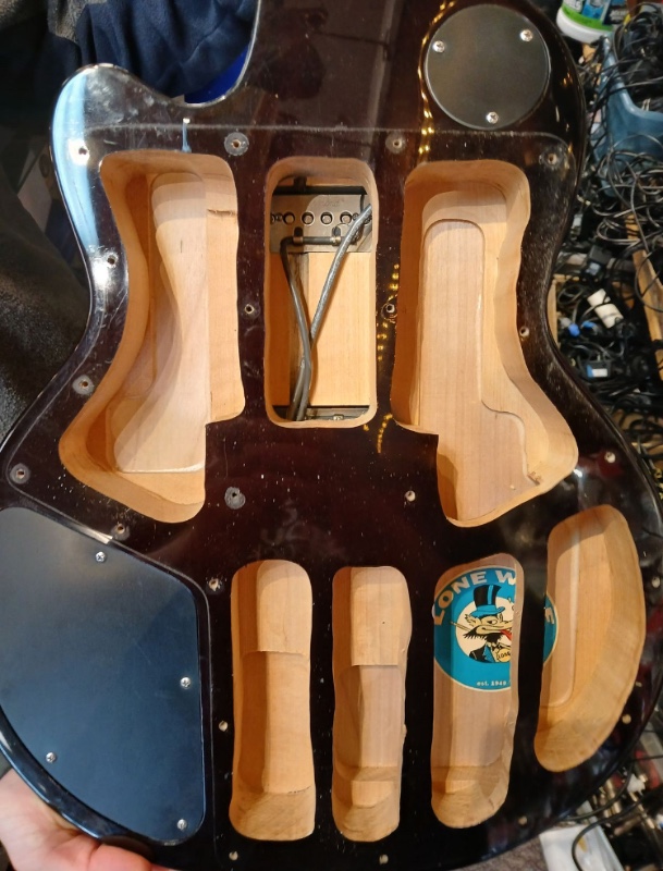

Not saying it’s a good idea or I would have already done this to my lucite mockingbird body but.. I’ve always wanted to lighten a guitar body by “drilling” a 3”wide hole in the bass bout kinda where the contour is

it also occurred to me that if i knew someone with a router i could have them take whole areas out from the back like was done to the sparkly blue DeArmond M-75T upthread and cover the back with a plate of pickguard material. but i don’t know any woodworkers. so god only knows when i’ll do something with it. i’ve never been interested in Telemasters, but this thing has a vibe, an identity in there somewhere.
upon examination the black body does appear to be 25.5” scale, but it’s visibly smaller than the Jazzmaster bodies i have here. this can be a positive because smaller bodies are always ergonomically better for little me. i’ll have to think about what kind of non-redundant pickups i might use and what might work sonically and aesthetically with the body. my perverse little brain wants something more peculiar, a less predictable choice.
i have no idea why there are two flat blocks screwed into the bathtub rout. probably to support some kind of more shallow pickup.

Technically that is not hard to do.. just very time consuming and messy… that looks like it was started free hand.. so what you do is.. get a router with a 2 or 3 straight cut bits a different lengths, draw your hole shapes with a sharpie, set the bit depth about 1/2”, remove all the wood in your shapes, from here on you would use a bit with a top bearing, set the depth a bit deeper that the first pass using what you already routed as your “template”, repeat until you reach required depth… note, it is not a fun job.
Personally I wouldn’t do it that way… I’d get a 2” wide drill bit and use a drill press a do individual holes.. kind of like what Billy G has his guy do with the honeycomb pattern..
On the other hand if I was building from scratch I think the way they chambered the Gibson Chet Atkins acoustic electrics were cool, they chambered in the same pattern as the braces on a acoustic top.. I think the channels were about an inch wide..

i weighed the white Telemaster body and it’s 7.2 pounds. granted the bridge and pickup add weight, but only a few tenths. i have guitars heavier than the 9.5 or so it’d probably weigh with a maple neck, but it’s so concentrated in the back half of the body that it’s hard to imagine it being very comfortable to hold up. if i wind up with a spare neck i’ll probably try something, but the most likely fate is to be sold off unless the sound blows me away when it’s assembled. lacking a router or any other kind of serious power tools i probably won’t do anything with the weight relief. i’m not drilling 300 1/4” holes with a battery hand drill.
upon inquiry with the offset boffins on Facebook, it appears the black body is a Xaviere from GFS. which means it’s decent wood, but makes it less likely i can find a drop-in pickguard unless GFS has ones adapted to that specific body design. not a huge deal to do another tracing and mail it to Ohio, but i’m trying to make this shit easier on myself.

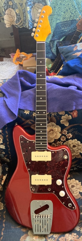

well, things have been zipping along since last we spoke. i finished sanding the fingerboard on the baritone neck and got the basics assembled. i sanded the neck and headstock down to 1500 and the satiny neck feel was so nice that i decided to stop there. in the interests of getting this shit done i only did the fingerboard with 1000 grit and then buffed strenuously with lemon oil and a rather coarse terrycloth dish towel. it’s not as nice as the boards i did down to 2000, but it’s acceptable.
the tailpiece and tuners are really impressive, very solin stuff. all the basic bits are here now except the back pickup which is scheduled to arrive tomorrow. i ordered a 12” long 1/4” drill bit from StewMac to make holes to connect the pickup and a ground wire for the tailpiece to the control cavity.
i have wiring ideas, but i don’t feel like going into them at the moment. i’m really happy with how it’s coming along.
