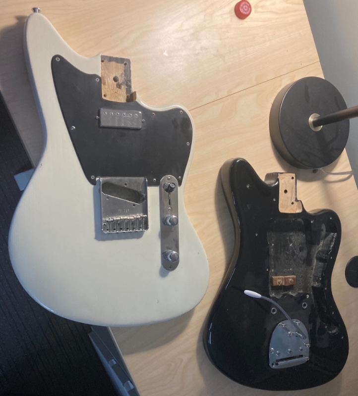

i got the two offset bodies from Charlie and they’re peculiar. one is a white blonde Telemaster with a six-saddle Tele bridge and a mini-humbucker already in the neck position. i think it’s made of that ungodly heavy ash like Peavey used for their early basses and guitars, and is the heaviest body i’ve ever seen, quite possibly seven pounds or more by itself. to make it useable i’d have to rout out the areas under the pickguard, and it’d probably still be a boat anchor.
as far as i can tell the other is a black Jaguar/Mustang-sized body with a cheap JM trem. i could be wrong, though, because the bridge pickup rout has indents for the tabs on JM pickup covers. it’s a lot more my speed than the Telemaster, but probably doesn’t do a thing for the baritone project. these will probably get back-burnered until some use for them comes up.
sorry for the crappy office lighting.

it also occurred to me that if i knew someone with a router i could have them take whole areas out from the back like was done to the sparkly blue DeArmond M-75T upthread and cover the back with a plate of pickguard material. but i don’t know any woodworkers. so god only knows when i’ll do something with it. i’ve never been interested in Telemasters, but this thing has a vibe, an identity in there somewhere.
upon examination the black body does appear to be 25.5” scale, but it’s visibly smaller than the Jazzmaster bodies i have here. this can be a positive because smaller bodies are always ergonomically better for little me. i’ll have to think about what kind of non-redundant pickups i might use and what might work sonically and aesthetically with the body. my perverse little brain wants something more peculiar, a less predictable choice.
i have no idea why there are two flat blocks screwed into the bathtub rout. probably to support some kind of more shallow pickup.

i weighed the white Telemaster body and it’s 7.2 pounds. granted the bridge and pickup add weight, but only a few tenths. i have guitars heavier than the 9.5 or so it’d probably weigh with a maple neck, but it’s so concentrated in the back half of the body that it’s hard to imagine it being very comfortable to hold up. if i wind up with a spare neck i’ll probably try something, but the most likely fate is to be sold off unless the sound blows me away when it’s assembled. lacking a router or any other kind of serious power tools i probably won’t do anything with the weight relief. i’m not drilling 300 1/4” holes with a battery hand drill.
upon inquiry with the offset boffins on Facebook, it appears the black body is a Xaviere from GFS. which means it’s decent wood, but makes it less likely i can find a drop-in pickguard unless GFS has ones adapted to that specific body design. not a huge deal to do another tracing and mail it to Ohio, but i’m trying to make this shit easier on myself.
