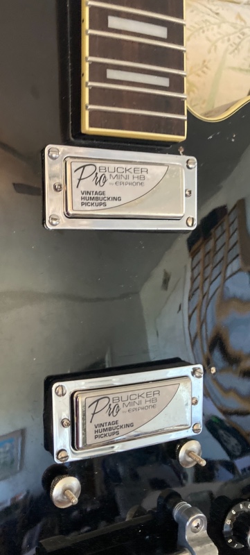

got the replacement pickups in. surprisingly the ring mounting screws were long enough to work with one and three foam spacers respectively, and it looks like the pickup height is good.

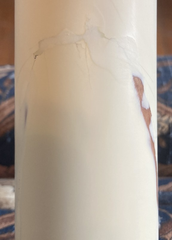

i got a bug up my butt about filing down the CA fill along the bass side of the Jetstar fretboard, and wound up sanding down the first coat on the neck. it's actually better than it looks in the photos, which prominently display cracking in the original finish and differences in texture that are less obtrusive in person. i got it reasonably smooth with 1000 grit, but i think the other painted bits should dry longer...some of the paint on the neck wasn't quite cured. i'll mix up some more of the tinted Vintage White and do another pass on the neck presently.

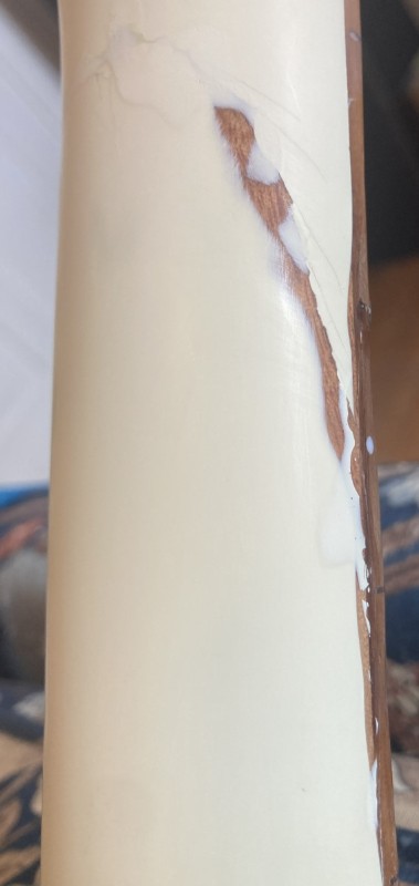

to get everything smooth i wound up having to take off some of the finish along the fretboard.

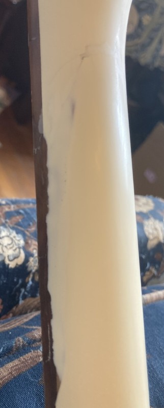

here you can see the filled area along the edge of the fingerboard which is darker than the rosewood.

i'll tape off the edges of the fretboard before the next coat. it's problematic because i need to do thin coats so the paint behaves properly, but it's not really dense enough to hide the bare wood unless i gob it on. i may have to accept that i can't get a near-perfect visual result on the neck unless i come up with some primer or something.
the other areas actually look like they're pretty well covered, but as noted i'd better leave them alone for another couple of weeks (yeesh). but i'm making progress on the neck so i'm happier.

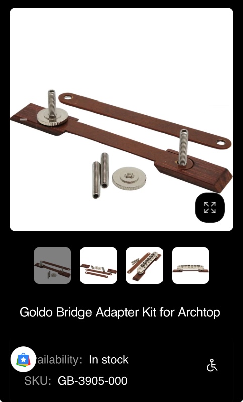

the folks at Goldo have a bridge mount for archtop guitars (which would probably work anywhere) that uses the plastic strap connecting two discrete feet concept from the Gretsch-associated Melita bridge and comes with two heights of bridge studs. i may use this on the Galaxiemaster because it appears to just about fit the spacing on the Musima bridge i plan to use. this gets me out of having to drill big-ass holes for the studs which are bigger than Gibson studs. it could also work on the Electromatic Jets if i wanted to pull the Tunomatic sockets, but i don’t think i want to do that much work for what would probably be minimal gain. not sure if i’d leave the feet as-is or round them off like i did with the Bigsby aluminum bridge base on the Kondor. i think i’d need to see how it looked before deciding. it might be better to have more area on the bottom of the feet to help keep the bridge from moving around when using the tremolo.
i’m leaning back towards using the Bigsby B50. i didn’t care much for the couple of demos of the Goldo JM trem which clicked audibly when returning from down-bends, and the Bigsby just looks right. also mulling over the idea of a piezo pickup. i know that folks say noise from the tremolo would be an issue, but i don’t think i’m going to be whammy-ing my faux acoustic sound. of course this raises loads of new questions because i know nothing about piezo pickups, and i’d also need one of those loooooong aircraft drill bits to run wires from wherever the pickup goes to the JM tremolo rout which seems an ideal place to house the battery if the pickup was active. it would help a lot to know what piezos they used on modern Italia guitars which have the most convincing “acoustic” sound i’ve heard from a stock piezo on an electric guitar. anyone know anything about this?
