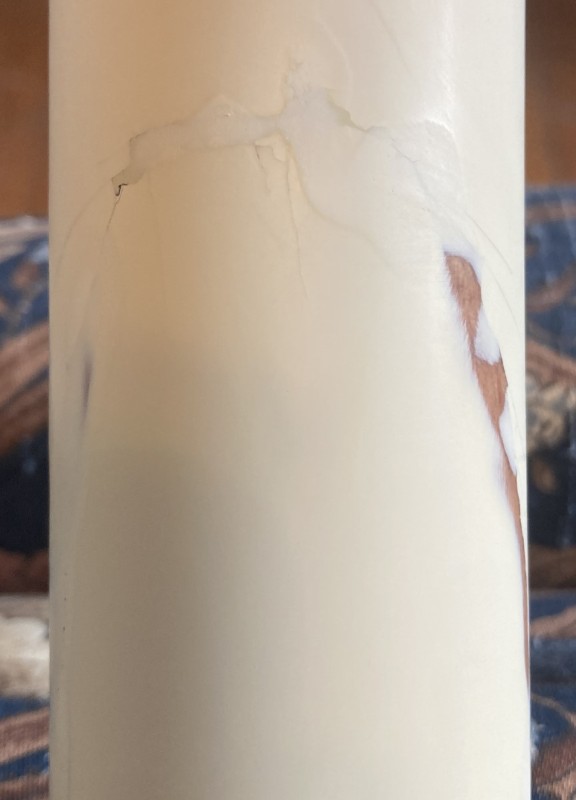

just did another round of painting on the Jetstar. did the neck break this time which i assume will need a second coat. hoping the other areas can be, erm, finished. tune in 2 weeks from now for the next part of that story. going to put the pickups in the M-77T next, but won’t have time to wire them up.

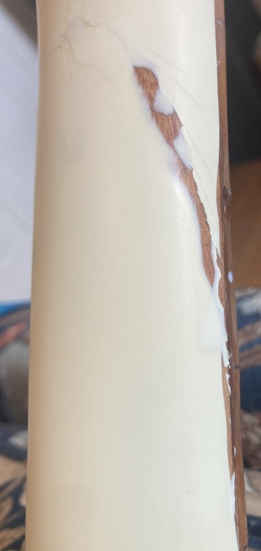

i got a bug up my butt about filing down the CA fill along the bass side of the Jetstar fretboard, and wound up sanding down the first coat on the neck. it's actually better than it looks in the photos, which prominently display cracking in the original finish and differences in texture that are less obtrusive in person. i got it reasonably smooth with 1000 grit, but i think the other painted bits should dry longer...some of the paint on the neck wasn't quite cured. i'll mix up some more of the tinted Vintage White and do another pass on the neck presently.
i'll tape off the edges of the fretboard before the next coat. it's problematic because i need to do thin coats so the paint behaves properly, but it's not really dense enough to hide the bare wood unless i gob it on. i may have to accept that i can't get a near-perfect visual result on the neck unless i come up with some primer or something.
the other areas actually look like they're pretty well covered, but as noted i'd better leave them alone for another couple of weeks (yeesh). but i'm making progress on the neck so i'm happier.

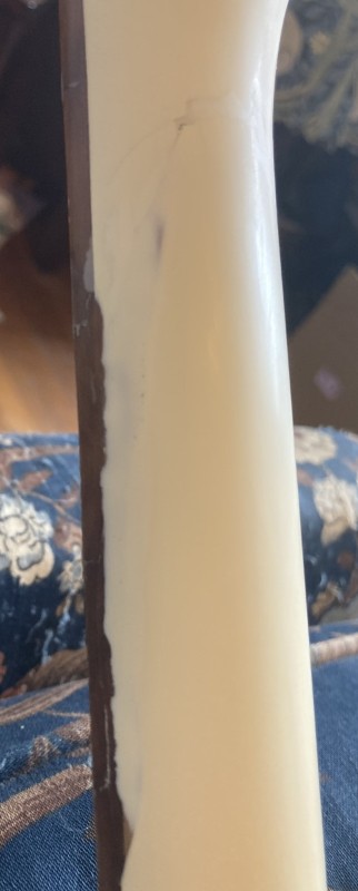

i’m going to try to use the white CA as a sort of primer on the bare spots. we’ll see how that goes.
