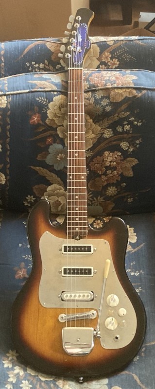

i have the Kondor on the bench, but need to go through it labeling leads because they’re really confusing, e.g. both leads from the varitone are in yellow jackets. i’m going to try leaving the varitone’s ground lead connected to the output jack’s negative terminal rather than reconnecting it to the volume pot’s ground. i’m hoping this will help isolate it from potential leakage through the volume pot’s ground. i’m about five inches from yanking the varitone and calling it a day or finding a used Gibson/Epiphone varitone.

i need to deal with the Kondor wiring because it’s sitting on the coffee table with the pickguard off and flipped and the wires hanging out. yes, i still hate soldering. but i need to do that before i work on the Strat.

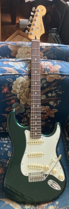

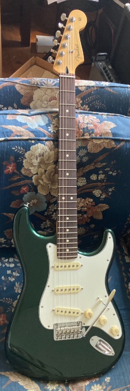

i couldn’t resist working on the new Strat this morning…i played it some last night and it really needed help, so today i did the string height and intonation and it’s much better now. the tremolo setup is all wrong per Fender’s instructions, so that’s the next thing i’ll do. those things should remain the same while the pickups and wiring are done. after that i’ll leave it till the Tonestyler is here.

i wound up spending the morning working on the BRG Strat. turned out i can’t precisely follow Fender’s directions for adjusting the tremolo because you can’t screw the posts in far enough for the bridge to sit dead flat on the body. so i ran them in as far as possible and went from there. once i got the trem adjusted more or less to my liking—i like to be able to go up a semitone when i pull up on the bar—i had to redo the intonation and will probably have to redo the string height as well. i want to try adjusting the stock pickups to see what they can do before i pull them. that’s going to be it for this weekend unless some time miraculously appears. i’ll still need to fine-tune the trem over time as it gets worked in, but it’s working for me now.

i’ve been out of commission for a bit after having a molar pulled on Tuesday, but i finally figured out the corrections for the Kondor wiring, labelled the leads, and figured out the sequence of rewiring that makes the most sense. i need to recharge the battery for the soldering iron before working though…i don’t trust 1/3-capacity to get me through. so it might push down to tomorrow.
the green Strat has commensurately been delayed, though i have everything i need for the rewiring. i noticed that the design of the Mexican Standard bridge posts makes it impossible to deck the tremolo. there’s an area between the threaded bit and the head without threads that keeps the posts from screwing in far enough. i looked at other posts online and ordered a set of American Standard posts and anchors which are threaded all the way up to the head. i’m hoping they work with the stock anchors, because i really don’t want to have to pull them. i’ll move ahead with the wiring so it’ll be ready to set up on Sunday assuming the posts problem is solved.

the extracted molar has continued to be distractingly troublesome right up till this morning when it finally seemed to have closed. it was pretty nasty, and i haven’t been up to working on anything until today, when the American Standard bridge posts for the green Strat arrived. unfortunately they’re only marginally better than the stock posts so i decided to just get on with it. i spent a good bit of time today tweaking the tremolo so it works for me. i wound up using 3 springs on the trem which is my usual practice; i usually do one in the center and one on either end, all connected to the center tooth of the claw but this claw won’t accommodate that so i wound up with one spring on the treble end and two parallel springs on the bass end. it’s still not exactly right, but it’s working and lets me wobble in ways i like. at some point i’ll adjust the tension by doing 1/8 of a turn adjustments to the claw screws to fine-tune it.

while plonking around on the interwebs last night it occurred to me to search for a straight Stratocaster tremolo arm because i hate the modern upbend at the tip which is supposed to let it tuck into your palm but doesn't work with how i play. i was delighted to discover that Fender sells a "Pure Vintage" straight arm that should work with my US spec trem and comes with two tips, a white one and a yellowish one, as well as a tension spring that goes inside the hole in the block. that should be here in a few days, probably early next week. $20 seems like a lot of money for a trem arm, but that's life in end-stage capitalism. when i feel more awake i'm going to work on wiring problems. i would love to get the Kondor and green Strat wiring done so they're off my plate.
<edit>i also got some short hex screws for the Strat’s bridge saddles; all of them are much too tall because a floating trem requires lowering the saddles so far that the bottom of the high E saddle is sitting on the plate. this makes palm muting rather unpleasant. i wouldn’t mind at all if i ran out of things to nitpick sooner rather than later, but i may as well get everything i can find sorted now. which reminds me that i have to file the nut slots so the fretted note on the first fret isn’t horribly sharp compared to the open string. i absolutely fail to understand why manufacturers don’t do this before stuff ships.

i finally managed to deal with the Kondor wiring and i’m pleased to say that repositioning the varitone really made it better. i now get useable level with only a slight drop in 3 of the 4 positions where before only the first two were remotely useable and only the first was loud enough without a clean boost. i need to find the source of an annoying rattle somewhere in the tuners, but that’s a minor problem. i also need to find my stash of plastic tubing because the screw that holds the tremolo’s chromed cover requires a gasket for the cover to stay quiet. but i’m really pleased that the varitone is much more useable at last. after i’ve enjoyed my victory and had dinner i could work on the green Strat, but i think i’ll wait until tomorrow when i’ll have more time…i don’t want to get into it and stay up too late because i’m going to a show in DC tomorrow night.

i realized that i've been neglecting to supply visual content, so here's a picture of the Kondor is what may well be its final form. while i was nitpicking i changed the beauty washer on one of the metal hole plugs in the control area of the pickguard so the two washers match. i sincerely can't think of anything else that needs to be done. i believe i started on this guitar 12 years ago. it was totally an experiment then, but it turned out to sound lovely. i'm watching a pair of the metal-shelled pickups like the bridge pickup here that are unusually hot for the type, which is to say ~4 and ~5kΩ respectively LOL. they normally run around 3kΩ, so those two and the 3kΩ one i have in the parts box would make a nice setup for a Strat-style guitar. i love most things about this guitar, but i'm particularly fond of the Kay-style tremolo which it strikes me could be an alternative for the Galaxiemaster though i'd probably need a metal plate to cover the hole so i could install it since it's smaller than the JM rout. but that's another can of worms.

the Strat tremolo arm arrived yesterday, and the saddle height adjustment screws will be here today which is nice because they weren’t supposed to arrive till Wednesday. so i can work on the Strat when i get home tomorrow. i already changed the arm, which is a perfect fit. there’s a slight bend 2/3 of the way up, but it’s gentle and more of a sideways bend in a flat arm rather than the steep up-curve of the stock arm. they included two of those wee black tensioner springs that drop into the block, and one works a treat. appears to have taken all of the slop out of the arm which it needed badly. it’s also nice that they supply 2 tips, a dead white one and an off-white one that matches the new knobs better. it’d be nice to finish it off which would be 2 guitars done in 3 days, but i’m not going to rush…if i hurry i’m bound to fuck something up.

it was a nice surprise that the Kondor wiring was easier than i expected…i didn’t even really scorch any insulation. which makes me feel better about the wiring the other guitars will absolutely require. by the time i feel OK about soldering i’ll be out of projects.

i tried to get going on the Strat today, but it took forever to take everything apart. when you take all the strings off a 2-point tremolo at once it falls out of the crease in the posts and the springs fall off. noted for future reference. in order to get the pickguard off i had to clip the leads to the jack and the ground wire to the tremolo claw. there’s plenty of slack to reattach them. but by the time i got everything apart it was too late to get into the complexities of rewiring it so i punted it down to tomorrow. i keep telling myself “it’s OK, doing the Kondor went well.” i’m going to be thrilled when i’m done with wiring FIVE FUCKING GUITARS (green Strat, Double Jet, M-77T, Supro, and Telecaster) in the next few weeks. by the time i’m done sanding the Galaxiemaster fingerboard will be like a vacation.
