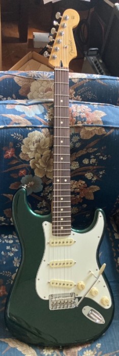

the British Racing Green Strat arrived today. it’s just fucking gorgeous. when the Tonestyler arrives Monday i’ll add it, change the pickups, restring it, and set it up. see “Let’s See Your Guitar” for specifics.

i couldn’t resist working on the new Strat this morning…i played it some last night and it really needed help, so today i did the string height and intonation and it’s much better now. the tremolo setup is all wrong per Fender’s instructions, so that’s the next thing i’ll do. those things should remain the same while the pickups and wiring are done. after that i’ll leave it till the Tonestyler is here.

i wound up spending the morning working on the BRG Strat. turned out i can’t precisely follow Fender’s directions for adjusting the tremolo because you can’t screw the posts in far enough for the bridge to sit dead flat on the body. so i ran them in as far as possible and went from there. once i got the trem adjusted more or less to my liking—i like to be able to go up a semitone when i pull up on the bar—i had to redo the intonation and will probably have to redo the string height as well. i want to try adjusting the stock pickups to see what they can do before i pull them. that’s going to be it for this weekend unless some time miraculously appears. i’ll still need to fine-tune the trem over time as it gets worked in, but it’s working for me now.

the green Strat has commensurately been delayed, though i have everything i need for the rewiring. i noticed that the design of the Mexican Standard bridge posts makes it impossible to deck the tremolo. there’s an area between the threaded bit and the head without threads that keeps the posts from screwing in far enough. i looked at other posts online and ordered a set of American Standard posts and anchors which are threaded all the way up to the head. i’m hoping they work with the stock anchors, because i really don’t want to have to pull them. i’ll move ahead with the wiring so it’ll be ready to set up on Sunday assuming the posts problem is solved.

in the meantime i worked on the maple-neck Strat which is a bear to set up because the truss rod adjusts at the heel. i think it’s pretty good now, but need to play it and the Duo Sonic a bit more before i put them away. i reckon that after the Strat is done i’ll put the pickups in the M-77T. by then the Bigsby pickups may be ready, in which case it’ll be hard not to do the Supro before the Double Jet. it’s hard keeping track of all this stuff even with Google Docs with everything broken out into bulleted lists. i would very much like for the intensive guitar work phase to be over soon. life would have been much simpler if i hadn’t seen those Waterslide Guitars demos of guitars with the Mojo Bigsby and Goldo Davoli pickups.
