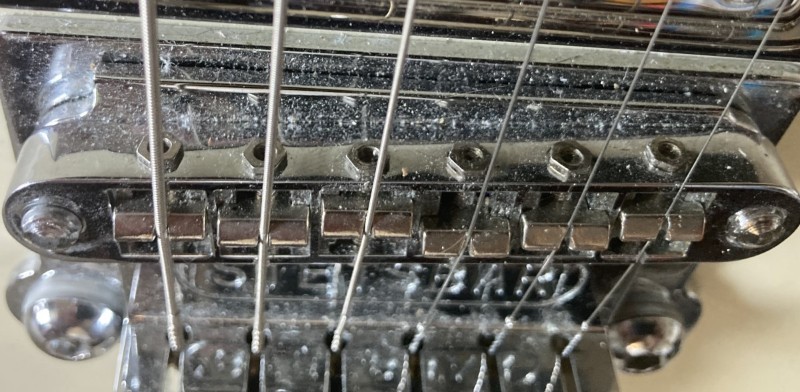

i’m not up for diving into the Jetstar finishing yet, so i’ve been tinkering around with it. i had to file the bridge saddles down almost to the level of the frame to improve the action because the 2-level structure of the Stetsbar raises the bridge too high above the body. i got that sorted OK and then pulled the pickguard to see if simply having a mirror-image duplicate made would work. unfortunately that won’t quite do because the contours of the body are too different on the other side. that beveled edge along the left lower bout screws up the spacing so the bottom end doesn't fit, and i don't want to get into the degree of redesign it would require to make it work. oh well.

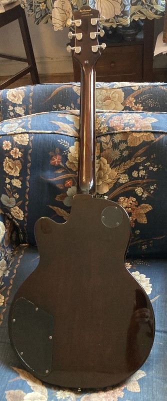

the M-77T was finally delivered today. the good news is that the fingerboard doesn’t appear to have actually separated from the neck at all, so all the edges of the board need is sanding and touchup painting with the poly clear coat. it also looks like the entire wiring harness is intact and they just snipped the wires from the pickups at the selector switch. i haven’t taken the covers off so i can’t say for sure, but it looks good so far.
on the less great side, the finish is rather more tired than it looked in the listing photos. the top has a maze of fine scratches, and the back predictably is more beat. everything should polish out with the exception of a few small dings on the top between the cutaway and where the pickguard begins, which will probably get painted or drop filled with CA depending on how much trouble it gives me. the fingerboard needs to be cleaned and oiled. i really don’t want to have to fine sand the entire top like i did with the M-75T…it looks less damaged so hopefully a couple of passes with polishing compound should do the trick.
it looks like Firebird pickups should fit the routs, which oddly are much deeper than the surface-mount DeArmond 2K pickups which were the original equipment. i haven’t any idea why they’d have done that, and wonder if they meant to use some other pickups that never made it off the drawing board. the routs don’t look big enough for the Guild LB-1s like in the Jetstar, so i’m mystified. Franz P-90s? if i wasn’t at capacity for P-90 guitars i would consider the 75-77 series as a platform. i really like them…they’re not superbly comfortable and tend towards the 8 to 10 pound range, but the body, neck, and scale are good for me ergonomically. there’s nothing else in my pickup want list that would work with these DeA’s as a platform. WRHBs and Bigsby pickups wouldn’t be right for it, and the other stuff left is Strats and Teles which are the right platforms for the Strat and Tele-style pickups i want. it’ll be nice to do “projects” that are brain transplants on otherwise complete guitars. i’d particularly like to get a used Strat off the shelf and just drop in the CS69 pickups.
i’m really happy that things came together easily, and that it appears i won’t have to completely rewire it. you know how i feel about soldering. tomorrow or Wednesday i’ll go to the hardware store and get some washers like the ones the previous owner used to raise the front of the DeArmsby so the break angle wasn’t atrocious. but i have to clean and polish it before mounting anything other than the small Grover bean tuner buttons. the keystone buttons required screws that were too long for the baby beans; fortunately i had shorter screws that came with the Hipshot buttons i put on the Kondor that i didn’t have to use.

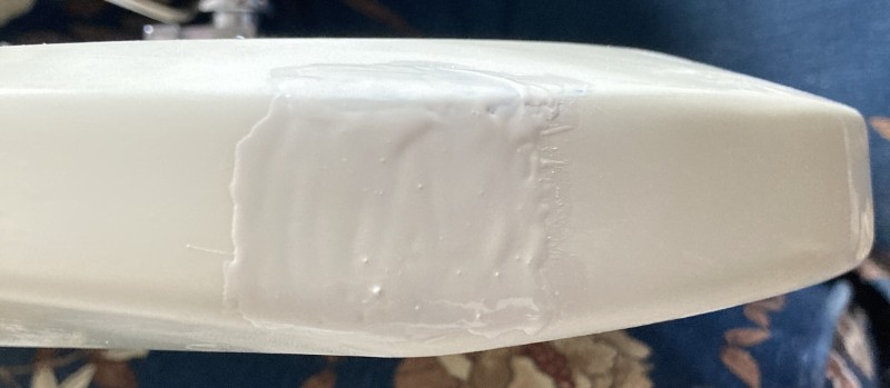

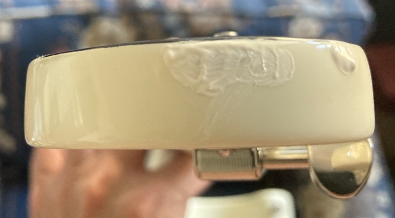

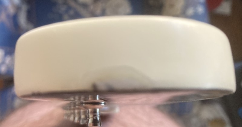

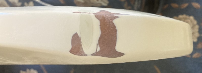

i finally got going on what hopefully should be the last stage of working on the Jetstar. i’m starting by sanding the headstock tip and the area around the filled ding on the left lower bout with 800 grit paper to give the paint some texture to grab onto. it took more sanding than i anticipated to get the side areas flat and reasonably smooth; apparently the accident + 3 or 4 layers of attempted repairs made it a tiny tad uneven, and the different hardnesses of whatever filler was first used, the CA i applied over that, the existing paint, and the wood made getting flat surfaces tricky. i think it’s pretty good now. we'll see how well it works.

i put a first coat of lacquer on the areas i prep sanded. it goes on pretty thick if you want actual coverage. looks like the color isn't a perfect match, but it's close enough for jazz. the clearcoat should also help to even out visible differences like it did on the Kondor body. when the white has dried and been niced up i'll fix up the boundary line between the white edge of the headstock and the black face.
and now we wait. the Nitorlack site says let dry for 24 hours between coats, which works for me. they also say to let a completed finish dry for 2 to 3 weeks, which isn't happening. that's if you're polishing out a full coat. i think i can get around that because it'll be covered by clear poly after sanding etc. so maybe i'll do another coat tomorrow. but it's finally happening, y'all. if i want something else to do tonight i could start polishing out the M-77T.
how do people who don't have a workshop let a body dry for 3 weeks? it's kind of gonna get in the way in the garage or basement.

it didn't take long at all to polish the back of the M-77T. that Meguiars polishing compound is the shizzle. there are a few deeper scratches the compound won't get, but they're not that serious and on the back where nobody will see them.
i need to take the retaining nuts off the pots and switch and push them down into the cavities before doing the front so i don't end up with less well-polished rings around the parts. i really would like to order the pickguard, but i have to get the pickups and rings first so i can establish how deep the pickup cutouts need to be. they'll probably start at the outside edge of the pickup rings like the M-75 so i can adjust the pickup height without taking the damn pickguard off.
