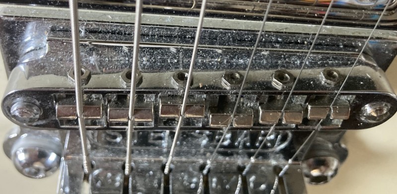

i’m not up for diving into the Jetstar finishing yet, so i’ve been tinkering around with it. i had to file the bridge saddles down almost to the level of the frame to improve the action because the 2-level structure of the Stetsbar raises the bridge too high above the body. i got that sorted OK and then pulled the pickguard to see if simply having a mirror-image duplicate made would work. unfortunately that won’t quite do because the contours of the body are too different on the other side. that beveled edge along the left lower bout screws up the spacing so the bottom end doesn't fit, and i don't want to get into the degree of redesign it would require to make it work. oh well.
if i'd had to go any lower i'd have been completely off the  surface and down into the square base.

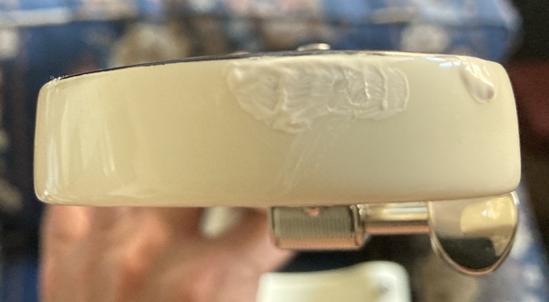

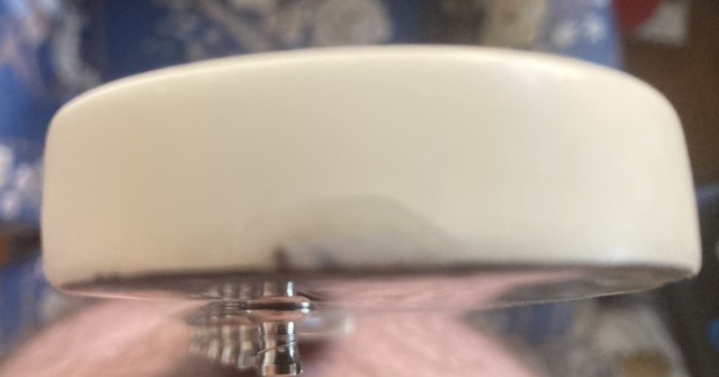

i finally got going on what hopefully should be the last stage of working on the Jetstar. i’m starting by sanding the headstock tip and the area around the filled ding on the left lower bout with 800 grit paper to give the paint some texture to grab onto. it took more sanding than i anticipated to get the side areas flat and reasonably smooth; apparently the accident + 3 or 4 layers of attempted repairs made it a tiny tad uneven, and the different hardnesses of whatever filler was first used, the CA i applied over that, the existing paint, and the wood made getting flat surfaces tricky. i think it’s pretty good now. we'll see how well it works.

i put a first coat of lacquer on the areas i prep sanded. it goes on pretty thick if you want actual coverage. looks like the color isn't a perfect match, but it's close enough for jazz. the clearcoat should also help to even out visible differences like it did on the Kondor body. when the white has dried and been niced up i'll fix up the boundary line between the white edge of the headstock and the black face.

and now we wait. the Nitorlack site says let dry for 24 hours between coats, which works for me. they also say to let a completed finish dry for 2 to 3 weeks, which isn't happening. that's if you're polishing out a full coat. i think i can get around that because it'll be covered by clear poly after sanding etc. so maybe i'll do another coat tomorrow. but it's finally happening, y'all. if i want something else to do tonight i could start polishing out the M-77T.
