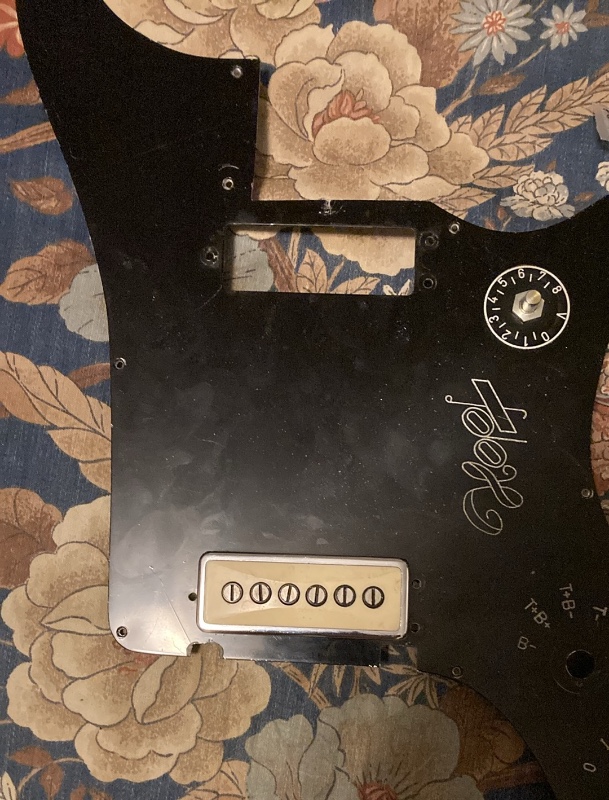

Posts: 14854
i got the bridge pickup cutout finished. i’m having to move the center line of the pickups about 3mm in from the top and bottom edges to allow for clearance since they’re bigger than the old pickups. i’m leaving it here for now because i need to rest up for tomorrow. sometime on Saturday i’ll do the other cutout and drill new holes for the mounting screws; after that there’s the aforementioned three soldering points, and if everything’s working then i’m essentially done other than setup and finish issues. oh, and i still have to file the shaft on the volume knob so the knob will fit.

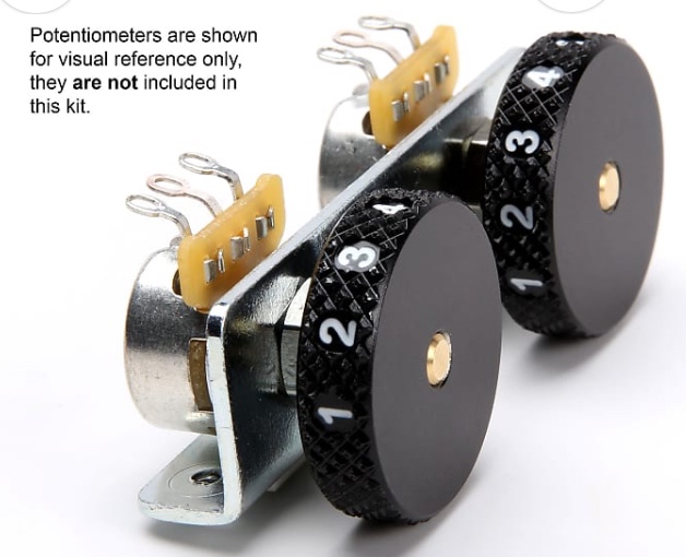

in other project news, i’ve been working on the concepts of wiring the Galaxiemaster. i found white rollers for Jazzmaster parts so i’ll do the pickup volumes as originally planned and white on/off switches for each pickup. i should be able to fabricate 3 roller pot brackets from 2 Jazzmaster or Jaguar brackets (they have different distances between the 2 pots that attach to the bracket) which i’ll need to do to get the pots to line up with the ends of the pickups. when i’m done with the Hopf i want to investigate the most severe automotive polishing compounds. i saw one at O’Reilly that specifically said it’ll take out orange peel texture, which is a GFS body thing. if it works i’ll consider using a similar quality/price level body for my off-in-the-distance Tele and Strat builds, otherwise it’s back to buying used Fender bodies. i’d rather get Strat bodies that have the tremolo mount screw holes already done. the grain filler is ordered so I’ll be able to finish off the Höfner neck, and i can graft in the extra Schaller/Hopf tone switch no problem. the hardest part will be laying out the pickguard, which i can’t totally do until i fabricate the brackets and buy the switches so i know how they’ll mount. i have lots of pickguard template printouts, so it’ll get done. when that guitar is done it’ll be a huge load off my mind, and the culmination of a process that started when i bought a pair of Höfner staple mini-hums off eBay in 2012 because Neal out of Slowdive used to play a Galaxie in their early days, swapping with a Rickenbacker 360.

i made a short list of items i need to figure out pickguard item placement, including one roller pot assembly (with bracket, pots, and wheels), one Fender slide switch, one of the pickups, and the Schaller tone switch. that’ll be down the road a bit because i’m not doing pickguard stuff till after the body and neck are ready.

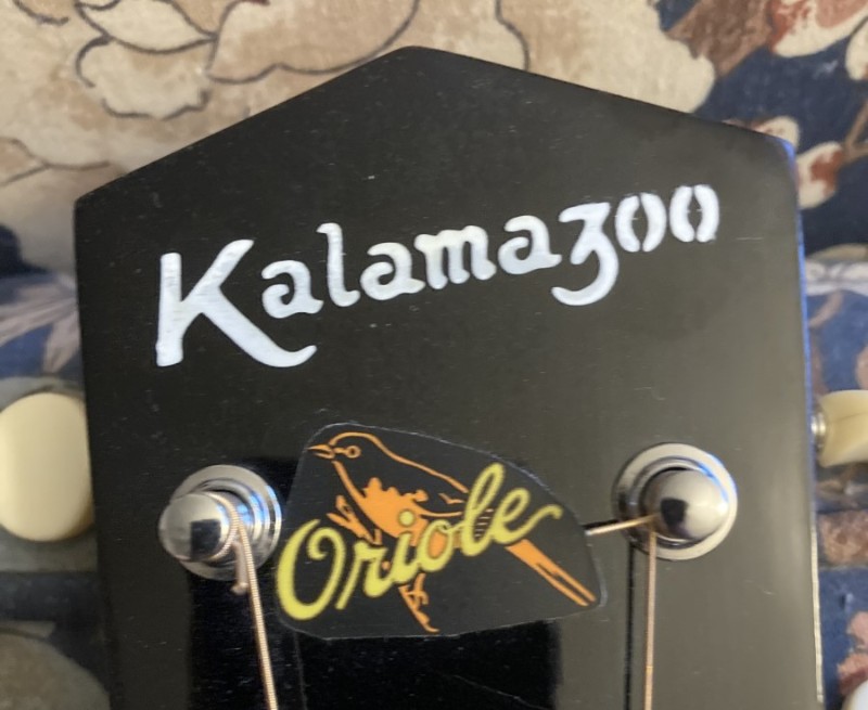

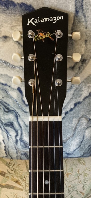

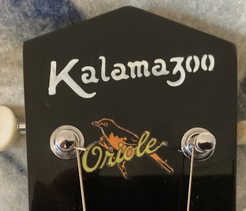

now that the StewMac stuff has arrived i’m working on small fixes on various guitars in between the major projects. when i got the Kalamazoo Oriole one thing i didn’t like was that the Oriole logo sticker on the headstock had too much flashing visible around the edges.
so i carefully trimmed around the edges of the logo with an X-acto knife to get that stuff off there. it isn't perfect, but i think it looks better. the material is quite thick, with a black backing behind the color print.
the imperfections pop out close-up, but from a couple of feet away they're invisible except on the tail of the "e."
i'm going to take a break, finish my coffee, and consider what to do next.

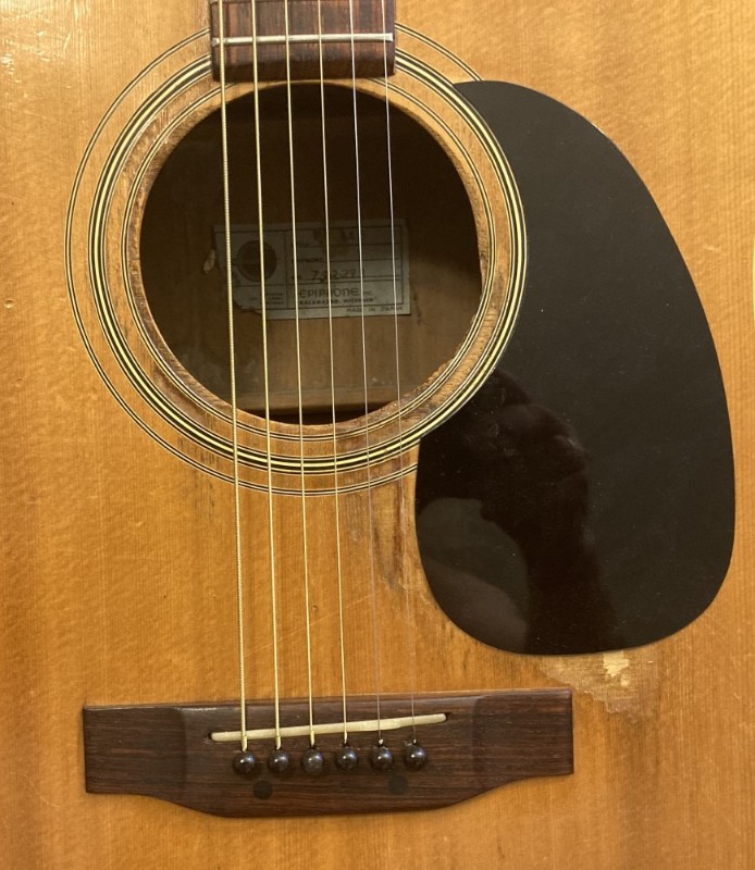

clearcoated the damaged areas around the soundhole of the Epiphone acoustic as well as a spot on the left side of the upper bout from being dropped c.1974 when i was hitchhiking without a case and the strap came off. used the Clear paint marker from StewMac. it might have been better to use the poly clearcoat, but i figured lacquer would be more compatible with the old, presumably lacquered finish. unfortunately, the marker lacquer got sucked into some surface finish cracks that ran down from the damage on the soundboard, leaving dark streaks along the cracks. hopefully that’ll resolve itself when the paint dries. i won’t know just how good a result i got for several hours at least, probably till tomorrow. it’s good to have protected those areas on the top in any case. i’m going to wait to post photos until everything’s dry. i HATE waiting for paint to dry…as a kid i wrecked more than one model car/plane by trying to put it together before the paint cured.
Posts: 14854
here’s the result of the clearcoating on the Epiphone. it looks a lot better now that it’s dry. the visible bits of the first underlying ply, which is darker and runs cross-grained to the top layer, came out darker than when i started but i don’t see that as a problem. they were already like that, just less dark.

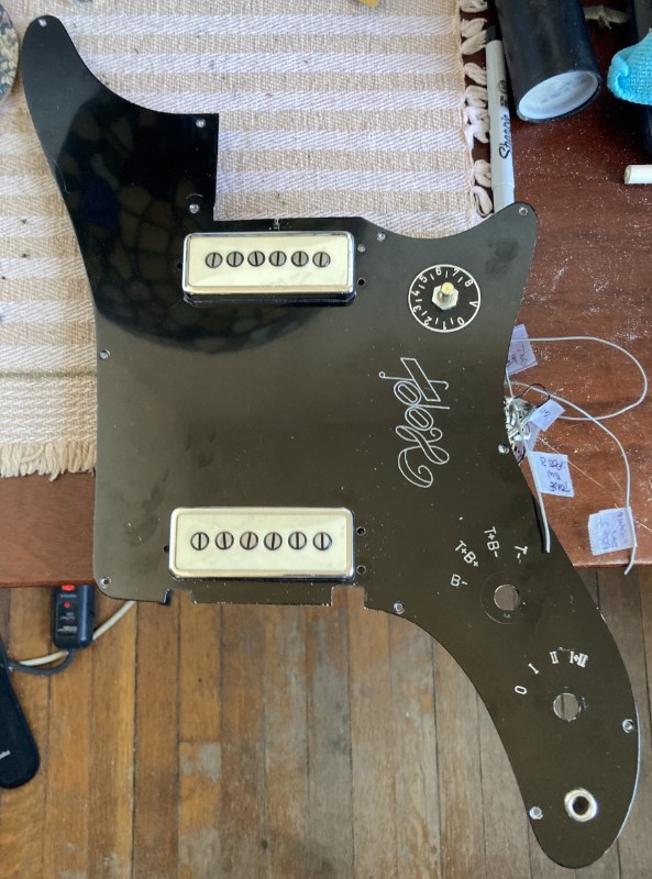

Posts: 14854
i got the other pickup cutout on the Hopf guard done. i'm going to chill for awhile and then drill the new holes for the pickup mounting screws. once that's done i should be able to connect the pickups/switches to the jack and volume control, check that signal's passing, and then put everything together, put the bridge on (i'm going to let it float since it's non-compensated), and string it up. i'm going to clearcoat the parts of the body where the finish is worn away before it's "done." i like when "done" means actually done. i reckon i'll do the Kondor next. i may try filling some of the chips around the edges with the StewMac black paint marker, but i'll try one inconspicuous spot first to see how it works. we're coming along here.
note: the neck pickup is straight; for some reason the pickguard edge where it meets the butt of the neck is slightly diagonal.

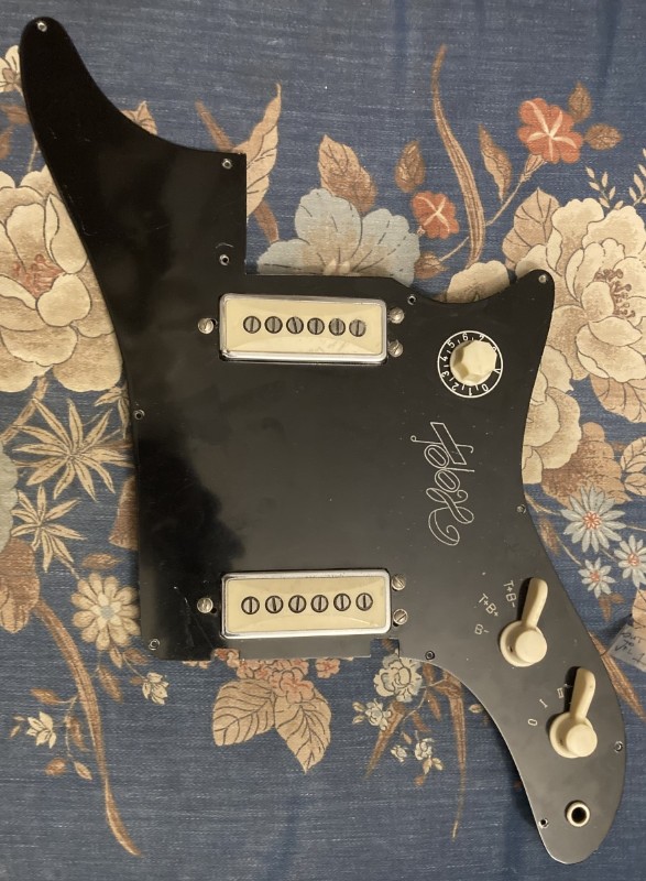

Posts: 14854
the pickguard is now physically done…drilling the screw holes for the pickup screws was trickier than it sounds, and i did a lot of filing with my tiny round file moving holes to where they needed to be and making them large enough to fit the screw diameter. once that was done i mounted everything on the pickguard and put the paddle switch levers on. i had to file down the shaft on the volume knob to fit the Hopf knob from the Jupiter guard, which requires a D-shaped shaft. i didn’t want to use the Jupiter’s volume pot because it was a tiny plastic thing.
you know how cordially i despise soldering, so perhaps i can be forgiven for punting till tomorrow on finishing up the wiring. it’s almost 8 and i’ve been working on it for about 5 hours, which is enough for one day. i absolutely will have everything put together tomorrow. after that i’ll do the Kondor headstock and experiment with the black lacquer paint marker.

Posts: 14854
when i got everything wired up it didn’t work. i wasn’t sure if the problem might be the Jupiter switches, so i decided to put the original Twisty switches back in because i know they work. i also removed most of the shielding from the pickup cables. i needed the slack in the wiring because the wires were so stretched that it could have been grounding out somewhere even though i wrapped the cable with electrical tape to insulate it. i soldered a ground wire onto the stub of the shielding and spliced extra wire at several points including the positive wires from both pickups so i could route things in a more sensible fashion. i ran out of time before i had to leave so i didn’t get to finish it, but i checked over and over to try to get it right. when i get home tomorrow i’ll finish the soldering and plug the guard into an amp to test it. fingers crossed.
in retrospect i should have left everything else alone and just wired the Jupiter pickups into the pre-existing circuit, but i didn’t want to mess with the pickup wires. which i wound up doing anyway. sometimes i go the long way around. i’m really looking forward to having these guitars done so hopefully i won’t have to do so much creative wiring. not looking forward to wiring the Galaxiemaster at ALL.
Posts: 14854

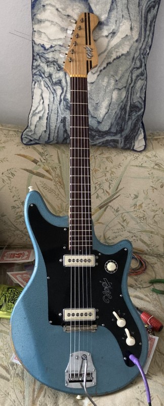

well, it works. there was some weird grounding happening on one of the pickup connectors, but after i moved the wires around some it resolved itself. now i have to set it up...i got strings on, but i think i need to put a shim under the bridge to raise it slightly or adjust the truss rod, which requires lowering the neck pickup so i can get at the tiny (2 mm) Allen adjuster. but the hard stuff is done. woo-hoo and all that. the visual balance is nice, isn't it?
