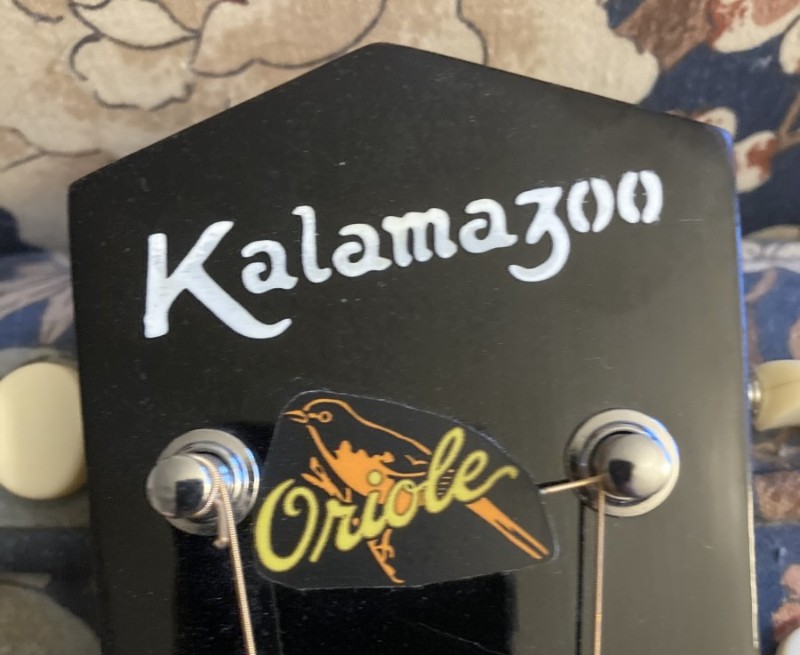

now that the StewMac stuff has arrived i’m working on small fixes on various guitars in between the major projects. when i got the Kalamazoo Oriole one thing i didn’t like was that the Oriole logo sticker on the headstock had too much flashing visible around the edges.
so i carefully trimmed around the edges of the logo with an X-acto knife to get that stuff off there. it isn't perfect, but i think it looks better. the material is quite thick, with a black backing behind the color print.
the imperfections pop out close-up, but from a couple of feet away they're invisible except on the tail of the "e."

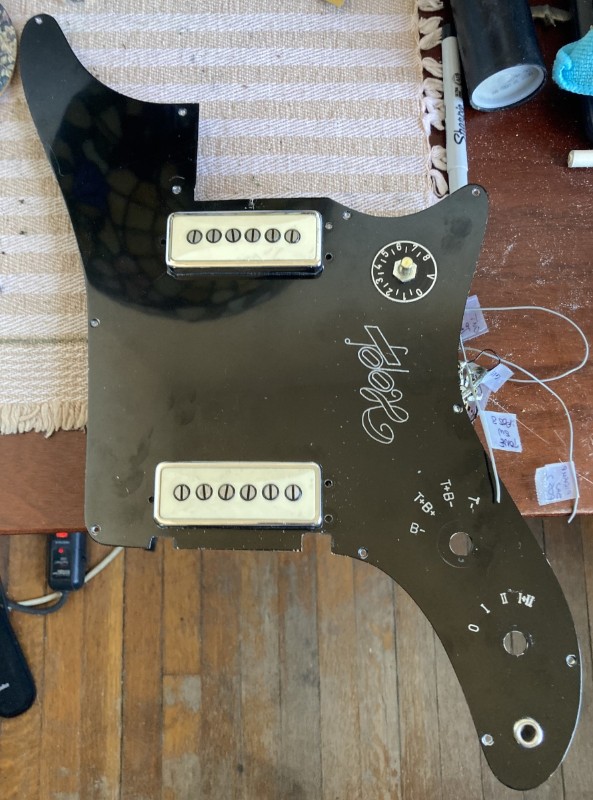

i got the other pickup cutout on the Hopf guard done. i'm going to chill for awhile and then drill the new holes for the pickup mounting screws. once that's done i should be able to connect the pickups/switches to the jack and volume control, check that signal's passing, and then put everything together, put the bridge on (i'm going to let it float since it's non-compensated), and string it up. i'm going to clearcoat the parts of the body where the finish is worn away before it's "done." i like when "done" means actually done. i reckon i'll do the Kondor next. i may try filling some of the chips around the edges with the StewMac black paint marker, but i'll try one inconspicuous spot first to see how it works. we're coming along here.
note: the neck pickup is straight; for some reason the pickguard edge where it meets the butt of the neck is slightly diagonal.

the pickguard is now physically done…drilling the screw holes for the pickup screws was trickier than it sounds, and i did a lot of filing with my tiny round file moving holes to where they needed to be and making them large enough to fit the screw diameter. once that was done i mounted everything on the pickguard and put the paddle switch levers on. i had to file down the shaft on the volume knob to fit the Hopf knob from the Jupiter guard, which requires a D-shaped shaft. i didn’t want to use the Jupiter’s volume pot because it was a tiny plastic thing.

something interesting i discovered is that the contrasting logo, labels, etc. are engraved through the paint onto the guard and are bare aluminum, not white as i thought. i tried rubbing some white grease pencil into the logo thinking it could use some help but that actually made it look worse, accentuating the unevenness of the engraving. sometimes working on these 60s foreign guitars is a very strange revisit to an extremely different world.

when i got everything wired up it didn’t work. i wasn’t sure if the problem might be the Jupiter switches, so i decided to put the original Twisty switches back in because i know they work. i also removed most of the shielding from the pickup cables. i needed the slack in the wiring because the wires were so stretched that it could have been grounding out somewhere even though i wrapped the cable with electrical tape to insulate it. i soldered a ground wire onto the stub of the shielding and spliced extra wire at several points including the positive wires from both pickups so i could route things in a more sensible fashion. i ran out of time before i had to leave so i didn’t get to finish it, but i checked over and over to try to get it right. when i get home tomorrow i’ll finish the soldering and plug the guard into an amp to test it. fingers crossed.
in retrospect i should have left everything else alone and just wired the Jupiter pickups into the pre-existing circuit, but i didn’t want to mess with the pickup wires. which i wound up doing anyway. sometimes i go the long way around. i’m really looking forward to having these guitars done so hopefully i won’t have to do so much creative wiring. not looking forward to wiring the Galaxiemaster at ALL.

well, it works. there was some weird grounding happening on one of the pickup connectors, but after i moved the wires around some it resolved itself. now i have to set it up...i got strings on, but i think i need to put a shim under the bridge to raise it slightly or adjust the truss rod, which requires lowering the neck pickup so i can get at the tiny (2 mm) Allen adjuster. but the hard stuff is done. woo-hoo and all that. the visual balance is nice, isn't it?
once i get it to where it's playing OK i plan to go over the scraped parts of the body--which is somewhat better than i remembered--with the clear lacquer marker to protect them.
despite working carefully from the old pickup openings and keeping the new cuts centered, the pickups are off to the right a bit. happily all the strings get good tone. i should measure the impedance and see how hot they are. they're pretty snappy, more like Dynasonics than P-90s but with a bit of Japanese airiness to the sound. those polepieces are huge, almost Dynasonic-sized if not actually larger in diameter.
