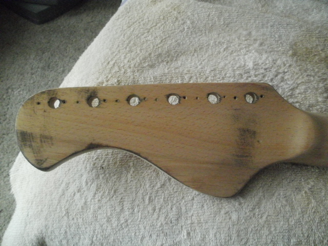

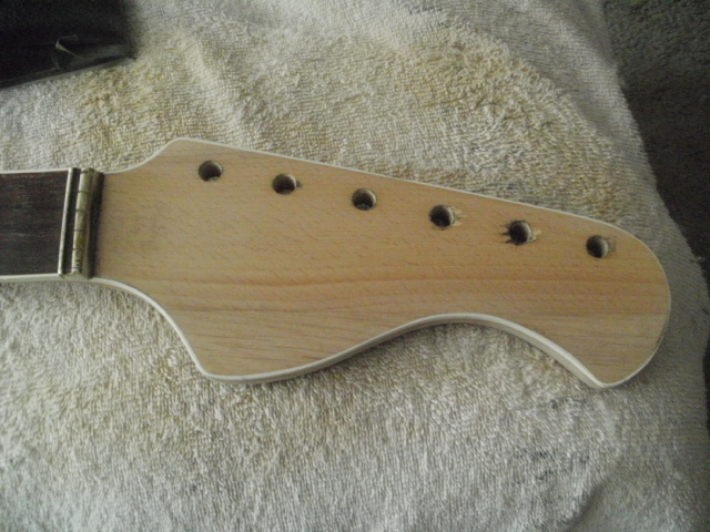

sorry for the lack of updates, which unfortunately is life in the city.

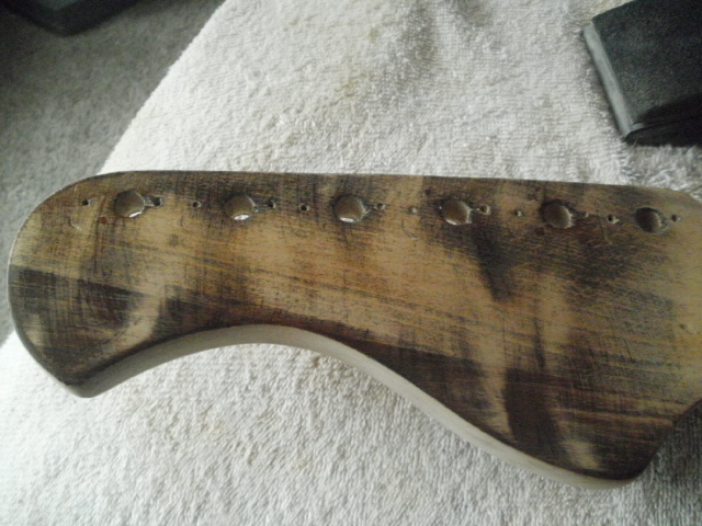

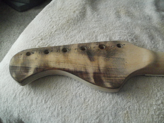

I've done some more sanding on the Musima neck. the front of the headstock is done.
the back of the headstock after a bit of sanding with 220 and the sanding block.
in the close-up you can see the damage done to the wood by the rotary sander.
another hour and a half with the block on the back of the headstock and it's almost done...it needs to be flattened more, though. there's an annoying high spot about an inch above the volute (the large bump at the bottom of the headstock). you can see the dark,low spots that are still retaining the old finish at the level of the low string tuner and out at the tip of the headstock.
next: dowelling the Hopf's NINE neck bolt holes of various vintages, and prepping the Hofner neck to mount on the Hopf body.

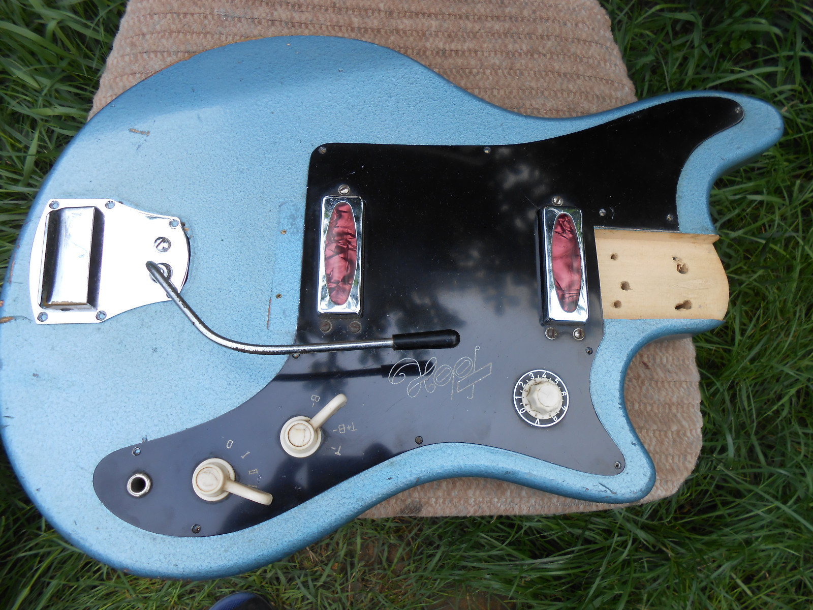

- dubkitty
- Posts: 14854
Re: Dub's Wacky German Project Guitars Thread
your wish is my command:
this isn't the exact one, but it's the same model from a different seller. it's the only trem for them i could find which wasn't either a cheap Bigsby type or a post-Jazzmaster trem whoch would require additional routing. i'm really looking forward to seeing how it works.

- dubkitty
- Posts: 14854
"TEISCO + KAY + KAWAI + SPRING TREMOLO 1960s - NOS in the plastic!" on eBay; the seller is jboz310. he appears to have a stock of them, posting a new listing about once a week and/or when one sells. if you feel patient you can bid starting at USD$45, but after missing out bidding on two of them i decided to pay the Buy It Now of $65. with that great honking long handle i'm hoping it'll be good for the Kevin Shields hold-the-bar-and-strum chordal wobble.

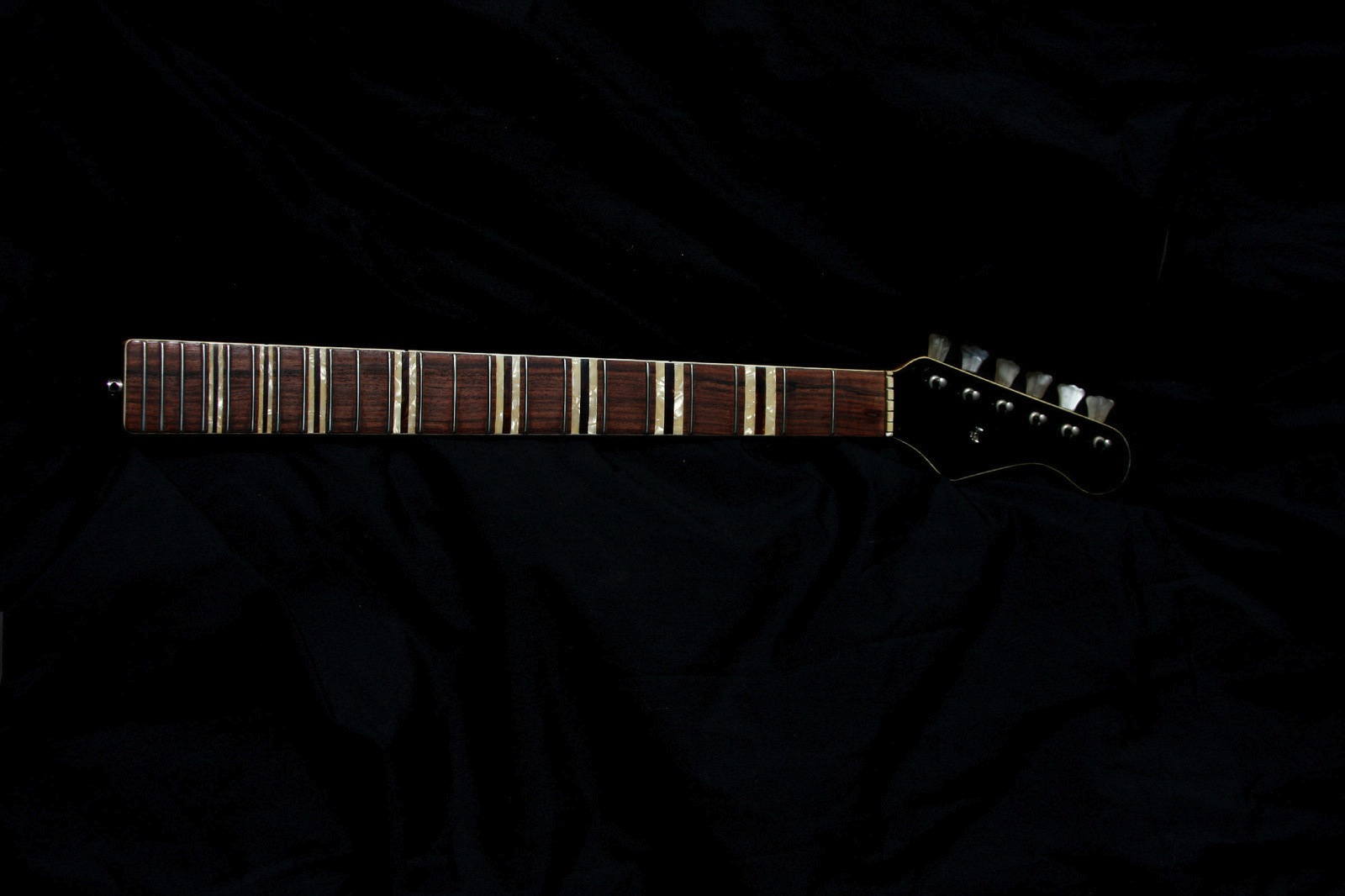

- dubkitty
- Posts: 14854

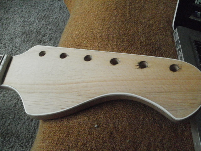

i got through sanding the Musima neck with 400 and 600 grit sandpaper yesterday. as the wood becomes more polished, there's a lovely birdseye figure in the headstock that makes me think that i'd rather stain and finish it with the grain visible on the headstock than use the plastic facing with logo. i'll still get my guy to make one for the other neck, which will go on the teal-colored guitar...for this neck i can get him to make a decal for the logo. the figure is a little difficult to see, but the sunlight brings it out.

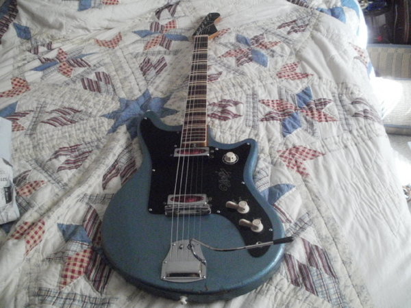

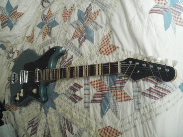

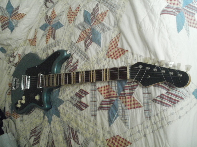

- dubkitty

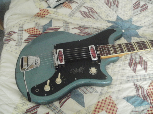

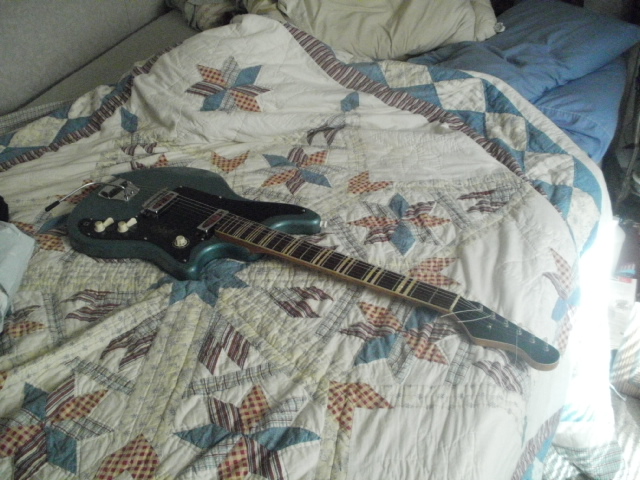

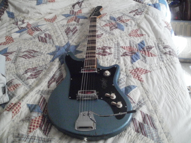

- Posts: 14854
