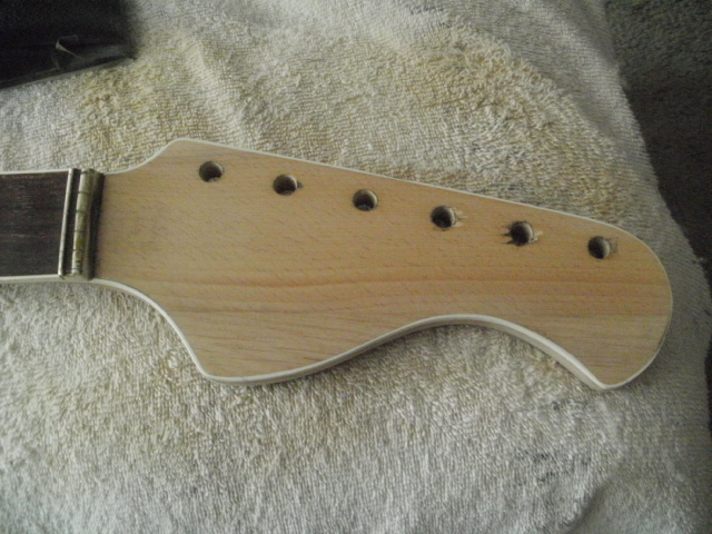

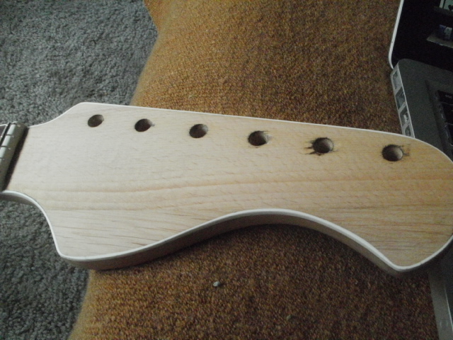

I've done some more sanding on the Musima neck. the front of the headstock is done.
the back of the headstock after a bit of sanding with 220 and the sanding block.
in the close-up you can see the damage done to the wood by the rotary sander.
another hour and a half with the block on the back of the headstock and it's almost done...it needs to be flattened more, though. there's an annoying high spot about an inch above the volute (the large bump at the bottom of the headstock). you can see the dark,low spots that are still retaining the old finish at the level of the low string tuner and out at the tip of the headstock.

i got through sanding the Musima neck with 400 and 600 grit sandpaper yesterday. as the wood becomes more polished, there's a lovely birdseye figure in the headstock that makes me think that i'd rather stain and finish it with the grain visible on the headstock than use the plastic facing with logo. i'll still get my guy to make one for the other neck, which will go on the teal-colored guitar...for this neck i can get him to make a decal for the logo. the figure is a little difficult to see, but the sunlight brings it out.

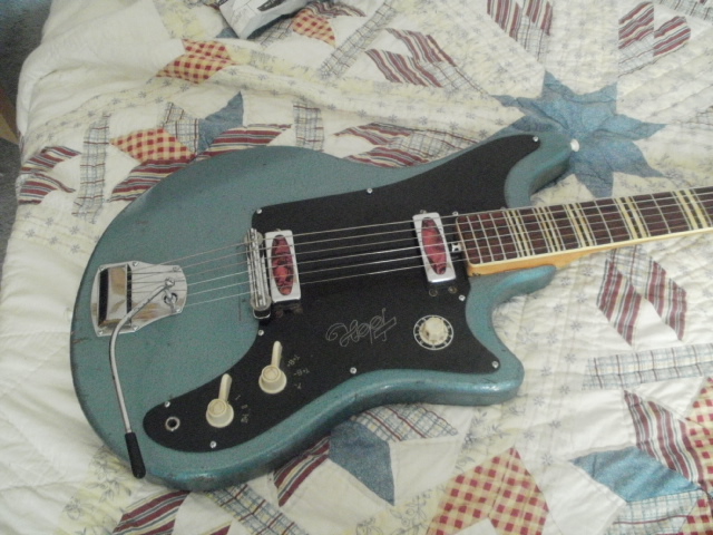

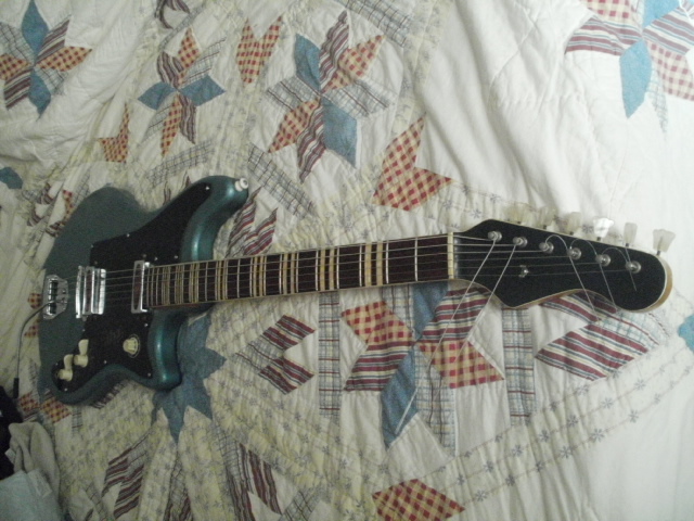

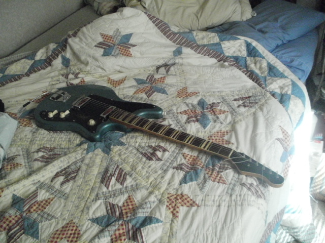

in the meanwhile, i've been working on the Hopf/Hofner hybrid, and it's done except that i have to put a Tunomatic on it so it'll intonate. i started with the body:
and the neck:
note the seven bolt holes in the neck pocket. i filled these with dowels and cyanoacrylate, and then redrilled the holes to the pattern of a Fender-type neck plate; the neck heel already had this pattern of holes along with the 6-bolt Hofner plate pattern.
Posts: 14332
Re: Dub's Wacky German Project Guitars Thread
i took apart the tremolo and figured out how to set it up...it's roughly similar to a Jazzmaster trem with a collet and cotter pin to hold the handle in place. i also tightened up the tuners. the Bigsby bridge i intended to use won't work because the scale length is off, and i'll be installing a Gotoh long-travel Tunomatic on old-school threaded posts, which will fit right up against the edge of the pickguard. other than that it's done. after shimming the front of the pocket it plays without buzzing all the way up the neck, though the frets could use a good dressing.
