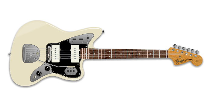

They're Jazzmaster style pickups that don't require routing the body of a jag.
http://curtisnovak.com/pickups/JMx-Jag.shtml
Mocked up the look on OSG and I think it's gonna be tittayzzzzzzz
between that and adding the staytrem it's gonna be sick as balls. What I think the Jagmaster should have been. Jag body and neck, jazz pickups.
Curtis doesn't advertise from what I can tell but if you've a little more space from string to body (13mm) he can fit his JM-90 design (what I'm getting) or JM-180 into the bridge pup. The 90 is a hybrid Jazzmaster/P90 sound, the 180 is two 90s stacked basically.
The really cool thing (or not depending on the person) about the 180 is in lead setting on a Jaguar/Jazzmaster it's the normal JM 90 the Rhythm circuit gets replaced with the 180 by basically turning on the second bridge pickup for a nice hot signal if you want it.
I'm super stoked to get these and put them in. My white jag's always been kinda Meh from having the cheapo Japanese neck pickup and a shitty seymour duncan bucker of of some type in the bridge. I'm hoping this will become my main guit after this transformation.
