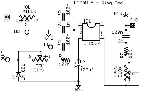

BTW, back in 2010, I did a circuit with the LMC567 (note the C), which was based on Tim Escobedo's Thing Modulator. It worked okay, and offered some noise/carrier rejection. Schematic is attached.
- Attachments
- Logan5_Schematic.png (3.47 KiB) Viewed 6776 times

Badass, I'll board this out and see how it sounds. Thanks!
