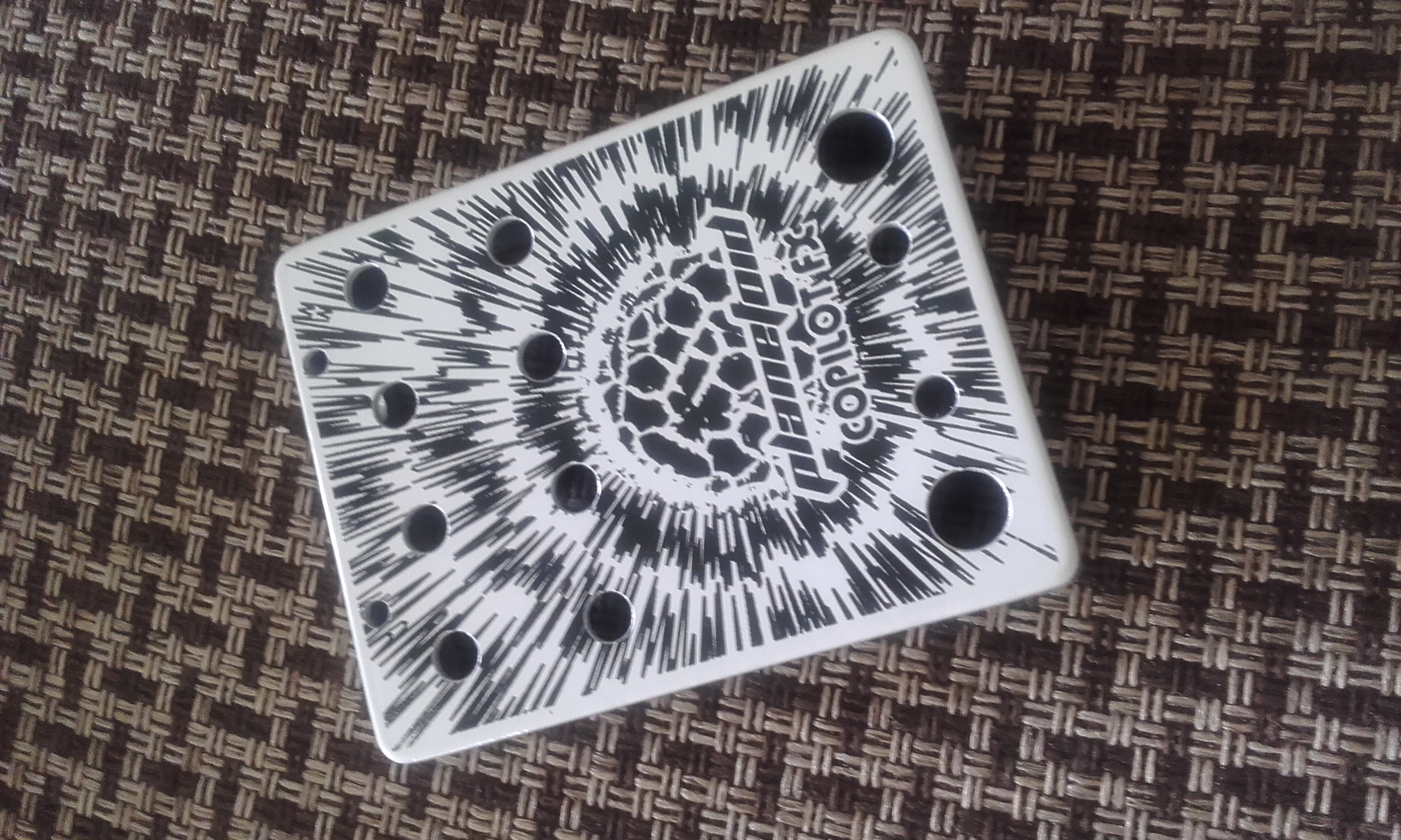

the layout

Post by autopilot »
a quick test, the only problem is that i want to add more knobs and switches. No lfo, the pseudo lfo is from the filter. It's a random chromatic loop
