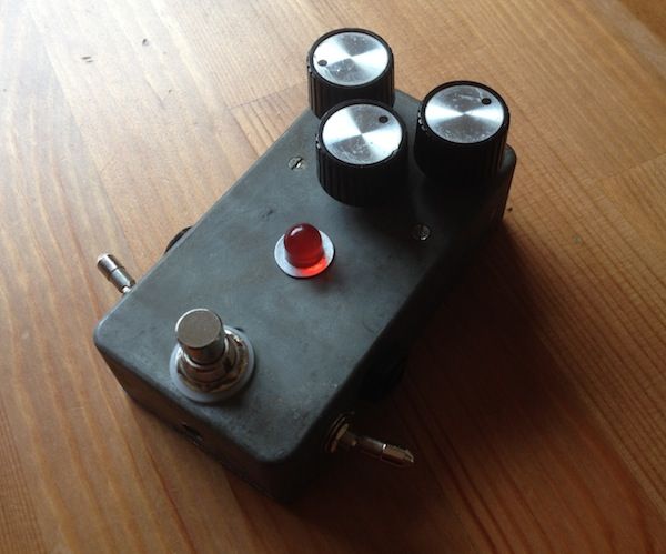

Here's the little fella finished anyway…that enclosure is from the first half of the 20th century judging from what I pulled out of it.
Knobs are pulled from a 1970s Traynor mixer and LED was a streetfind.

Ben79 wrote:that enclosure is from the first half of the 20th century judging from what I pulled out of it.
Have you a picture of the prior contents?
That's purty.
I thought about it when I gutted it but then I just hurled it all into the bin. It was a few big ceramic-looking resistors all soldered very roughly together to what looked like an RF aerial socket. I scored a whole batch of old used enclosures on Ebay for a tenner.
