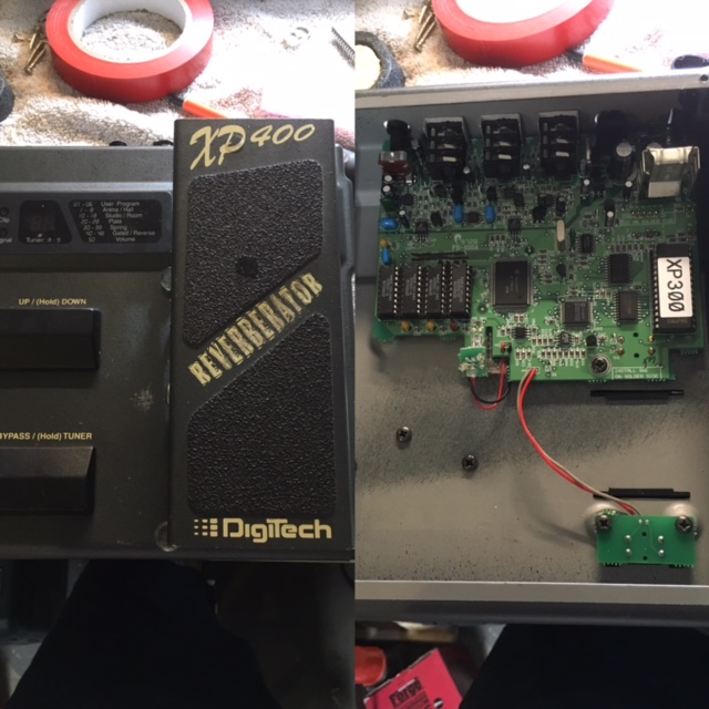

I'm in the process of converting an XP-200 Modulator into an XP-300 Space Station.
I installed 3 18-pin DIP sockets and the other 3 Tantalum caps the other day. I'm awaiting receipt of the RAM chips coming from China.
I have a burned EEPROM coming from a guy on the DIYstompbox forum. I can't wait to get this all sorted out electrically...then I'll probably strip the pedal and repaint it.
I 'll probably remove the Bypass switch and plastic actuator assembly and replace it with a real momentary switch mounted on a metal plate to cover the holes.

im in the process of tracking down the components myself for this conversion. hows it coming along? Also do you have any contact info for the guy on DIY stompboxes? ive been waiting approval to get on that forum for close to a year now and still havent been able to log in.

I finished up the mod last week. It works as advertised and sounds great. If you are converting an XP-200 like I did, you need 3 more RAM chips a programmed EEPROM and 3 10uF Tantalum caps. It's super easy to do the mod if you can solder.
I got the RAM from a seller in China. Crazy cheap, but it took 3 weeks shipping time. I got the caps from Digikey.
All of my contact with the EEPROM guy was via PM on the forum so I don't have his info. Can you try to register for the site again? Maybe with a different user ID?

I got my new momentary footswitches installed today. They work great!
Removed the plastic footswitches & Drilled new upper footswitch hole:
Unsoldered the existing switches:
Unused parts when done:
New footswitch plate:
Footswitches mounted after drilling:
Soldered Footswitch wires:
Done!

Now this is interesting! I'm always scared the switches on my XP-400 (modded to XP-1000) will crap out. What kind of switches do you need to replace the original ones? Was it an easy mod (is there enough room under the switches inside etc etc?

Obulus wrote:Now this is interesting! I'm always scared the switches on my XP-400 (modded to XP-1000) will crap out. What kind of switches do you need to replace the original ones? Was it an easy mod (is there enough room under the switches inside etc etc?
I used some very inexpensive soft-touch low-profile momentary switches.
Similar to these:
http://www.ebay.com/itm/SPST-Momentary- ... Sw54xUYlhK
There is plenty of room to install these inside the chassis. It was a relatively easy mod. You just need access to a drill or drill press, a soldering iron, and a piece of thin scrap metal. Oh and some unsoldering/soldering skills. Easy peasy.

I was finally able to log into DIY stompboxes forum! sent the guy a PM asking for a BOM of what to send him. Hopefully ill be modding my XP-400 here soon. I like the sounds on XP-200 so im gonna leave it stock

Got mine done the other day. Sounds awesome
