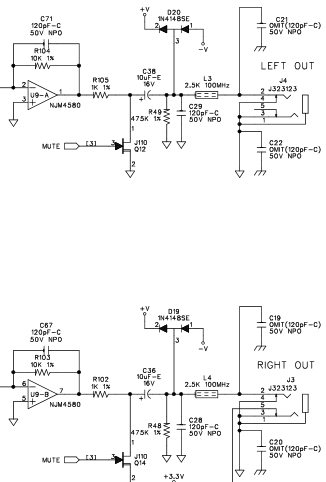

This is an idea that just crossed my mind again that I haven't thought about in a while. Posting it here before I start doing preliminary searching.
How feasible is this? The Timebender would be perfect it weren't for the fact it's so fucking quiet. Just wondering easy it would be to put like a boost/gain stage right before the outputs.

pd~
Posts: 266
Joined: Tue Mar 22, 2016 1:04 am
Re: Installing a boost on the Digitech Timebender
Post by pd~ »
Strange Tales wrote:Bottom has allen screws (WHY?)
Industry-standard practice on stuff that isn't meant to be opened, e.g. pedals without a battery or trim pots.
I don't remember if there's enough space inside the chassis to do what you want, but here's a schematic snippet of the output:
SPOILER : show
Assuming you only want mono, removing L3 will give you the in and out pads you need.
aka leaves turn - engineer with DigiTech/DOD

I brought home a set of allen wrenches from work and of course the one wrench that is missing is the one I need :cry:
I've been pondering if I should move it to mono myself. I'm thinking if I can swing it, I might put two side by side for both outputs and just set the internal trimmer to a spot that I can leave it. I still have to open it first though.
Thanks for the schematic dude!
