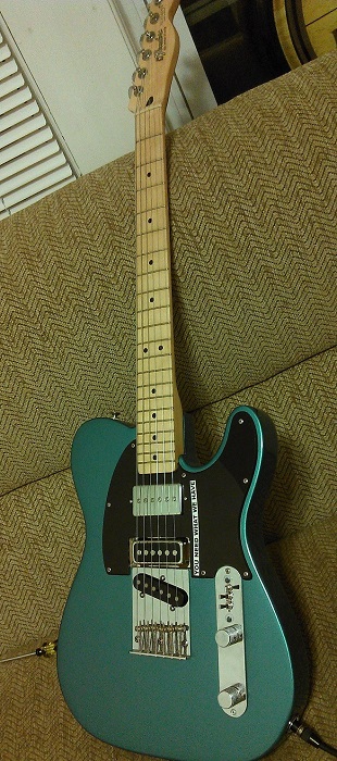

Re: Direct-Through Wiring
Post by imJonWain »
my parts tele....I have individual toggles for each pickup on/off and a tone/vol bypass toggle (not in this picture) i put between the tone and volume knobs. I love it, brightens up the other 2 pickups and makes the bridge even sharper. I also can just turn the volume all the way down and use the bypass switch as a sorta stutter/kill if I want.
Partscaster_2 DoneSMALL.jpg (129.28 KiB) Viewed 3163 times
