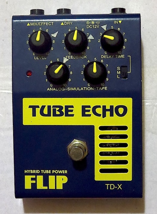

Good shit! the flip td-x is my all time favourite delay, and it gets no love!
If you have any thoughts on how I can mod it for tails I'd love to hear them!

Boxbie wrote:Good shit! the flip td-x is my all time favourite delay, and it gets no love!
Would need the schematic for that. I believe that someone at diysb has one though, maybe we'll be able to get it traced as some point.

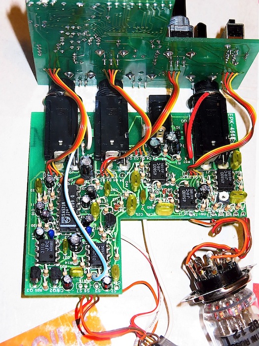

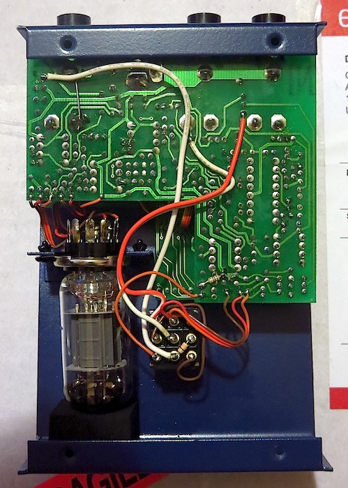

Alright, I think this is too complicated to ever clone, but I'd still like tails!
PM me if you want hi res photos of any of these.

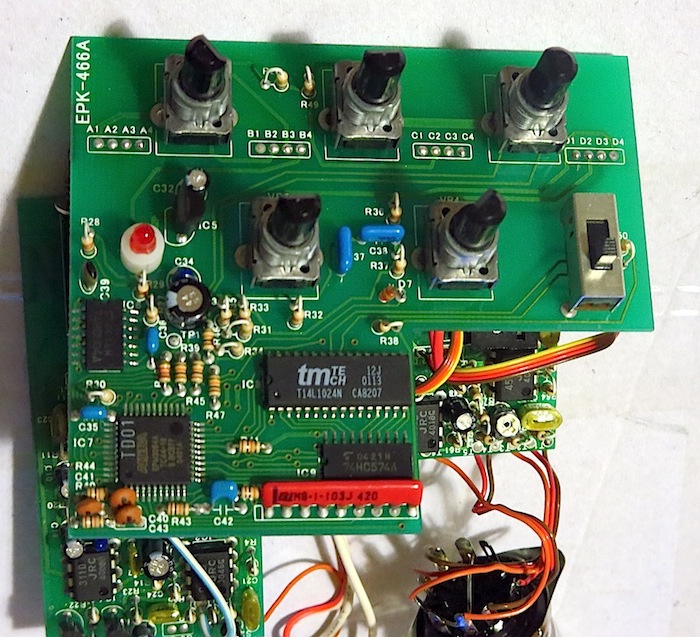

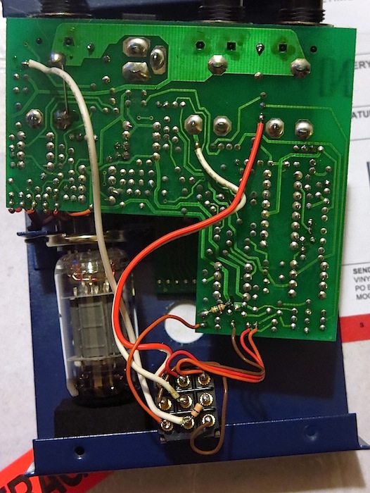

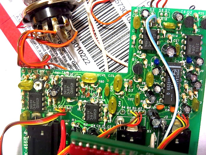

Post by Boxbie »
And a few more…
