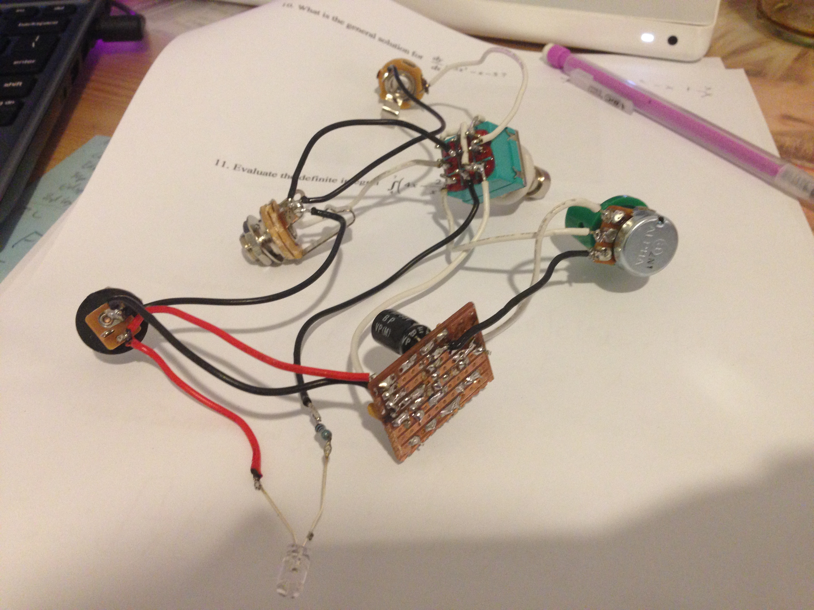

I built the DAM meatheadl fuzz (from the 1 knob fuzz bonanza on tagboard effects). It's sounding great, but when I roll off the volume on my guitar, it has this really loud high pitched noise. What do you guys think is wrong? There's seriously no problem until the guitar volume is ALL the way down. It's not gradual at all. Did I fry a transistor?

My bad,
Here's the circuit... quite messy, but it isn't shorting anywhere as far as I can see.
What worries me is that the circuit sounds fine when the volume is up, honestly it sounds perfectly fine.
but when i roll down the guitar vol it gets depressing

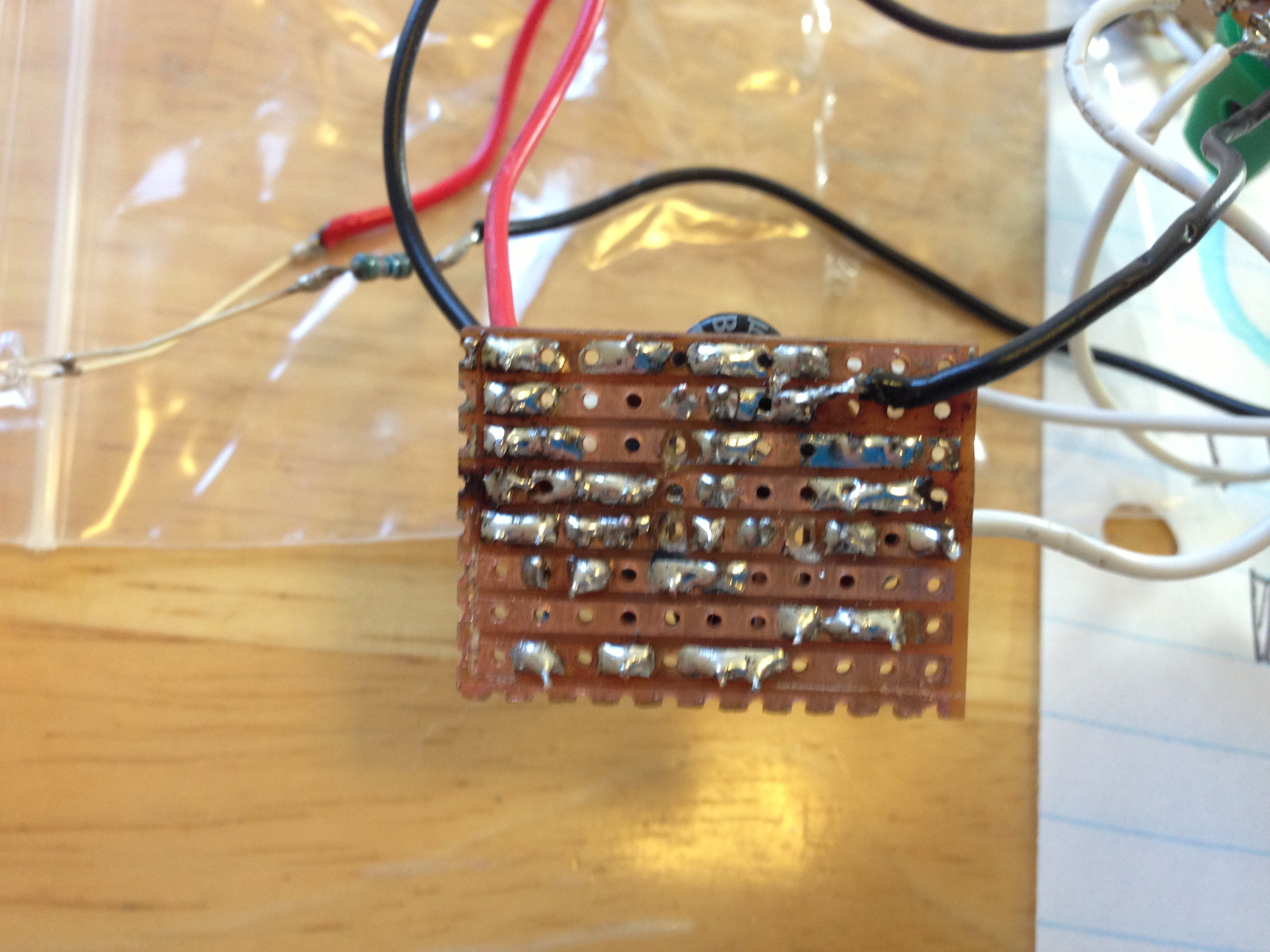

using the 'battleship' numbering scheme for that perf picture (1-2-3 etc across, A-B-C etc down) it looks like there's a solder bridge between 7A and 7B.

it was a piece of loose solder, I removed it. and I still have the problem....

can you post pictures of the finished build? I can not troubleshoot it from a picture of the circuit board that is not even in a box. aen made a good point about adding a cap between two stages that are out of phase to create negative feedback. but before we even go there, I want to understand the problem you are experiencing in detail. an audio recording of the noise would also help.

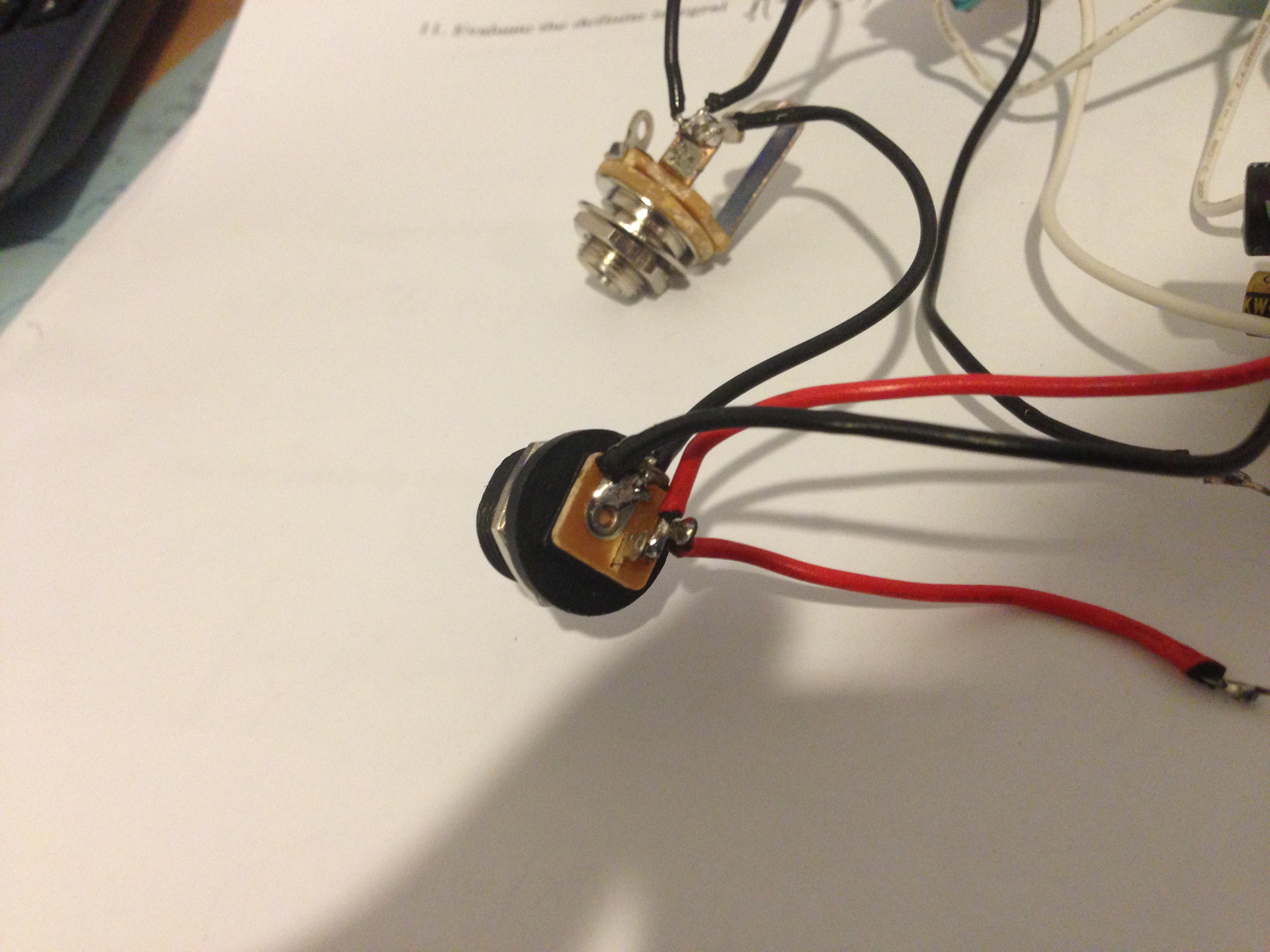

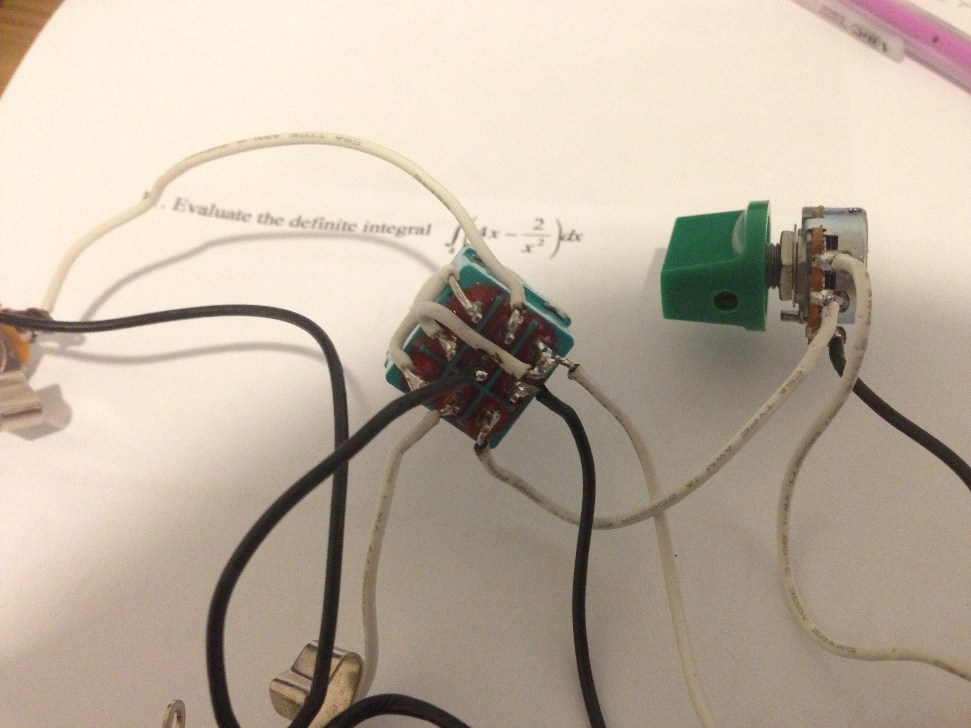

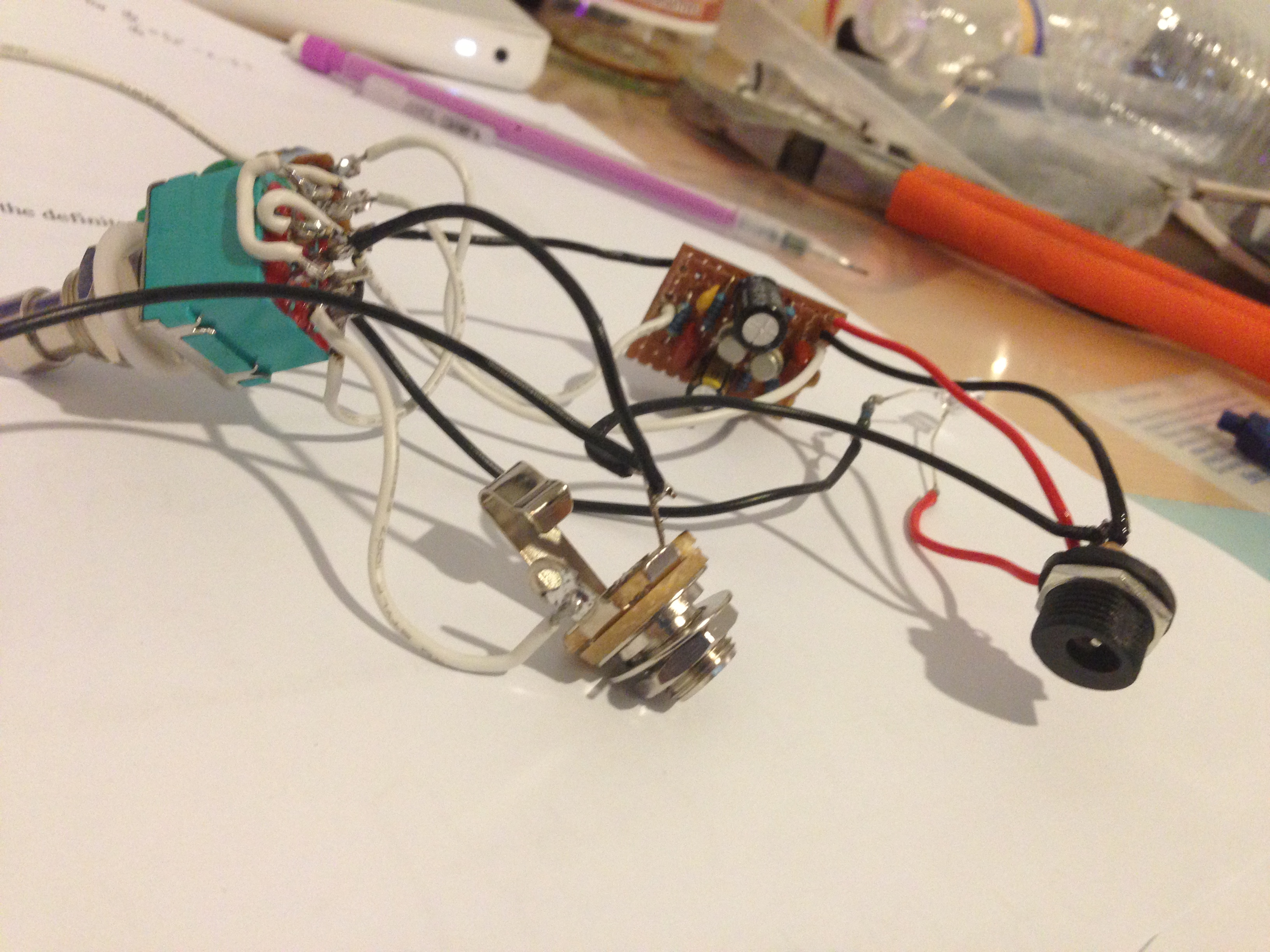

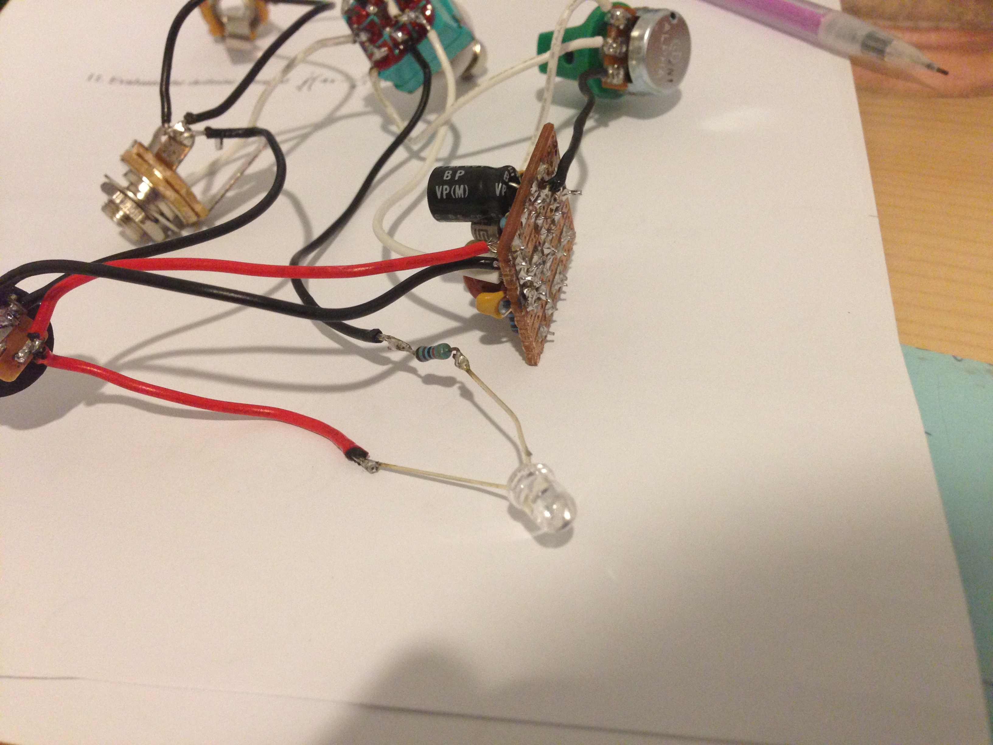

Here are some more pics of the circuit. Ignore the calculus homework in the back.
