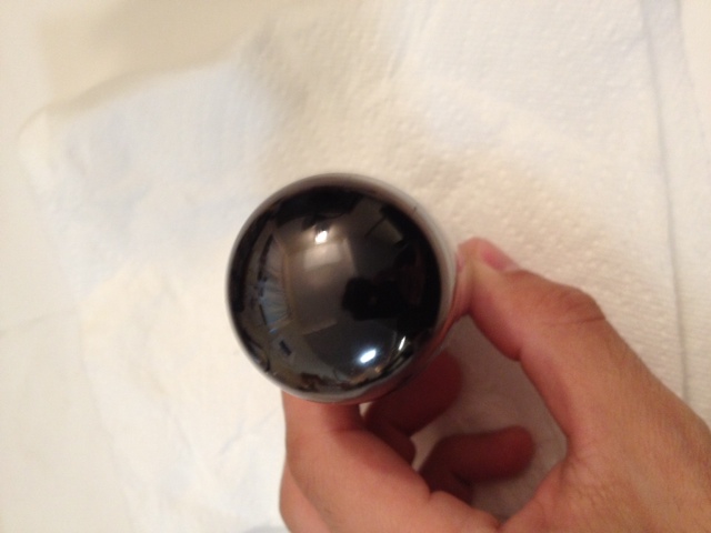

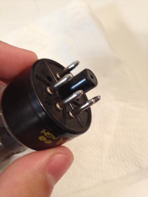

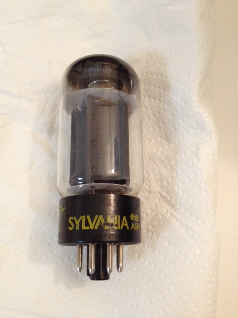

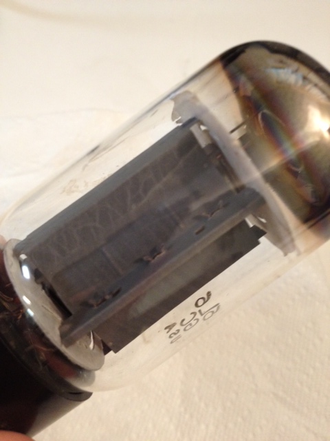

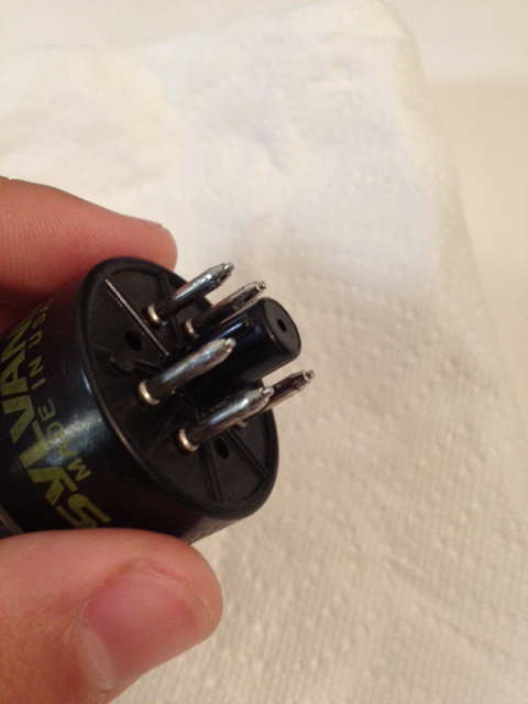

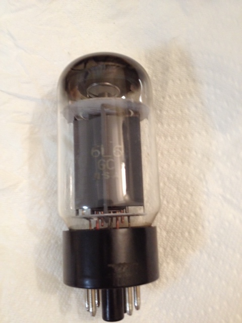

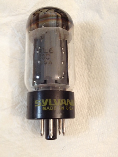

I'll take soem pictures of the tubes so you guys can take a look at them, I'm assuming their the originals, that being said they're 45 years old.

Here are pictures of the left 6l6:

Re: 1968 Silver Face Fender Bandmaster fix
Is the fuse good?
The power tubes being bad wouldn't effect the pre-amp tubes or the power indicator lamp; something would still start glowing when you turn on the power. You said nothing at all works, right? I think it's some kind of power problem, since nothing happens.
If you check the fuse and check your wiring, and it still doesn't work, I don't know that there's much else you can do without more know-how and equipment. The power transformer might not be working, but I'm no tech; it could be a lot of things. I think you need a tech to figure out what is wrong with it, at this point. Someone can get in there and tell you exactly what's wrong. You don't want to start buying replacement parts without knowing for sure what the problem is.
Maybe you could look up an amp tech near you, with a good reputation, and ask them if they could have a look and give you a quote for what the repairs would cost (and tell you what is wrong, too). I'm sure you'd have to pay for this diagnosis, but not a lot, I don't think; I don't think it would take very long.
Since you've turned the amp on, remember not to put your hands inside the amp without draining the filter capacitors again.
Those are some pretty sweet old tubes. I don't know if you can tell whether they work just by looking at them. You could try them in an amp you know works, to see, I guess.
