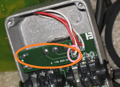

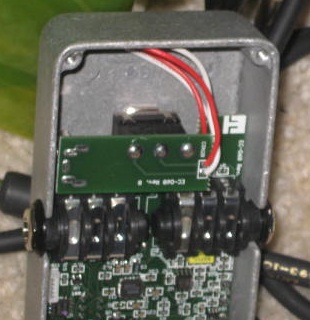

Here are a couple pics of mine. I didn't remove the switch but I have a pic of another one removed down below from the page I linked above..
And here is one of it removed from the link I posted above:

Well, to follow up on this..., I got a new switch from Ryan (Dr. Scientist) on Friday... thanks again! It is now installed and works perfectly. Exactly the change I was hoping for. No more clicking when I engage the Freeze. And, it probably only took about 5 minutes from the point where I started unscrewing the base, de-soldered the old switch, soldered the wires to the new switch and I had it all put back together and on my board.
