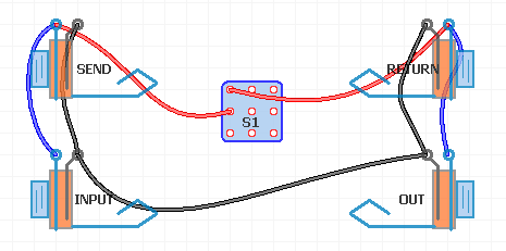

I want to build a feedback looper just for making noise and drone music so I want it to be really simple. no led, just a knob and switch.

the ones on beavis audio or more complex. just need something like the chk chk boom but latching

like this
- Attachments
- SIMPLEFBACK.GIF (9.89 KiB) Viewed 1286 times

eatyourguitar wrote:like this
Thanks for this post. I just wired it up and housed it in a cardboard box, and it looks and sounds awesome.
I found that if I set a flanger up in the loop, it turns into a weird oscillator tone machine. Not very useful right now, but I'm sure I'll figure something out to use it for.

pretty much everything that is not a delay turns into an oscillator. if you can stack a delay or flanger with some other dirt or fuzz, it gets pretty interesting.

Re: Simplest Feedback Looper?
Sorry if i'm late to the party, this may not be the simplest, but its my personal favourite:
