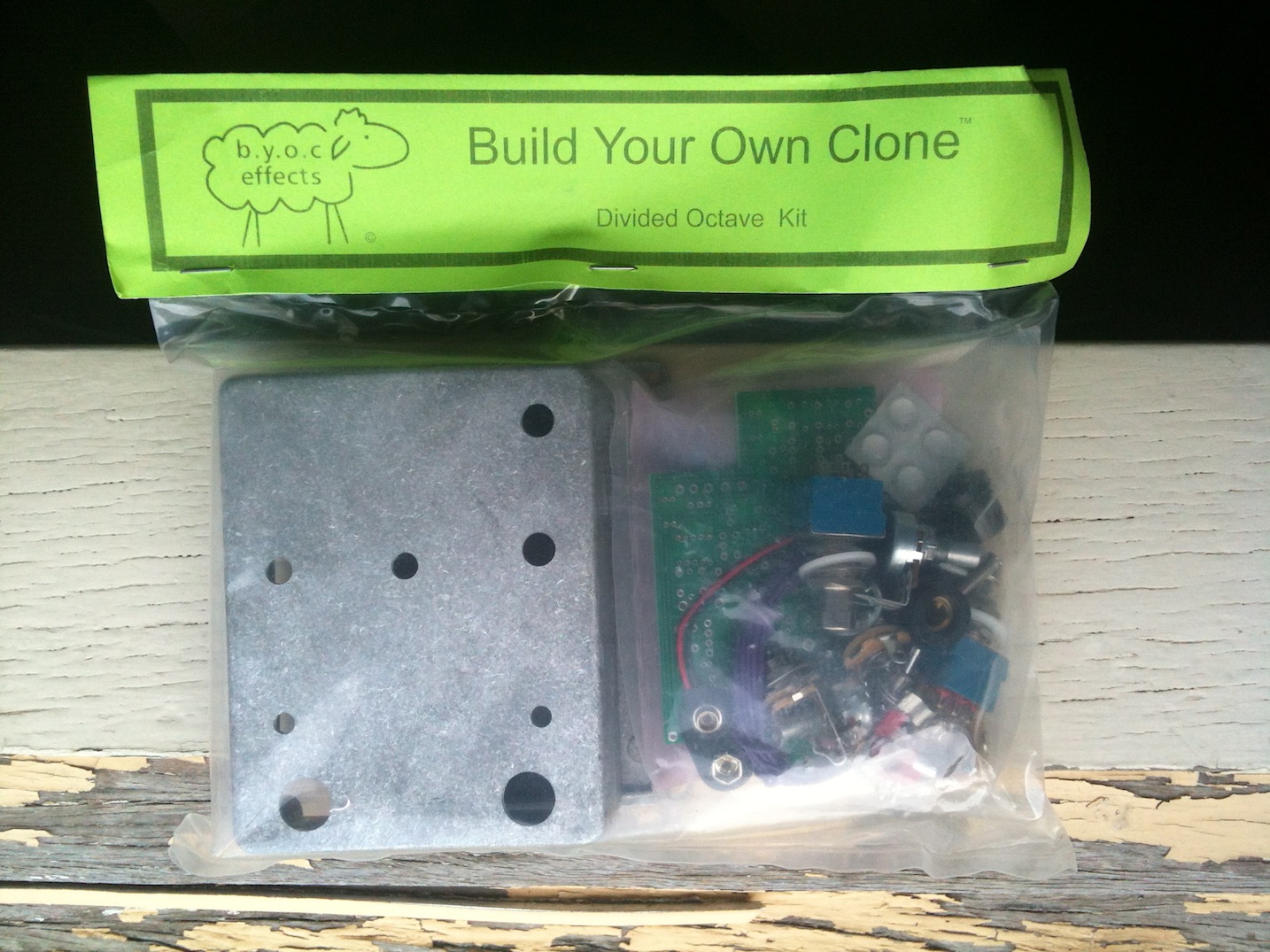

I've never built a BYOC kit before. Here's what they look like:

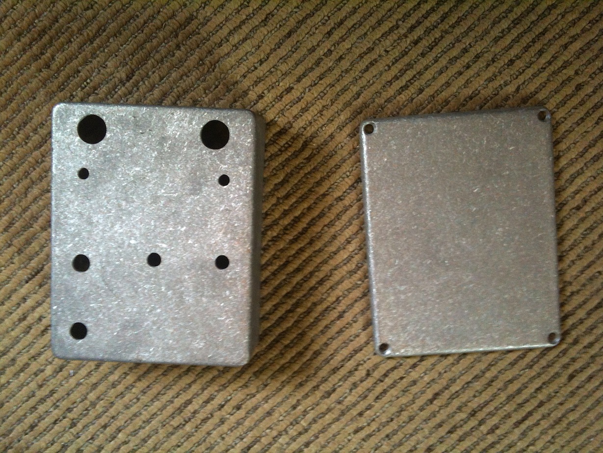

I busted open the pack and prepared to check off the components. It was at this point I realised I may have bitten off more than i can chew...
Everything was in there. One toggle switch had a leg bent, but hey, worse shit has happened.
The box was a little rougher than the boxes I'd been getting myself

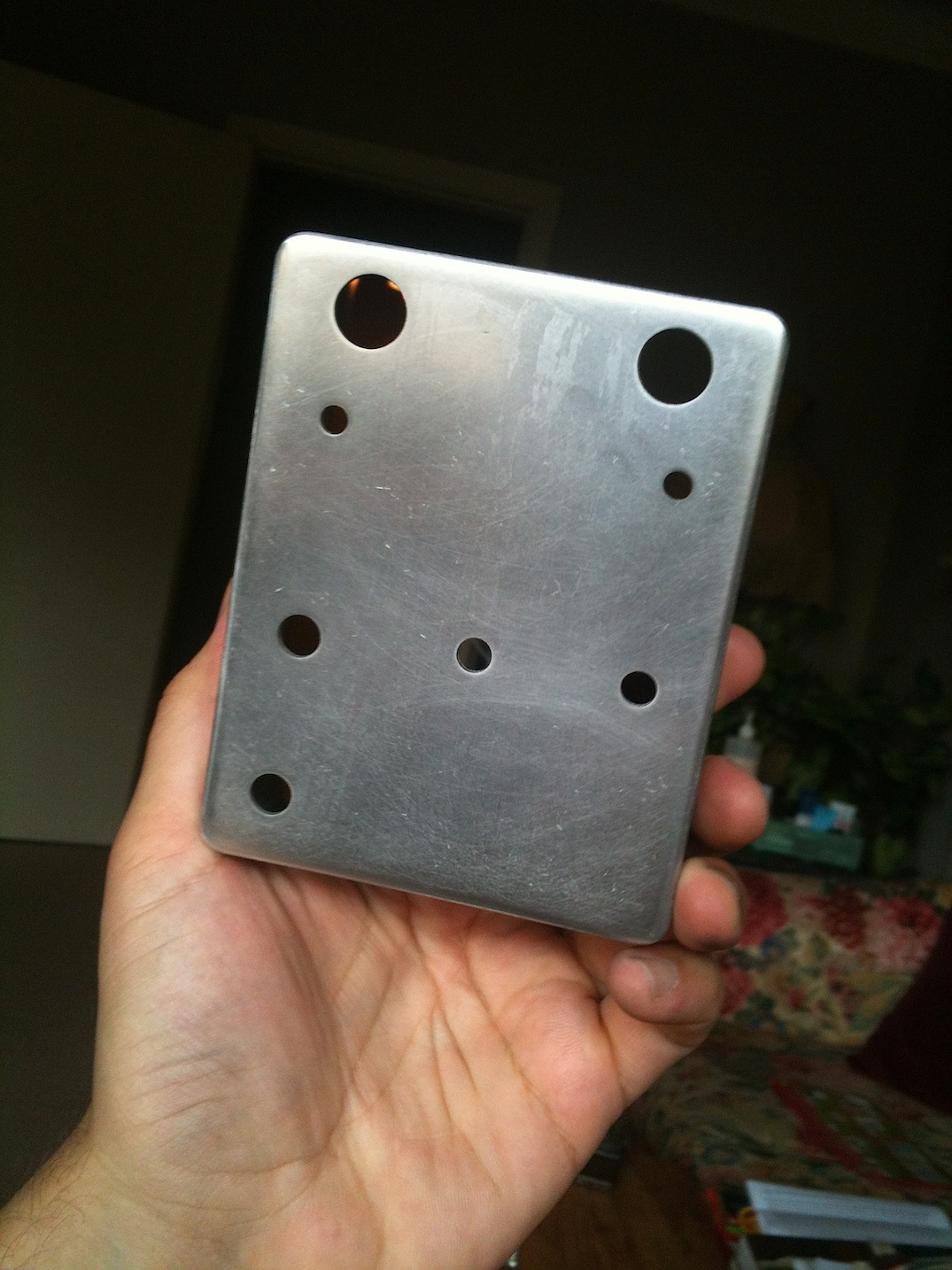

Holy shit, I didn't realise how much sanding it takes to get one of these things smooth!!!
Arrrrhg! hours of sanding with 240 and 800 grit paper and it looks like this:
I want this to look cool when its done. I haven't decided how to finish it.
I love the look of Laowiz's etchings :!!!: , so i might investigate how its done.
To be continued!!

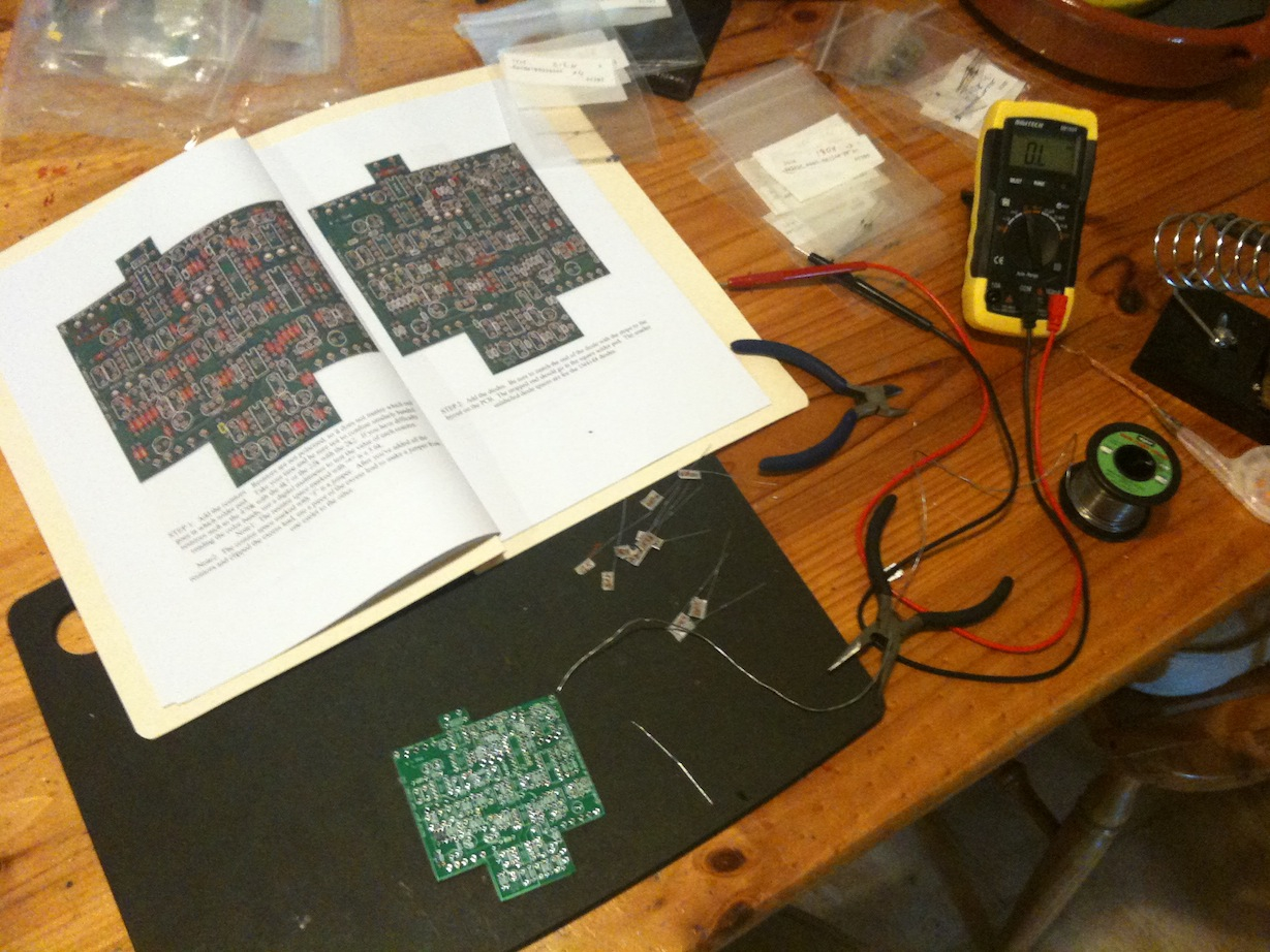

If this is your first kit take your time. A multimeter and magnifying glass will help.
Compared to most pedals there is a shit ton of off board wiring and it is extremely helpful, once you have the board completely populated, to make sure it works BEFORE you put it in the enclosure.
There are some great stickies at BYOC, DIYSB, FSB, Beavis Audio, and GGG. Check them out if you have not already.
I got my pcb for this in the post last week but I still need to source a couple things and finsh some other projects first.
Good luck.

Boxbie wrote:Holy shit, I didn't realise how much sanding it takes to get one of these things smooth!!!
To be continued!!
Hammond boxes aren't nearly as bad. 4Sites are better too. Those New Sensor boxes basically require a power sander, and even then it takes forever. If you're going to paint it, you should probably just go ahead and prime it to fill the cracks...
e
... but I guess that's for future reference.
The New Sensor ones do look cleaner when bare, though.
Good luck on the build! Didn't even know this kit existed.

Were you wet sanding or doing it dry. Usually I start off with 100, 200-300, and then a higher one of whatever I have around. 400-1000.
Boxbie
Posts: 654
Joined: Wed May 04, 2011 9:32 pm
Location: SYDNEY
Re: BYOC Octave Divider Odyssey
Post by Boxbie »
LaoWiz wrote:Were you wet sanding or doing it dry. Usually I start off with 100, 200-300, and then a higher one of whatever I have around. 400-1000.
Well, a bit of trial and error. I started off wet sanding with the 240, before twigging to dry sanding it rough with the 240 then wet sanding with 800 to get it pretty shiney.

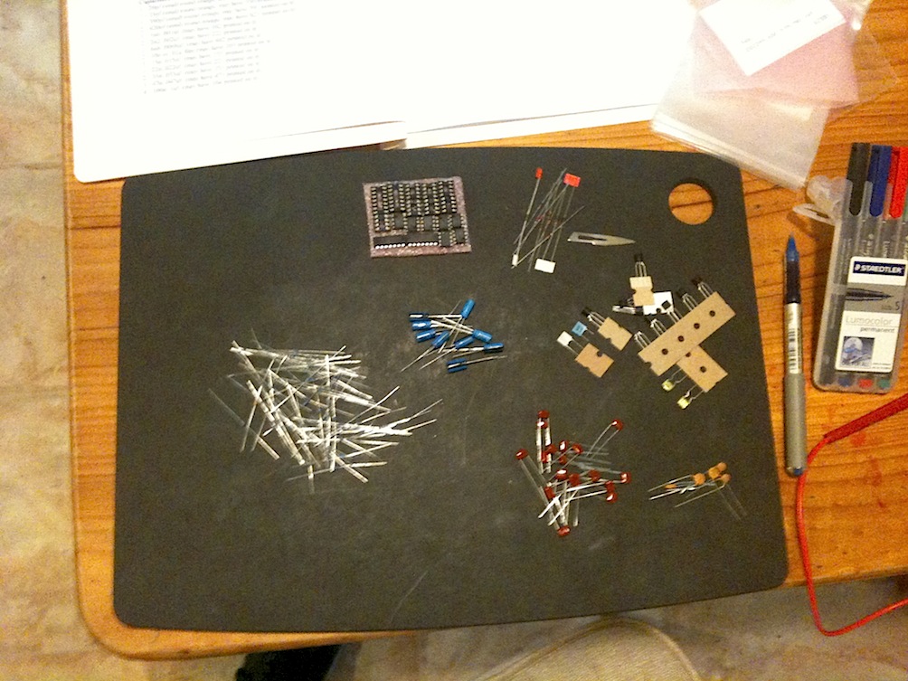

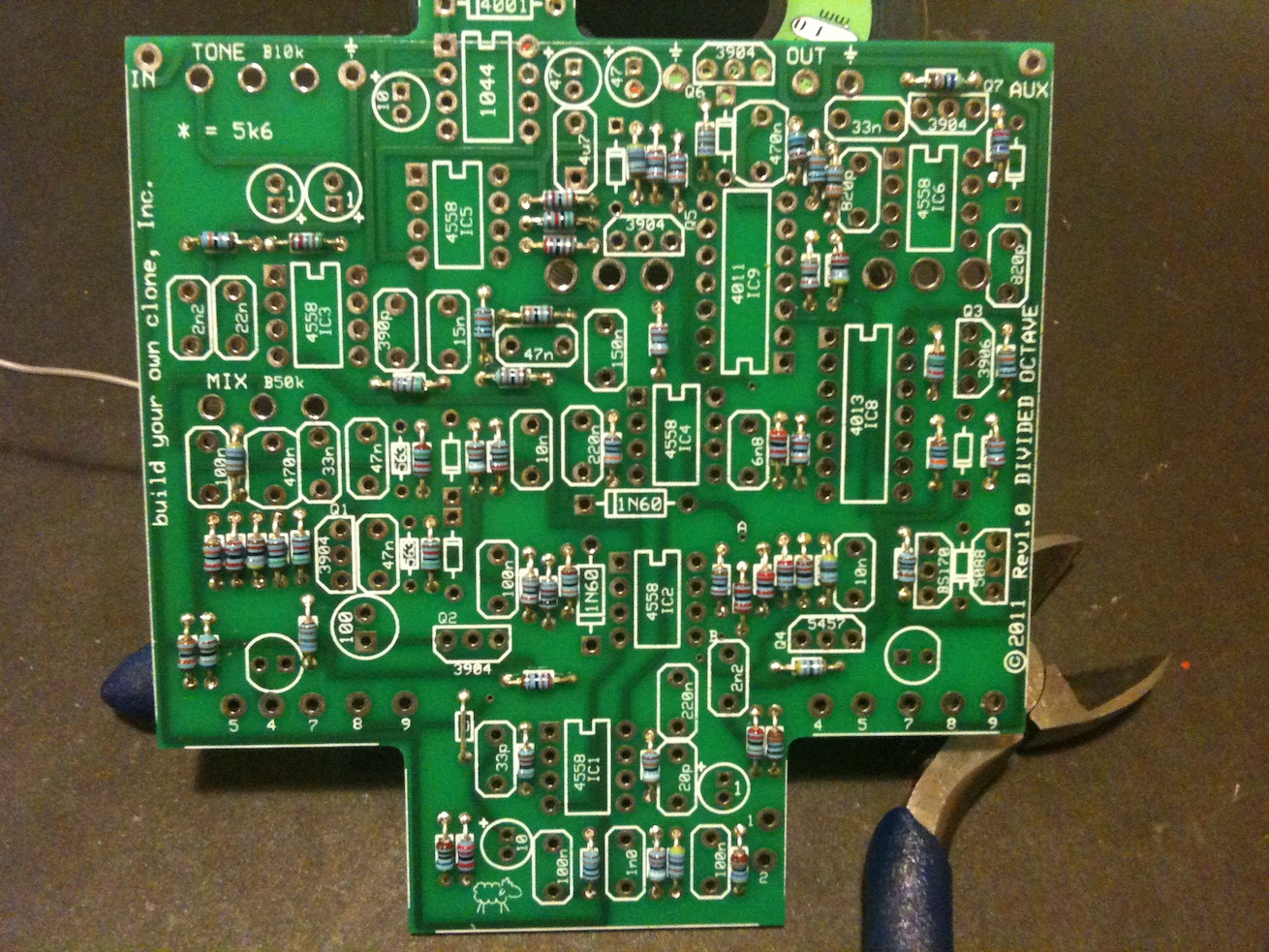

So solder time!
I started with the reisistor. There were a lot. Oh yes.
It was fiddly. I had bagged up all the componants according to value, and metered each one before soldering.
It took along time.
