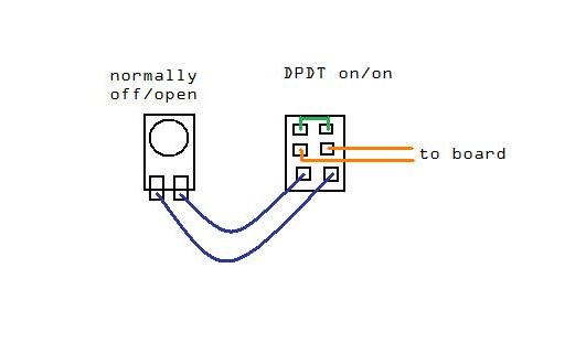

I'm trying to figure out if this switch setup will work or not. Basically, I have a momentary switch (normally open/off) that I added a toggle to. The idea is that, the toggle will either:
UP, function on
DOWN, momentary switch engaged. When pushed, function is on.
Here's the picture I drew
Momentary with hard toggle.jpg (23.14 KiB) Viewed 702 times

:thumb: yep. should work.
Re: Will this switch setup work?
Awesome! I thought it would, but switches are confusing.
