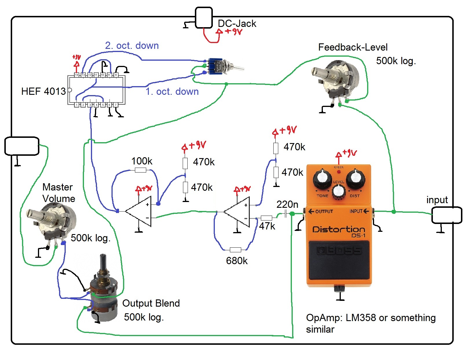

well... you could rehouse it and add a one octave down fuzz-feedback loop... I did this to a few pedals.. sounds pretty strange.. do you want teh schems?

feedbacking it with any kind of filter will get you an oscillator with a pitch tunable by the tone knob or filter. just keep tweaking your filters till you get a drone box out of it. you wont get a resonant frequency as low as 60hz till you rework the internal filters in the DS1. clipping diodes on the feedback loop could be fun too.

Schlatte wrote:well... you could rehouse it and add a one octave down fuzz-feedback loop... I did this to a few pedals.. sounds pretty strange.. do you want teh schems?
sure! :hug:

Schlatte
Posts: 2667
Location: Austria
Re: Crazy DS-1 Mods?
Post by Schlatte »
Here you go...
my idea... idk how it sounds but I imagine it being "crazy" !?
I don't know how the DS-1 fx/bypass switching works so I left the switch out of the plan.... you have to figure something out for the switching system... sorry :idk:

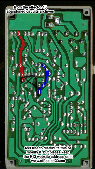

Casper Electronics has an easy and awesome mod on the site. I got the arpeggios and oscillations as well as subbass and 8-bits. One component, a switch, and wire is all ya need.
Bellyheart wrote:Casper Electronics has an easy and awesome mod on the site. I got the arpeggios and oscillations as well as subbass and 8-bits. One component, a switch, and wire is all ya need.
Is that the one where you add in a transistor?
There's also the "tremolo" mod that's posted on devi's site.
