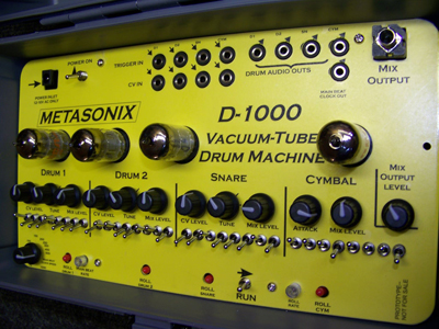

I want a drum machine with the +5V CV out so I can hook it up to my DSD2 delay. Haven't found one yet. I thought midi made it obsolete

devnulljp wrote:I want a drum machine with the +5V CV out so I can hook it up to my DSD2 delay. Haven't found one yet. I thought midi made it obsolete
Dude is it just me or is that thing sketchy as fuck it looks like every time you turn a knob you melt your knuckles.

Officer Bukowski wrote:
these are no power tubes. yes, they are warm but not f*cking hot.
