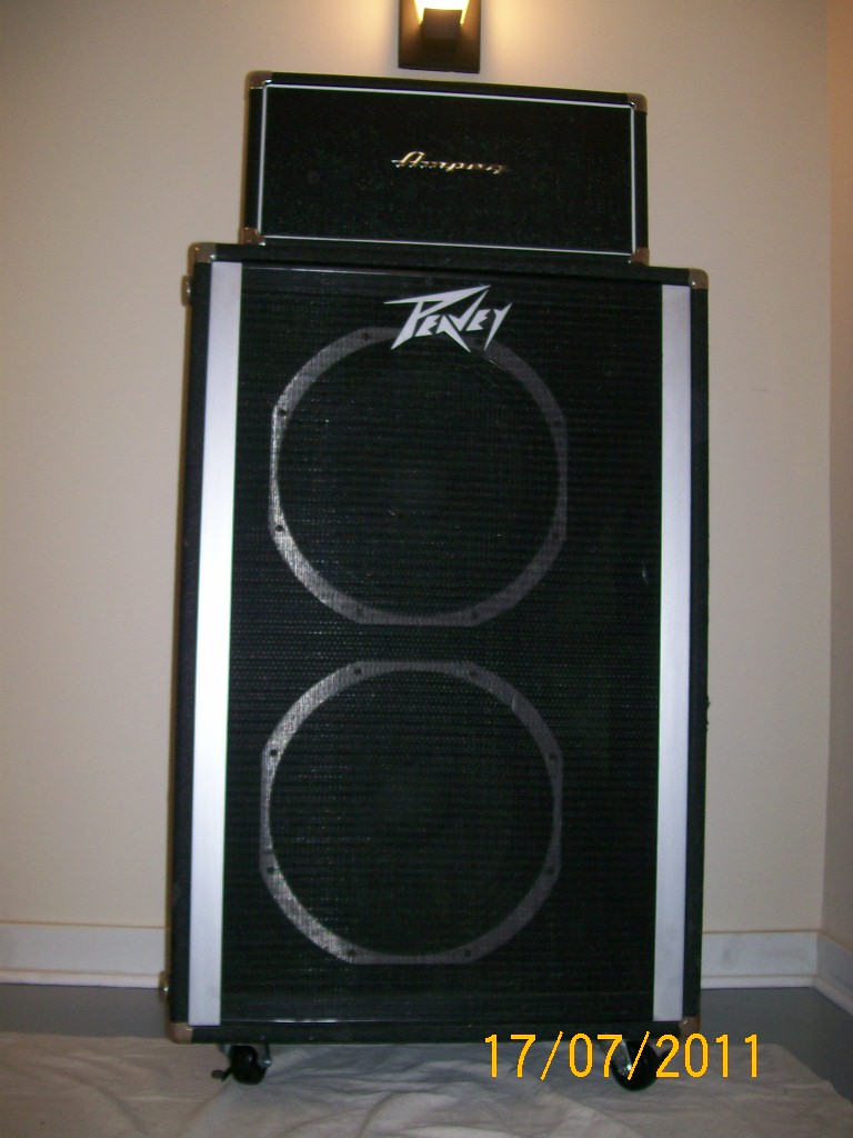

The4455
Posts: 2441
Location: Chicago, Ill
Re: Who knows about cabs?
Post by The4455 »
I actually took the amp out of teh BA-115 and put it in a head, and it's amazing. As previously stated the line out will go to a mixer for a PA and that's really all. The BA-115 is 100 watts at 4 ohms and the speaker is a 4 ohm 150 watt speaker, so if you really like the way the amp sounds I'd do as I have done and have it put in a head. Here is a pic. It's on top of my Peavey 2x15. I had the amp mounted as it would have been in the Ba-115 not like an Acoustic amplifier look.
