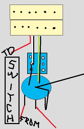

I want ahead and put a humbucker i my strat, wired it for coil split with a push-pull pot from Dimarzio. But now i realize that with the pot pushed down only one coil is active and when i pull the pot up both are active. I wanted it the other way around.
I drew a nice picture here to show you.
Please help me, what should i do?
Wiring pickguard

the black wire next to the green one is the bare ground wire.

Re: Wiring pickguard
Just switch which lug on the push/pull switch is connected to ground. It looks like it's the bottom one, so move it to the top.
But according to your diagram, the ground wire looks like it connects to the white and black wires from the pickups, which would result in one coil always being off.
You didn't say what brand of pickups you were using. The color codes are different with each brand. Because they all hate eachother.
its a dimarzio, so the wires are black, white, green, red & a bare ground wire.
I´ll try with just changing the pole on the switch that goes to ground.
thanks.
thanks.
