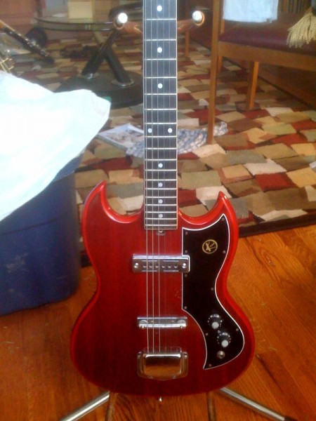

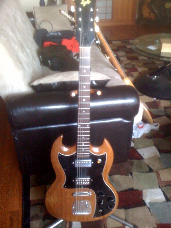

70's Lyle lawsuit SG and a 60's? Kay SGish thang.

please don't pot pickups like those. especially the one on the Kay. it'll ruin them. the microphonic quality is part of their charm. try to get farther away from the amp; i find that a 45° angle from the cabinet/speaker is good. rolling off treble on the amp also helps, especially with small amps where the tendency is to turn up the treble too high to compensate for lack of volume.

SpennyJ wrote:70's Lyle lawsuit SG and a 60's? Kay SGish thang
Ah, OK, that's your problem. Those are plywood guitars with cheap microphonic pickups and no/poor insulation & cheap wiring.
That Kay BTW, 1970s Kays catalogue. My brother had one. Cost 60 quid new (and was horrible IIRC).
I'd punt them both and buy something else rather than sink cash into trying to fix em up.

The Kay is definitely not plywood.

not that these aren't kool or anything but they aren't exactly high quality. the lyle is not a lawsuit model but rather just a cheap SG copy.
neither will ever be worth much money so you could change pick ups (but then you'll be dealing with second or third rate wood and side effects of such), dial in the amp to find the tones the guitar has in it instead of trying to get them to do something they can't.......or just flip them......

i've seen some commentary on guitar sites that pickup squeal and microphonics can be affected by the pickup(s) contacting/vibrating against the cover; a cursory Googling says that some PU makers use tape or dabs of silicone putty inside the PU covers to guard against this. this certainly sounds like it would be worth a try.

I have a pickup from the bass model of that kay (and the plywood body).
It sounds killer in the neck of my p-bass
