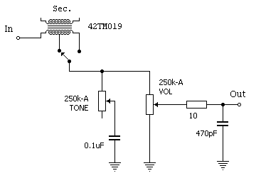

Your idea in a cheaper version: http://www.muzique.com/lab/pickups.htm

I've been scratching my head for days. I'm not sure I understand this schematic.
I'm still new to reading symbols. is that a diode on the middle tap of the coil? are diodes pretty much all the same?
on the right most lead of the inductor, what does that go to? I'm guessing that would be the +9v from the power supply?
oh and I'm probably not gonna put the extra crap that simulates the cheap guitar cable. I like the sound of low capacitance. if i do, its gonna be a smaller value cap. I'm guessing I can just build this thing into its own box with 1 Resistor 1 cap and the inductor super cheap $ :)

The arrow you see isn't a diode. It's a switch. That right lead is where the switch would connect if it was flipped the other way.
Typically, switches don't use arrows-- likely for this exact reason.
There's no +9V on this schematic. It's a passive pedal. :thumb:

I have to ask a noob question about inductors and transformers. why cant I just make a circuit with two coils? using one coil doesn't make any sense. its just a piece of wire. how does that change the impedance? I thought the only thing a single coil could do to an ac signal is phase it.

It's not just a lot of wire. When current goes through a wire, it creates a magnetic field around the wire. This field is tiny, but when the wire is coiled up, it has a chance to build up. Add in a magnetic core, and you get a significant amount of inductance-- which is energy stored as a magnetic field.
The magnetic field that's in the conductor (wire) resists change in current, which is why it behaves differently than just a long length of wire.
That switch in the schematic switches from a humbucking to single coil amount of inductance. The other half of the transformer is left out because you don't need it.
Realistically, you could probably just use an inductor. I'm not sure if half a transformer and an inductor are very different. I think in this case, the transformer is just more versatile because of the center tap.

ok I get it. the iron core makes all the difference. I'm gonna order a bunch of these tomorrow. I see solidgold fx sells something like this for $120 HAHA. I'll stay DIY for life.

It works without the iron core, but the effect is much, much greater with it.
