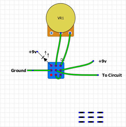

I want to built a footswitchable voltage sag with an LED into a pedal. Would this layout work? The LED may be facing the wrong way, I'm not sure, but I'm more asking about the switch wiring. Thanks

Other than the backwards LED, you're good.

McSpunckle wrote:Other than the backwards LED, you're good.
Cool, thanks. Finished building a Devi Ever Ruiner/Hyperion clone with the footswitchable voltage sag. Sounds nice! Haven't had much time to play with it today though
