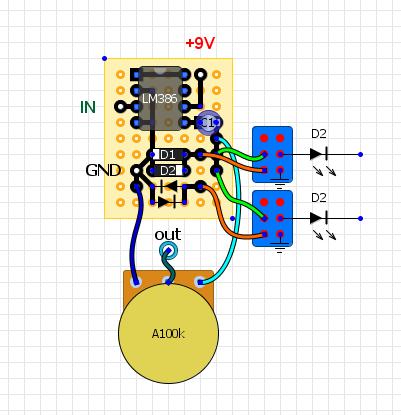

I was building a pedal using culture jams dead easy dirt schem and was was going to add two dpdt switched add the two diodes and or LEDs to the circuit or bypass both. Image
Will this work?
using that layout, when the switch is on, the diodes/LEDs will be in the circuit and the LED on, but when the switch is in the off position the LED is off and the diodes/LED is bypassed? Any input is appreciated. Thanks

that works as a simple bypass, but it won't turn the LED on.
to turn an LED on as well you need another pole on your switch

although i don't get exactly what you want to do - you want to switch out the diodes to ground at the end of the circuit? you should just switch both out at once.
and i realized... with where the diodes are placed, you could switch them in/out and light an LED with a DPDT.
like this: (the numbers correspond to the lugs on the DPDT)
1 4
2 5
3 6
1. not connected
2. to negative leg of the 2.2uf
3. to the diodes, which are connected as shown in the schem
4. not connected
5. to the cathode of the LED
6. to ground

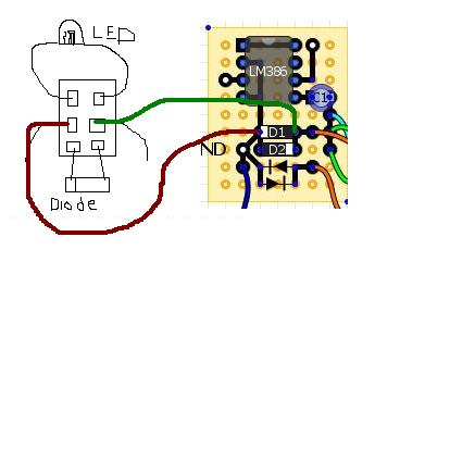

heres the layout i got, i have a bunch of leds and diodes so i figured itd be kind of cool to toss in set od leds into the circuit with another switch, this way i can experiment with diff combinations of leds and diodes, switching them on and off, and what not. is the layout right? will it work the way i have it wired up? this is my first circuit where i added something i created, i.e. the two switches, so bear with me, but hey, u learn by doing. :)

Post by Teej212 »
this should work:
edit: i think thats what your asking...

i guess what i'm trying to figure out is whether or not you want those LEDs to light up?
if so, then the layout you made will work just fine, although flip the LED around so you connect the negative leg to the switch. the positive leg goes to a 4.7k resistor (or so) which connects to 9v+.

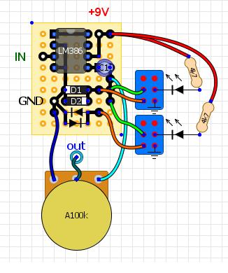

heres an updated layout

the updated layout is perfect.
i want to add as well that i think when both sets of diodes are switched in it won't really make a huge difference since the silicon has a lower clipping threshold than the LEDs. if i were doing this, i would use a center off switch so you can have LED, silicon or none on a single switch with 2 indicator LEDs.
if you think about doing it that way, you would wire it like:
14
25
36
1. to diode pair
2. to negative leg of output capacitor
3. to LED pair
4. to negative leg of one LED
5. to ground
6. to negative leg of the other LED

what if im using germanium diodes
smallsnd/bigsnd
Posts: 3981
Re: LED indicator help
Post by smallsnd/bigsnd »
people have a lot of ideas about clipping diodes, so i think the best thing for you to do is try them out and decide what you like! you can always just take them out...
