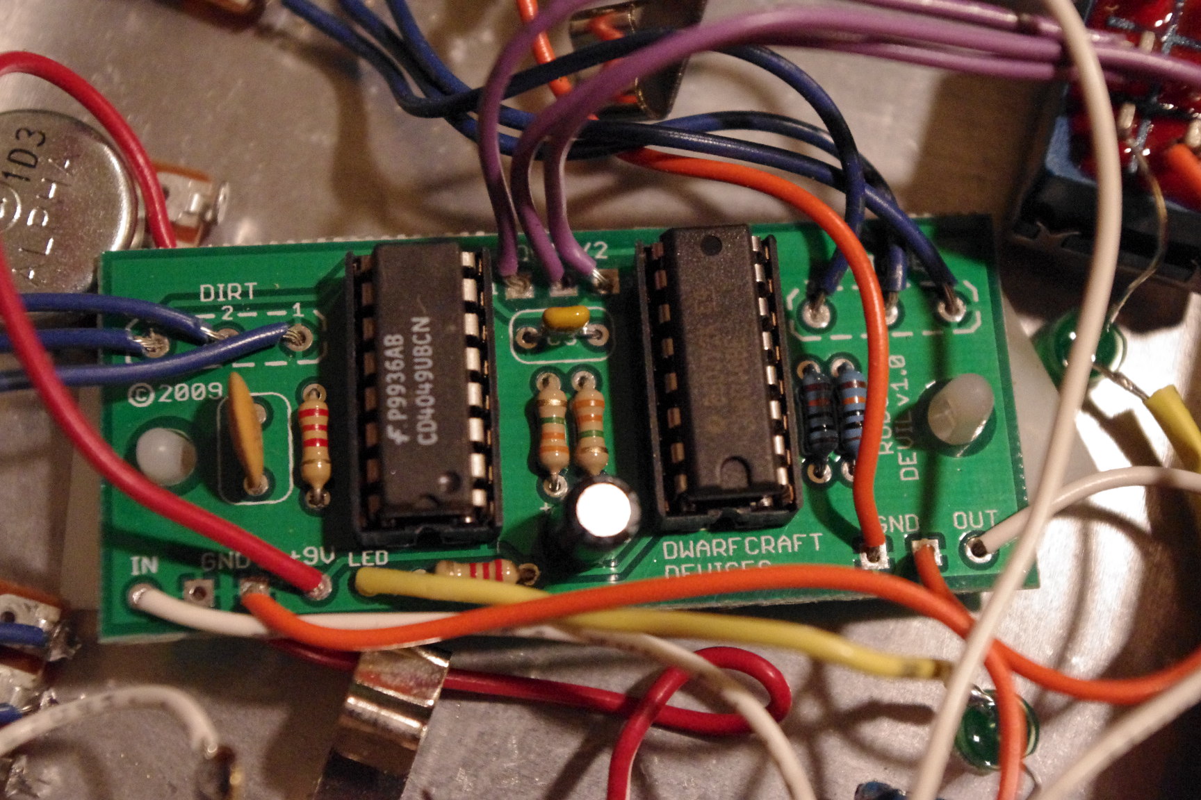

there you go. Not the prettiest guts though!

your starve pot might be touching dirt pad 3 on the pcb. I don't really know cause I cant see behind it.

eatyourguitar wrote:your starve pot might be touching dirt pad 3 on the pcb. I don't really know cause I cant see behind it.
no cause there is a standoff so the board is elevated.

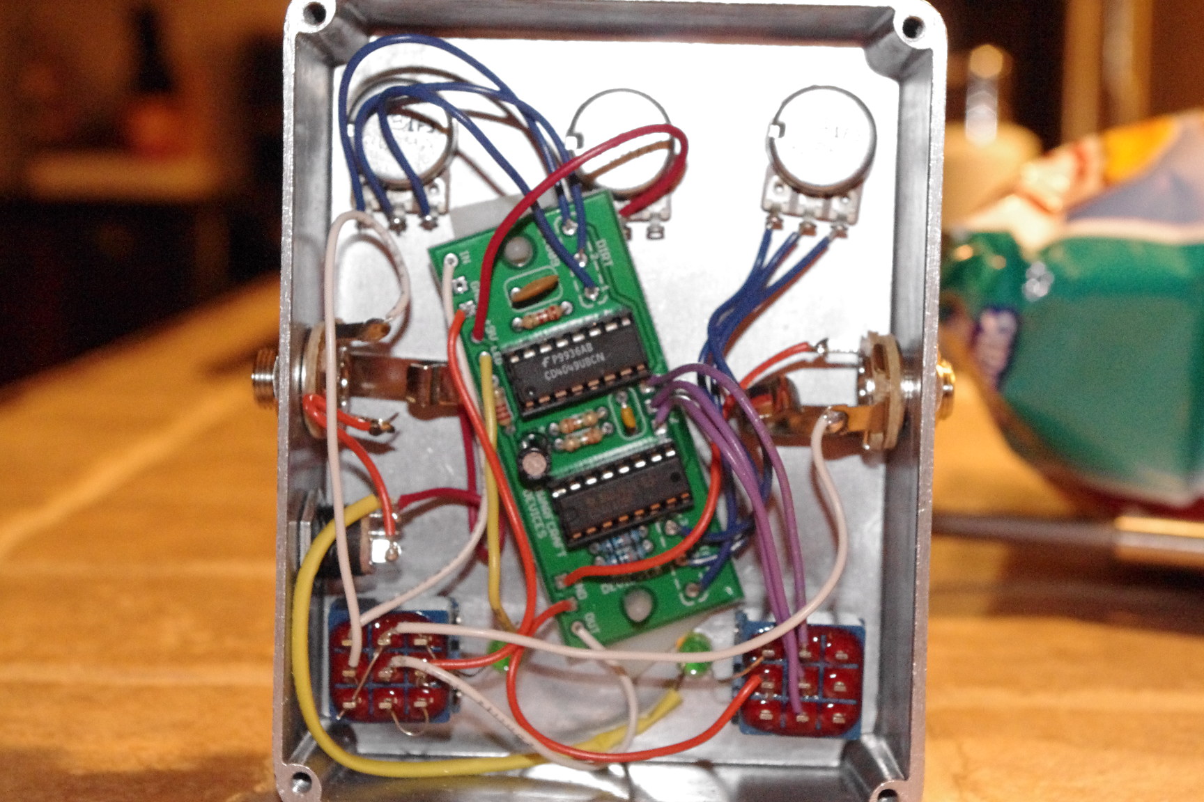

Done!! This ting is a beast!
Is it normal to get no sound when all pots are on max?

Redid everything and only one LED works with no sound. So fucking annoying. Not sure what I did wrong. Going to have to go over it very carefully. I almost want to just start completely over but the kit is 60 bucks, so it would suck to have to do that. My wiring is fucking me up though. I need a more flexible wire I think. Any good suggestions?

sp3k wrote:Done!! This ting is a beast!
It's not normal to have no sound when all the pots are at max.

I flipped the IC's...again....lol. Now I get sound but it's insane sound like my speaker is going to explode. Did I fuck something up or what? Shit!
One LED works, insane sound...yea I'm clueless. I'm going to keep trying to figure it out. I guess this is how you learn right? That was the whole point in this for me. So that's kind of cool. This trial and error shit helps.

fuzzmax wrote:
is this the right way to wire the pots? the instructions numbers the pots 123 and not 321, like you wired them. But this probably the right way, because the mine sounds insanely high, and the pots don't seam to work has they do in the videos i've saw.
I did not notice that they were indicated 1-2-3 on the plan....lol....it's like they were seen from the top and not the bottom but the right way is 3-2-1 cause in the enclosure, you see the bottom.

It's probably an error on the plan, even the pcp says 321, if it was 123 the wires would get crossed

sp3k wrote:It's probably an error on the plan, even the pcp says 321, if it was 123 the wires would get crossed
have you wired your pots backward??
