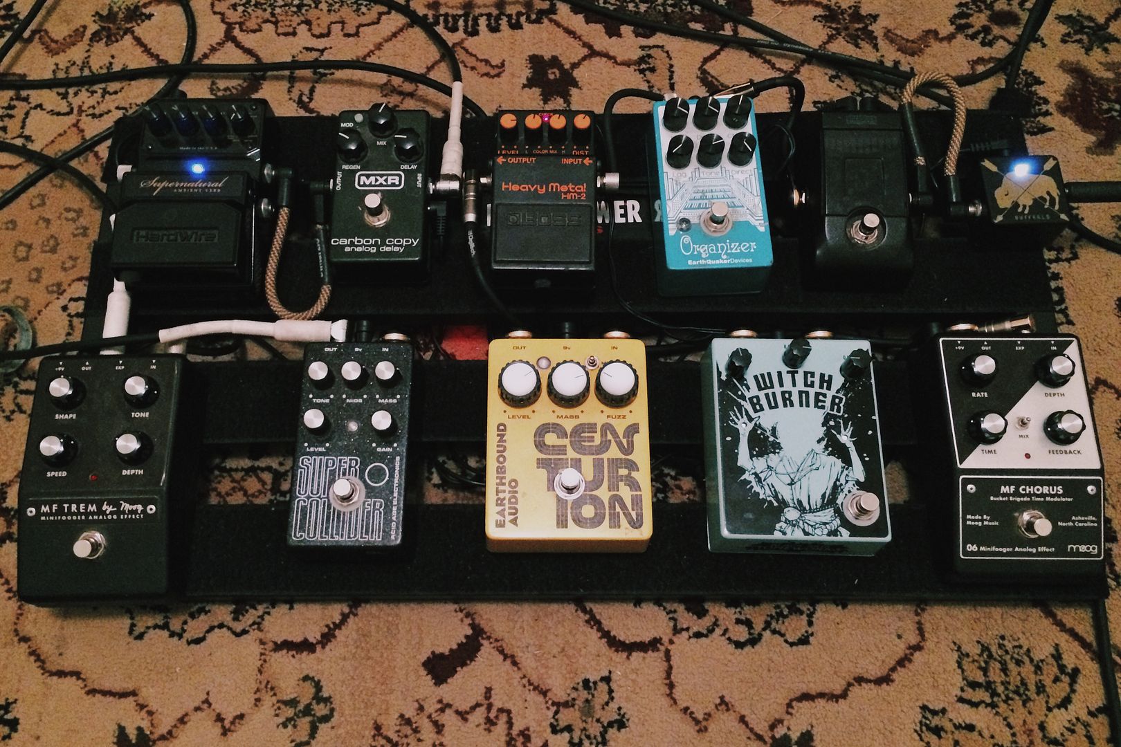

Just jammed for an hour with these two new pedals! The Witch Burner is definitely going to be a permanent addition to the board as a lead boost, fixes all my issues with a stock TS and sounds GREAT. Also managed to pick up an HM-2 on the cheap, my first experience with one. LED's kinda going in & out but it sounds gnarly as hell! Surprisingly usable too. Gotta try these out through the bass rig tomorrow!

larsbars wrote:Also managed to pick up an HM-2 on the cheap, my first experience with one. LED's kinda going in & out but it sounds gnarly as hell! Surprisingly usable too.
If you're on an isolated supply, which it sounds like, you need 12V for the HM2. That's why the LED problem. It steps the 12V down to 9V inside the pedal. Using a battery inside will fix it too, and it will sound even more HM2. :thumb:
