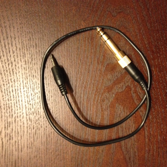

I gave this a shot. No luck so far, but I might have the wrong cable. I'm using the Volca sync cable with a 1/4" adapter.

Damn, not so simple then... Did you use a TRS adapter?
You are right about the Strymon Tap tempo circuit, it is different from the Boss one.
The Boss tap tempo is a single pole single throw switch. It is normally closed (NC) meaning the switch is “on” by default, it breaks contact when the button is pressed (0V) and makes contact when it is released (5V).
The Strymon tap tempo is a single pole double throw switch. By default a connection to ground (0V) is established, when you press the switch it makes a connection to the 5V source.
To trigger it remotely you need to use a TRS cable going from the remote tap tempo pedal to the main pedal (Flint, Mobius, Timeline). The main pedal expects 0V on the sleeve and 5V on the Ring.
The cable that ships with the Volca is a 3.5 TRS cable and apparently Volcas end up jittering or skipping steps if you use TS cables (It must ground something somewhere I guess).
Now I do not know if the way the connection is set up on the Volca side will match what the Flint is expecting. If the pulse is transmitted from the Volca on the tip, I would maybe use a floating ring cable; basically a TRS cable with tip on both sides connected to each other, sleeves on both sides connected to each other but the ring section is not connected to anything (left floating). This would prevent any grounding issues.
I wish I could test it on my end, I do not have any Strymon gear though. When I had the Volca Beats I was using the RH-301 as my main clock going into a Kenton thru-5, then going from one output to the Volca using MIDI and going from another output to the Molten Voltage CTL-Sync (MIDI>tap tempo converter), but that's a lot of gear compared to maybe finding the right cable...

I did use a TRS adapter. Actually here's the exact cable:
I'm going to give it another shot. Your info is extremely helpful, and it makes a lot of sense to me. I think this should work... I read in the Volca manual that there' some sort of sync peak switch in the global parameters. Maybe that's equivalent to the normally closed/normally open thing?
I'm going to test this again tonight and report back. If this works... oh man.
