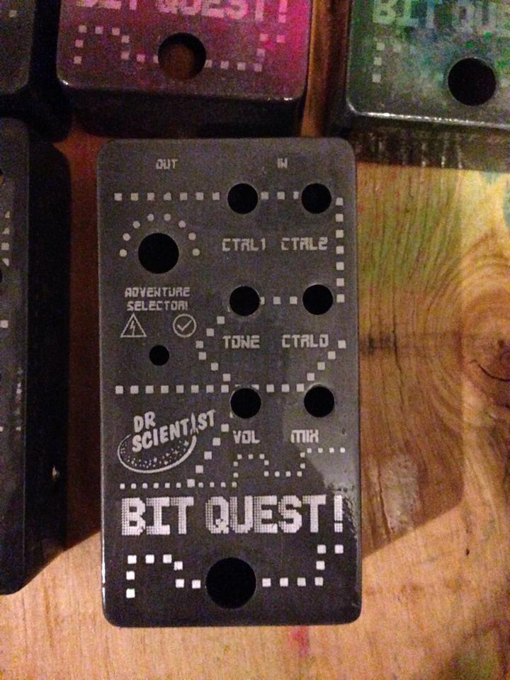

To launch the BitQuest the gents at Acid Splash Designs, the lovely and talented jwar and excane, have made 50 acid etched boxes. They get 1 each so there will be 48 available here for the pre-order.
They look like this:
(104.21 KiB) Downloaded 1828 times
Adam, correct me if I'm wrong, but the majority of them are a black/dark grey colour, right? A handful have some colour on them like green or pink or red splatter. But mostly they're grey, so plan on getting a grey one! I don't know what the knobs will be like yet, something cool, open to suggestions.
