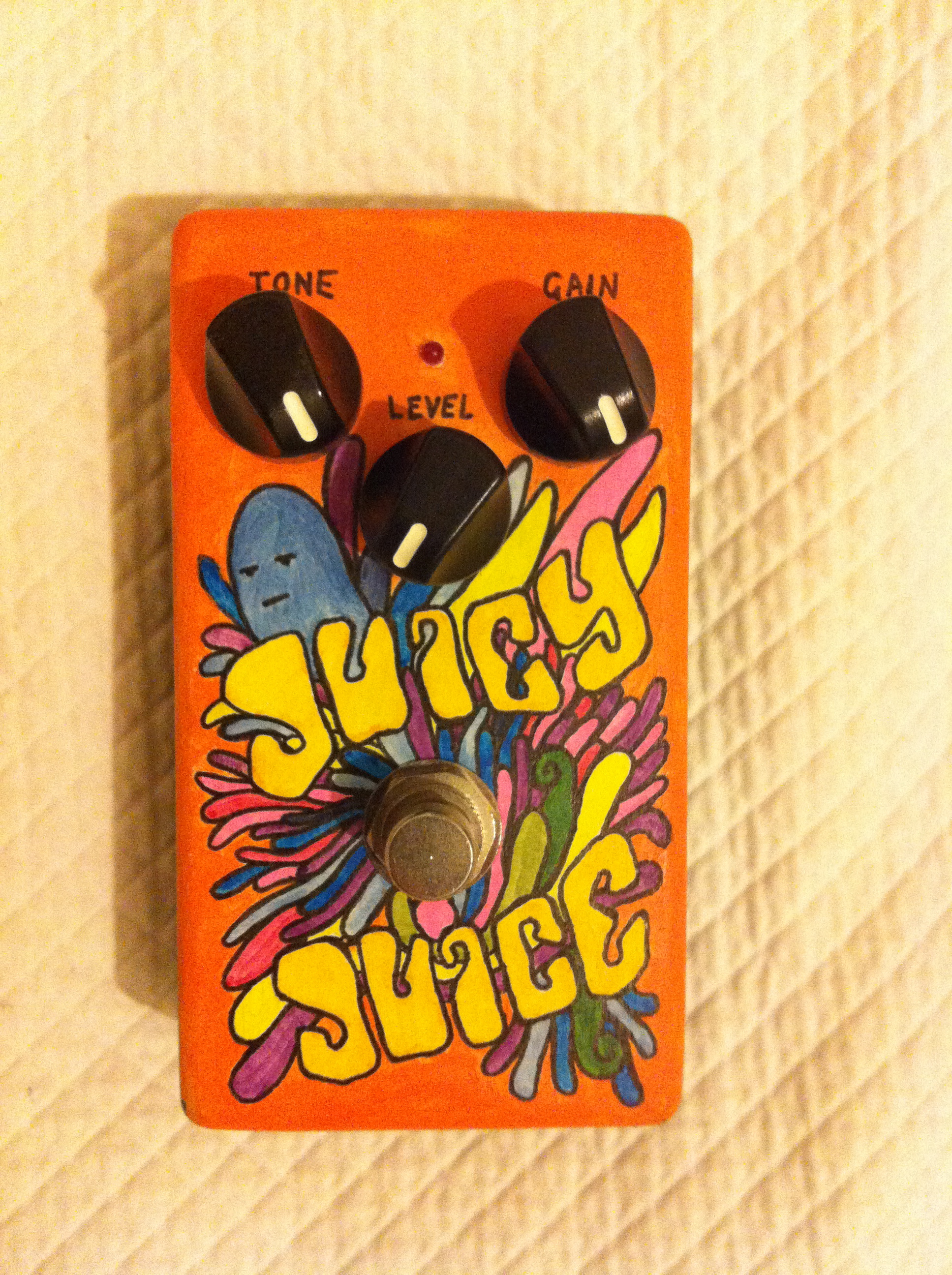

oh yeah, here's a photo of that old pedal I repainted back in '09 :)
crappy no-name distortion pedal that I repainted!
