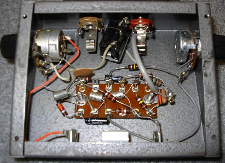

here is an eyelet/P to P combo from the '60s
and a very neat eyelet layout.
MM

metalmariachi wrote:and a very neat eyelet layout.
MM
Thats one of the most beautful things ive ever seen
