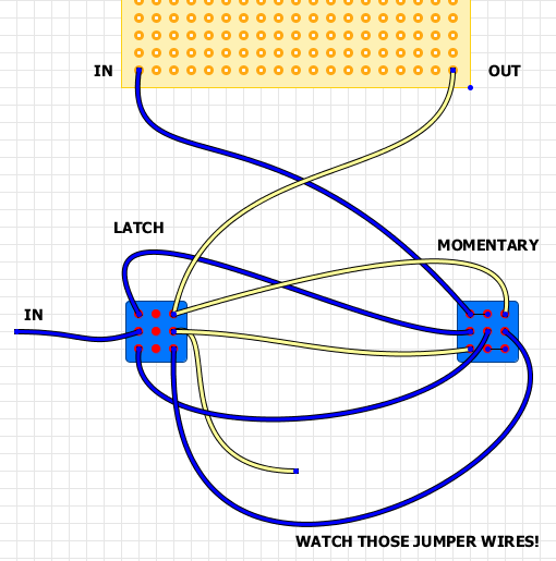

Re: Switching Question
I consider this to be a partial failure but I'm not giving up yet. the only bug is that the LATCH EFFECT ON + MOMENTARY BYPASS = board output connected still connected to output jack. not a big deal since there is a floating input on the board in. as long as its not high gain or prone to picking up RF, the board output should be silent.
notice I left a row open for the LED. if I use all 3 poles on the latching, I can do it better. but you would need to use a 4PDT latching to use an LED.
I need to draw that up. I'll be back
i dunno i might not be following right but i dont see how that could work.
consider these 2 scenarios. Assume in the first for each switch the center lug of each column is connecting to the top lug of each column.
follow the red squiggly you see it gets to the input of the effect, and that the green squiggly gets to the out. So lets assume this is effect on and momentary would cause the effect to turn off.
now the second case, assume the latch connects the center lugs to the bottom lugs. this should be the effect is OFF but the momentary turns it ON. However follow the red and green again you see that the effect is receiving the input signal AND that the output of the effect is going to the output of the switching scheme.
is the interpretation correct?
if so regardless of what the momentary achieves, the latching setup is not correct.
you can do it with a spdt latching and adpdt momentary with the same caveat you mentioned this had, which is in some states, the output of the effect is tied to the output but there is nothing connected to the effects input so presumably it may be acceptable. moving to dpdt latching as far as i can imagine will not improve the situation.
edit: not to say i know for sure there is no way to do it with the switches mentioned above, i just dont follow how this is it. to me for true bypass you will needa 4pdt for momentary and dpdt for latching.
ok I see it now. it is wrong. I have done similar things in passive attentuators where its ok to short the in>out>volumepot on the same junction. thanks for pointing that out. I'll keep working on the 4PDT/3PDT version. It might just be easier to use nand and relays like you said.
