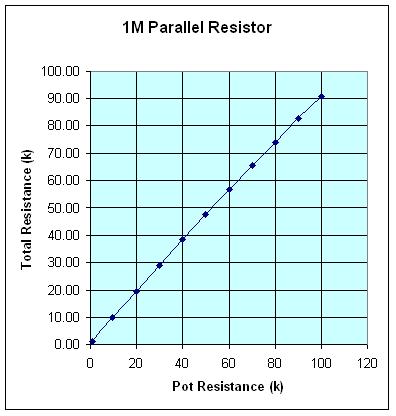

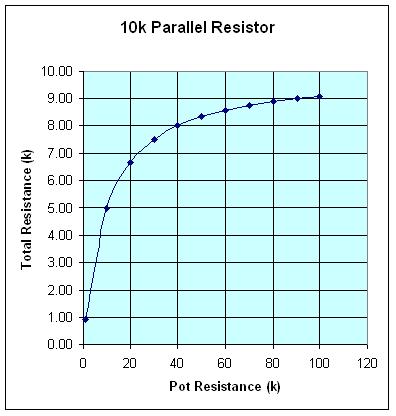

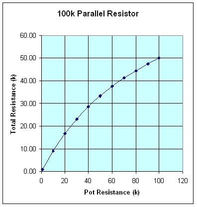

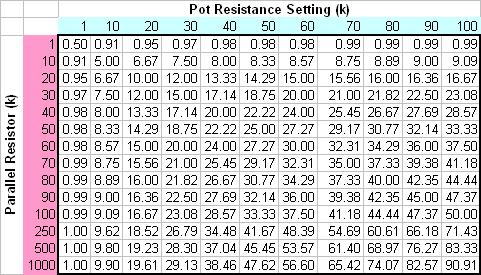

morange
Posts: 1389
Joined: Thu Oct 22, 2009 3:50 pm
Location: Bellingham, WA
Re: Changing Pot values
Post by morange »
tuffteef wrote:
McSpunckle wrote:
Scruffie wrote:Yup... along with a slight alteration in taper.
Or huge, depending on the values.
It's a good way of testing if you need a different value, though!
explain
i need scenarios :group:
In the chart, the non-colorful numbers are the total resistance (k), when the pink and the blue are in parallel.
The graphs show a few examples.
McSpunckle
Posts: 3848
Location: Nashville, TN
Post by McSpunckle »
Woah! Graph overload!
If you look at the graph with the 10K parallel resistor, you'll notice how steep the curve is as you change pot value. That would also translate to the taper of the pot, so that as you turn the pot down, it won't do much, then do everything all at once, basically.
It still WORKS, just has a really awful taper.
